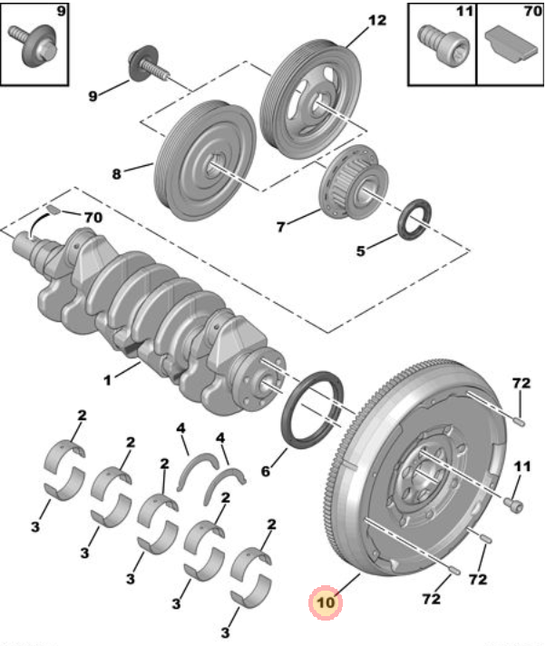

Flywheel
LuK 415 0396 10
That's the same flywheel as in the "Repset DMF" - look at the part number. It's not "unique", it's that they will supply it seperately.
As the garage has suggested a flywheel is required, the Repset DMF is the most suitable option of the three. If you DO need a slave cylinder, which isn't likely, they're a cheap and external part.
As for "I doubt it does for that price." - literally seconds on eBay https://www.ebay.co.uk/itm/175648121846 and that's a typical price.
The non-DMF kit is only about £90. It's labour that's the killer on this job, and frankly £600 is really cheap. I suspect some of the labour is hidden in markup on the parts. I've actually done this job with my own fair hands, I know what a swine it is.
As above, very few garages will fit customer-supplied parts. In your situation, I would email schaffler directly to confirm which kit is correct, then go back to the garage and get them to quote based on that kit. But it's certainly not a £1500 item.

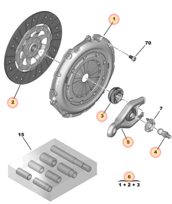

I've only just got round to your post. Thanks for your Forum donation. Any future parts requests, please post them up here:Official Parts Thread
Here are the official part numbers for your vehicle. You can use these to search for cheaper aftermarket alternatives, but these are the original options as fitted from factory:
Clutch
You have choice of components or a clutch kit.
(1) Clutch, part: 2004AN, £225.94
(2) Clutch Plate, part: 2055CL, £185.30
(3) Clutch Release Bearing, part: 1611266780, £46.76
(4) Declutch Fork Ball Joint, part: 212050, £6.76
(5) Declutch Fork, part: 211766, £62.86
Clutch Kits Includes (1) + (2) + (3)
(6) Pro Clutch Kit Valeo, part: 2052L2, £462.26

Clutch
E Clutch Valeo, part: 1636267680, £128.62
Standard Exchange Clutch Kit Valeo, part: 2051T7, £251.16
Flywheel / Flywheel with Clutch Option
(10) OEM, Clutch Kit with Dual Mass Flywheel, part: 2052X4, £462.26
Dual Mass Flywheel, part: 0532P7, £509.40
Standard Exchange DMF, part: 1613938580, £577.57
E Clutch PSA, part: 1680364780, £224.59
Flywheel Screw, part: 203708, £2.10
It's taught me that on the online sites, part numbers from LuK, Valeo, etc, tend to point to several OEMs, and vice versa, making it pretty complicated.
I also found that the database used by my local factor used the registration plate and almost had me buying a part that might well not have fit because of car construction date, which I only picked up on onlinecarparts.
You'd think it would be sorted out better, really, but perhaps there are good reasons why it's not.
In the end, I got a LuK match for (6) above, pro clutch kit valeo, and a valeo match for the DMF, 0539P7 above.
Crossing my fingers that I didn't mess up.
