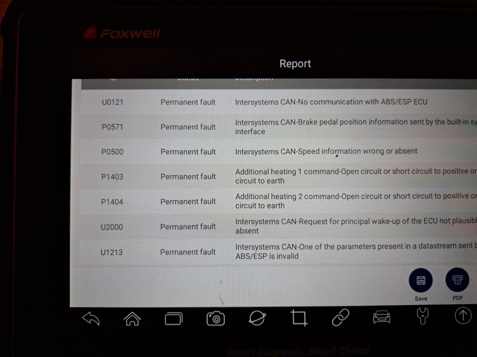

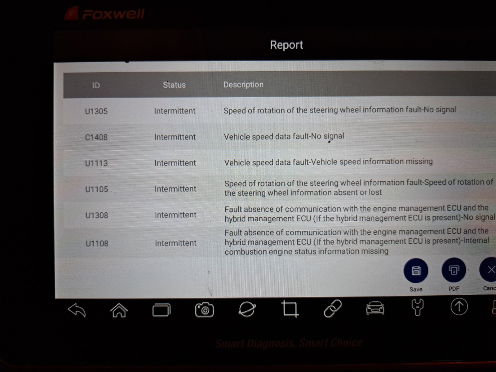

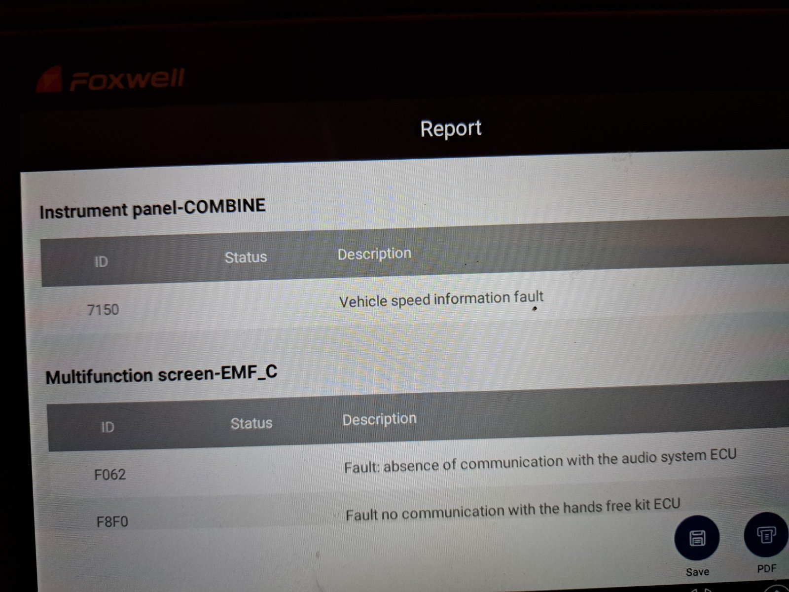

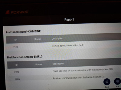

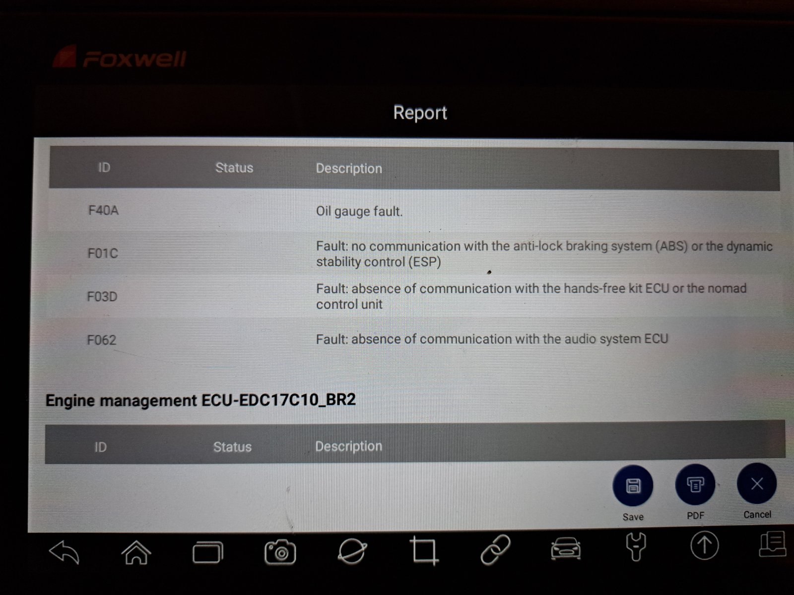

I dont thinkt that the diagnostic tool is the issu. I have a foxwell i70 pro. Unless these car are very hard to connect with. If the diagnostics were the problem it wouldt give me faultcodes for can comunication problems?
The part numbers could be a problem with the new part. Is there any way to test the part or to messure out whats wrong?
Fault codes attached

Looking at the new info - just about all these faults (excluding the obvious Radio and MFD / Heating issues) can be related to the ESP ECU. They are all interdependent on this ECU working for the other features and systems to operate. As I mentioned one possibility is that you have an incorrect unit or incorrectly configured unit on the vehicle.
The next question has to be were you getting the same or different codes on the old ESP ECU before you changed it over?

The radio and haeting codes are my fault. Relay for the fan was unplugged and the radii has been changed for aftermarket one.
