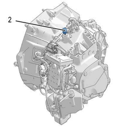

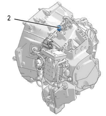

Am I right in thinking battery and tray need be removed for refill gearbox or Is there another way
- x 6955
Re: C4 1.6 hdi semi automatic
Yes, you may need to remove the battery and the tray. It's gravity fed through the vent hole here:
