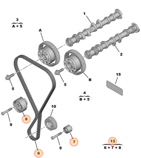

I can only provide you with the parts diagrams and parts numbers Constantin. We don't provide technical documents for assembly / repair unless we have them individually, and I don't have them for this engine, sorry.
(13) Distribution Motor Kit, part: 1654516080, £213.84
There's a 2 part video here that may help:
