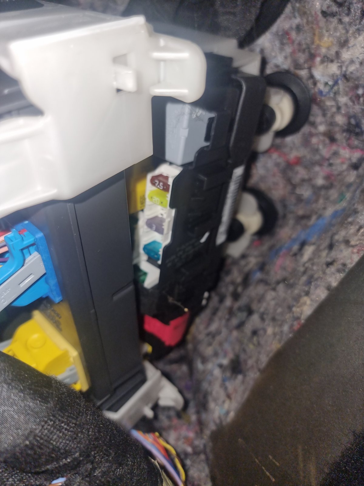

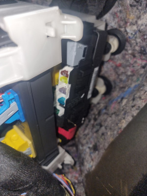

Middle centre console 12v cigarette fuse location
Just reviving this old thread to help anyone who was also stumped by the location of the middle/ centre console 12 cigarette fuse location - it's behind the first fuse board you see (after taking apart the glovebox). You have to arch your head right under to see it. It's the blue 15a fuse you see in my photo.
