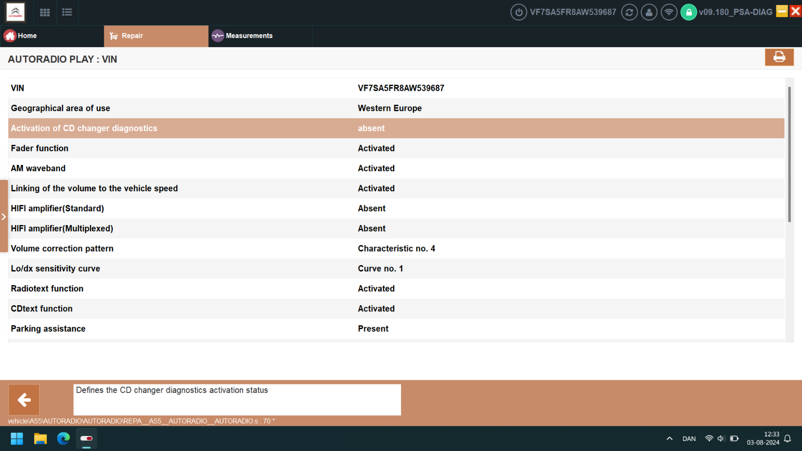

This is how it is now, with volume control working and okay sound.
This picture is from a 2011 citroen ds3 with hifi system

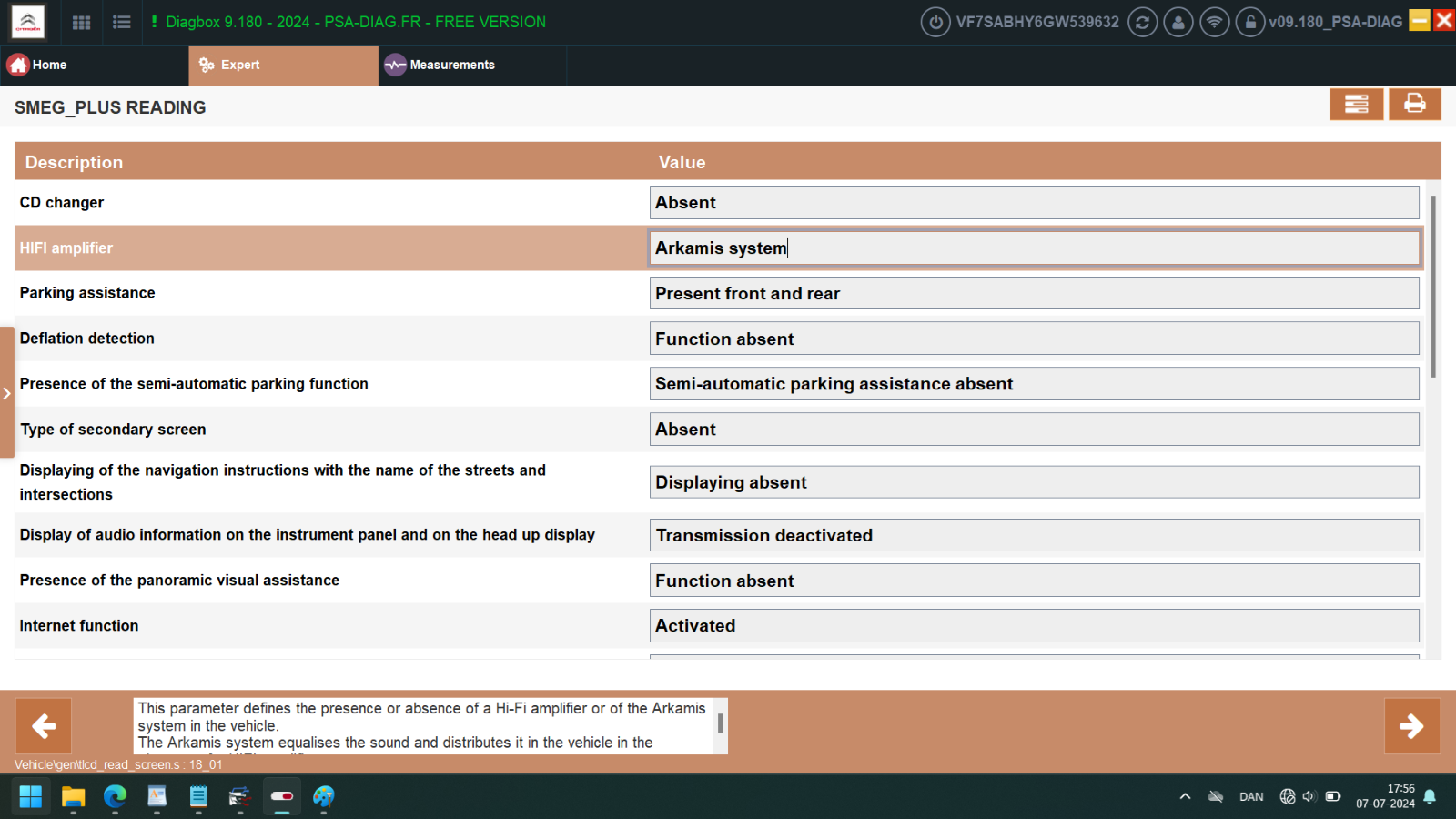

I've tried to telecode the radio so it should have the HiFi amplifier both the multiplexed and without. When it's multiplexed there is no volume control at all. It's just a fixed volume.
If i telecode it to the HiFi amp without multiplex, the sound is very very low, and you need to turn volume to max, to hear it right. Also the Park-assist is almost muted, same with the phone calls.

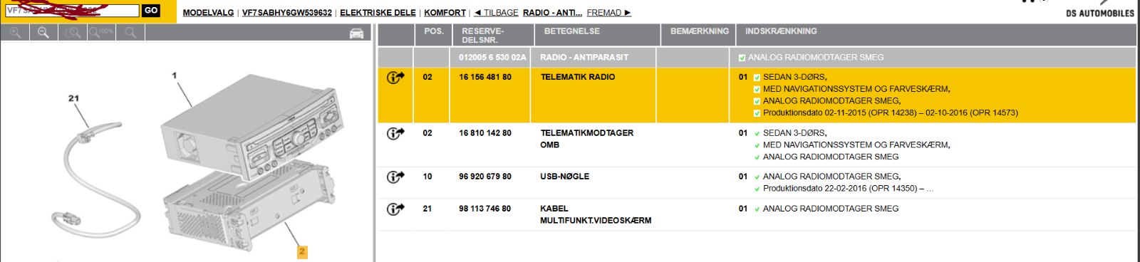

According to Partslink24 (the only parts catalaouge i've got for citroen) i have this one.
My vin: VF7**************[VIN obfuscated, can be read by forum staff] if that helps Part number 16 156 481 80
TELEMATIK RADIO
01 SEDAN 3-DOORS,
WITH NAVIGATIONSSYSTEM AND COLORSCREEN,
ANALOG RADIORECIVER SMEG,
Productionsdate 02-11-2015 (OPR 14238) ? 02-10-2016 (OPR 14573) [Rough translate from danish]

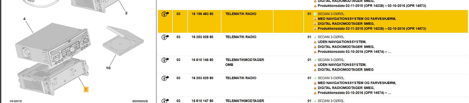

But when i manually take a ds without vin, i can find this one. This is a digital radio instead, but that's the only difference i can find, since my radio according to partslink has all the checks for equipment except digital radio.
Part number 16 156 483 80
TELEMATIK RADIO
01 SEDAN 3-DOORS,
WITH NAVIGATIONSSYSTEM AND COLOR SCREEN
DIGITAL RADIORECIVER SMEG,
Produktionsdato 02-11-2015 (OPR 14238) ? 02-10-2016 (OPR 14573) [Also rough translate from Danish]

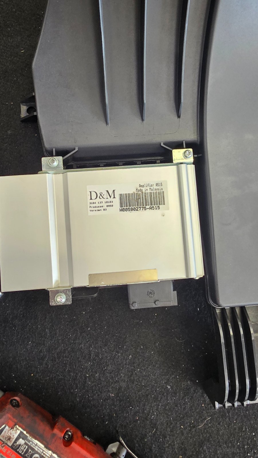

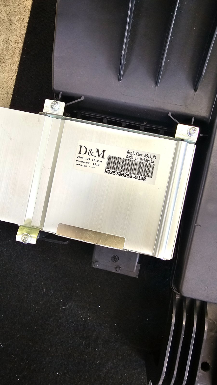

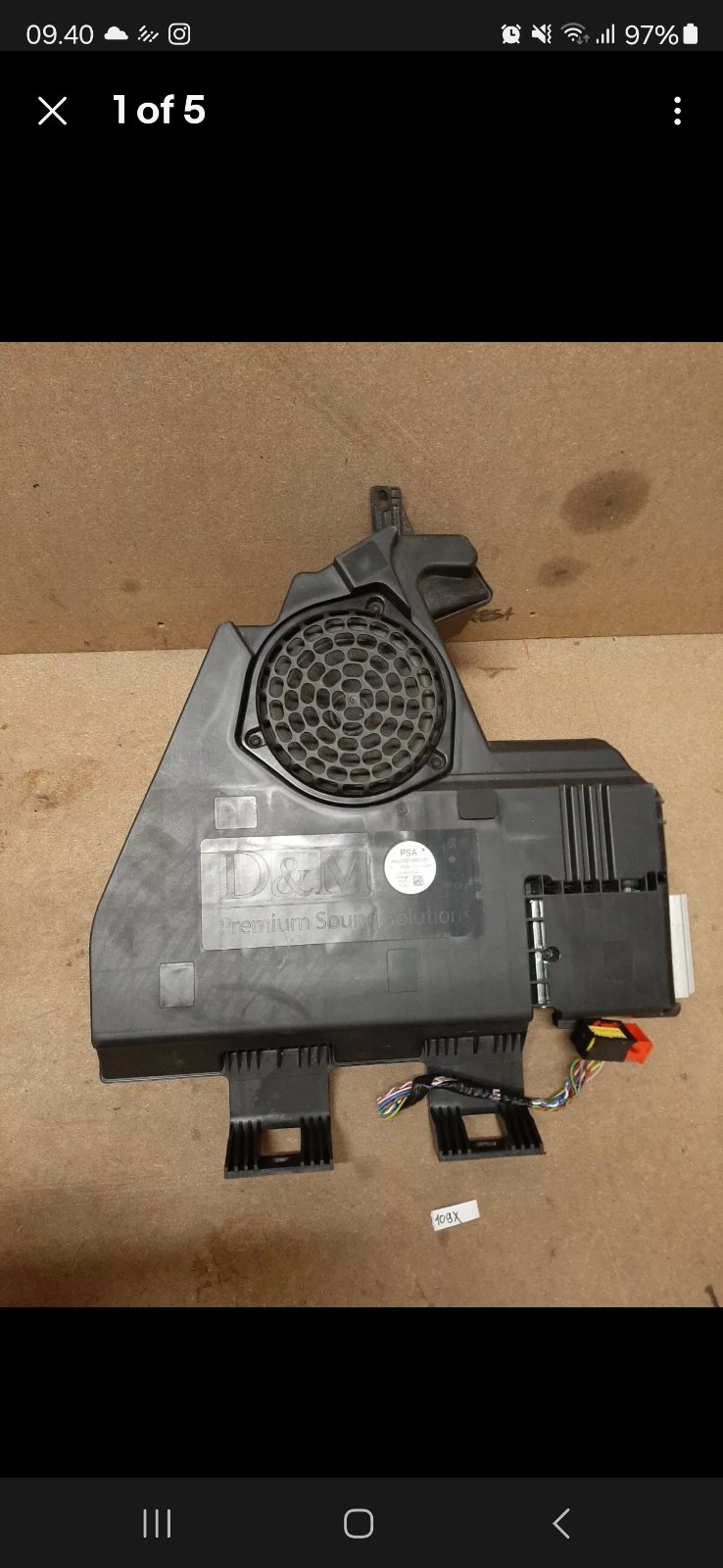

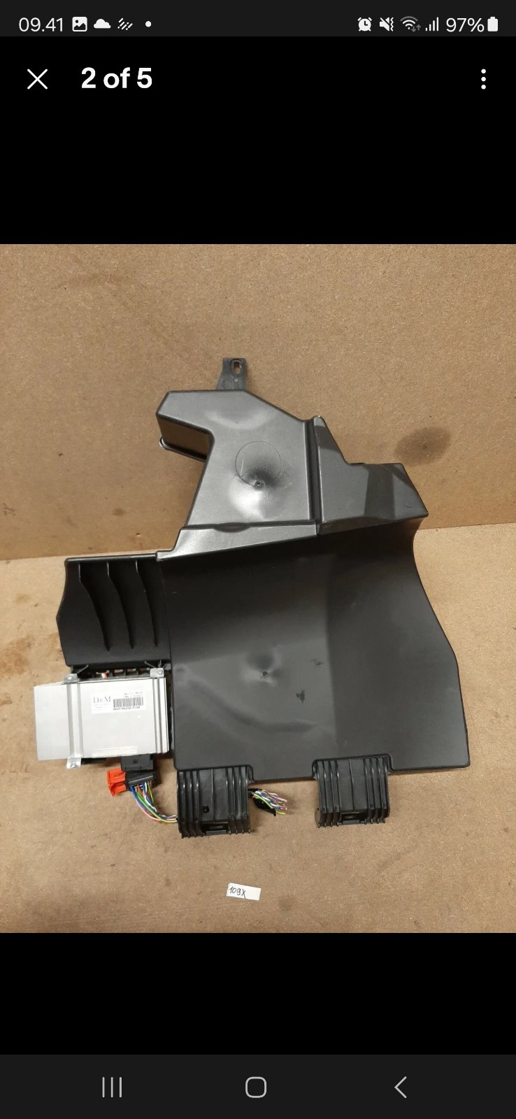

For the sub/amp setup i installed the subwoofer with a amp. Pictures below. For the configuration i tried the official Diagbox bought a official token valid for my car for 7 days at the time. From the official PSA-servicebox website, so no offline version, and the newest Diagbox at the time. With the ability to telecode from psa servers.

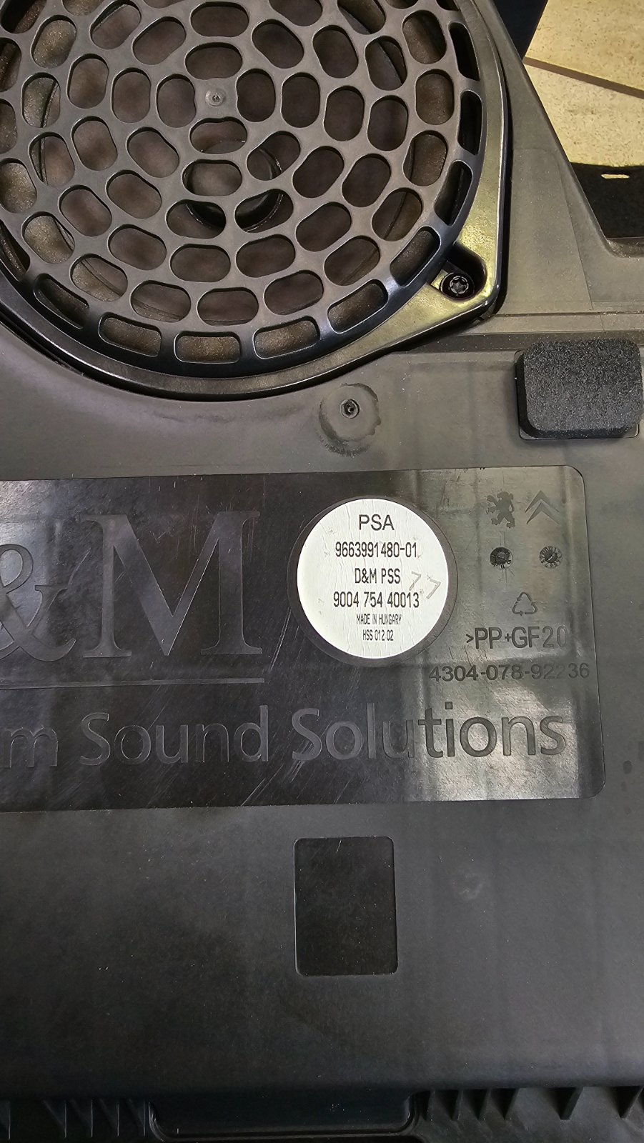

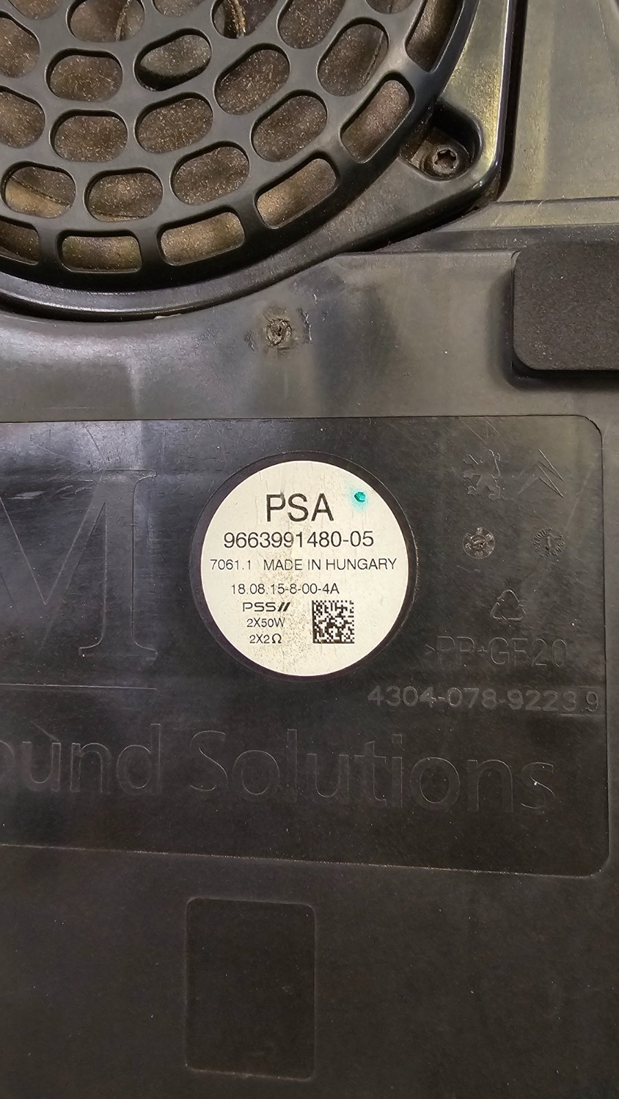

On that last photo, what is the part number on the label? The image is too small to see anything on it.

This is my subwoofer and amp
This is 2011 ds3 with original HiFi system
