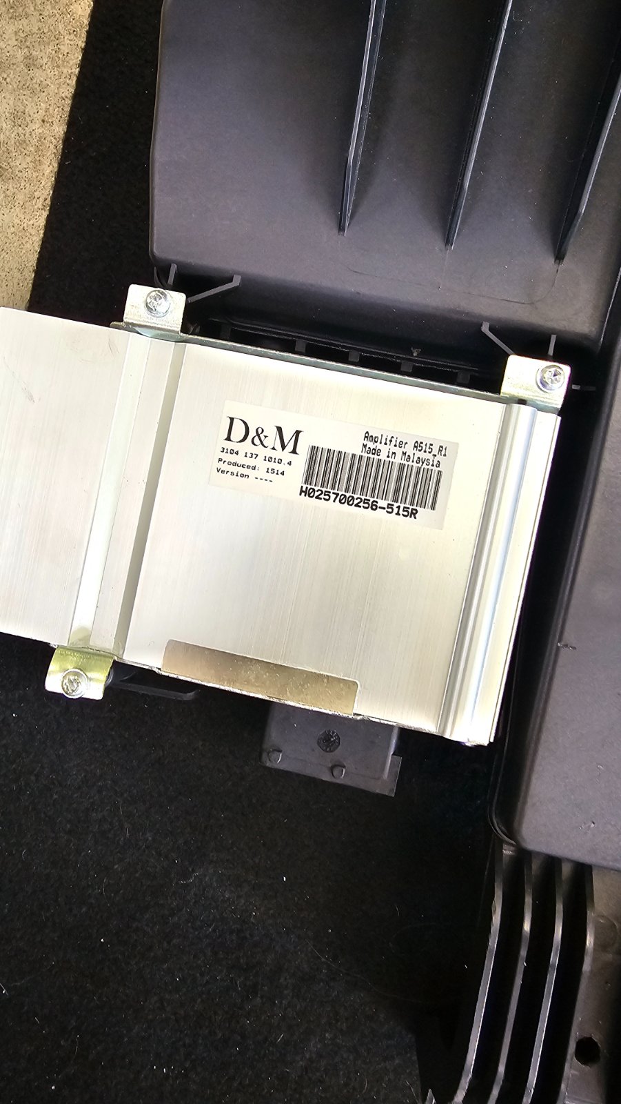

For the sub/amp setup i installed the subwoofer with a amp. Pictures below.

On that last photo, what is the part number on the label? The image is too small to see anything on it.

This is my subwoofer and amp
