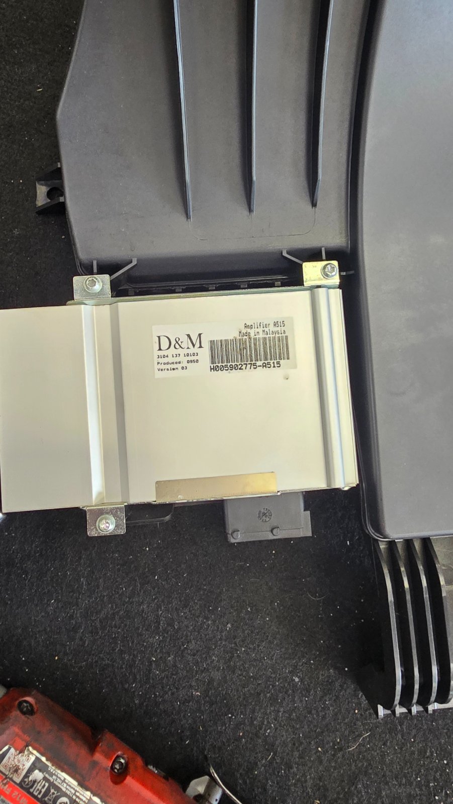

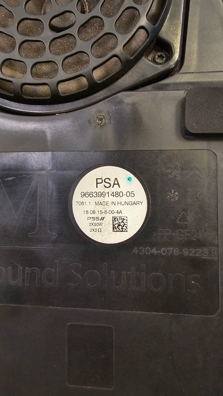

For the sub/amp setup i installed the subwoofer with a amp. Pictures below.

On that last photo, what is the part number on the label? The image is too small to see anything on it.

I went out to the workshop and tried to fiddle around with the other car that has sub installed. I tried switching them around from car to car.
this is what i found out.
First i tried to install my subwoofer in the car that works, there my subwoofer played loud.
Then i tried the subwoofer from the working car in my own car, where it played low like my own subwoofer did.
- So the subwoofer i got is in fully working order.
This is my subwoofer and amp
