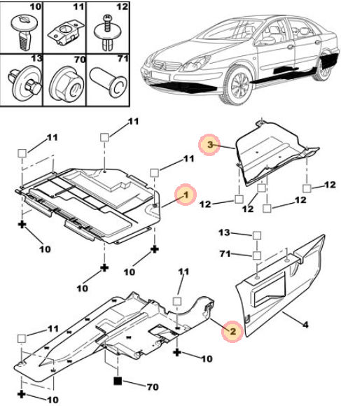

I have a Citroen C5 Estate 2.0 HDi 2002 VIN: VF7**************[VIN obfuscated, can be read by forum staff] that has missing/damaged plastic covering underneath the engine and underneath the front bumper that I would like to fix. The local car wrecker has two Citroen C5 Type 2 (model year unknown) and would like to know if the covering from these would fit my Type 1 model. If someone has pictures/diagrams/documentation of these to compare would be most appreciated.

Thanks for your Forum Donation Martyn. From the part numbers below, you can at least search the internet for copy parts or original second-hand parts.
(Ignore the image of the Saloon, these are correct parts for the estate version).
Note: NFP = No Longer Available From Citroen
(1) Soundproofing Under Engine and Gearbox, part: 7013N9 (NFP)
Autodoc have an equivalent here (https://www.autodoc.co.uk/car-parts/oem/7013n9)
(2) Air Deflector Under Engine:
Left, part: 7013T3 (NFP)
Right, part: 7013T2, £167.57
(3) Air Deflector Under Engine (Left), part: 7013K4 (NFP).
If you need any clip part numbers, please let me know.

Re: Information on plastic covering underneath engine and bumper
I looked at this for my Mk2.....I found a Mk1 and it did not fit at the front
