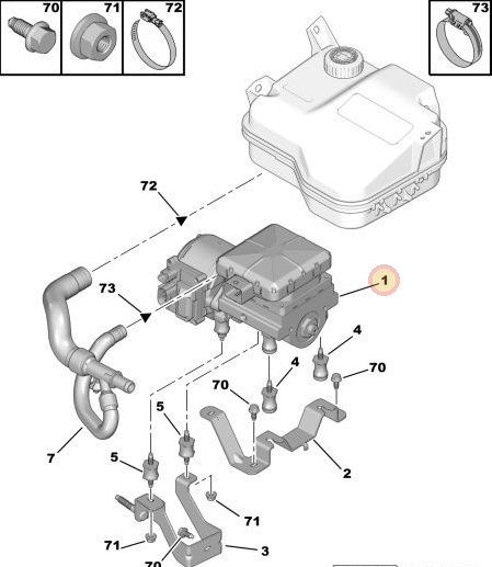

Re: C5 x7 2.7 suspension pump
Chris_reade10 wrote: 11 Apr 2024, 11:53 Good afternoon all
Trying to source a suspension pump and bhi unit. I've been told the 2.7 engine has a different pump to the smaller engines. Could anybody confirm that for me, and ideally confirm the part number I need as the label has gone off the original. Vin VF7**************[VIN obfuscated, can be read by forum staff].
I'd be most grateful for any help
Chris, details below:
These parts are specifically for your C5 X7 2.7
(1) Brand New Original Suspension Hydraulic Block (requires configuration), part: 5277K5, £1961.84
Brand New pre-configured Suspension Hydraulic Block, part: 5277K6 (No Longer Available)
Standard Exchange Block (Requires configuration), part: 1680916580, £1258.46
Prices as of today direct from Citroen.
At least you have the part numbers on which to search for now if looking for after-market.
