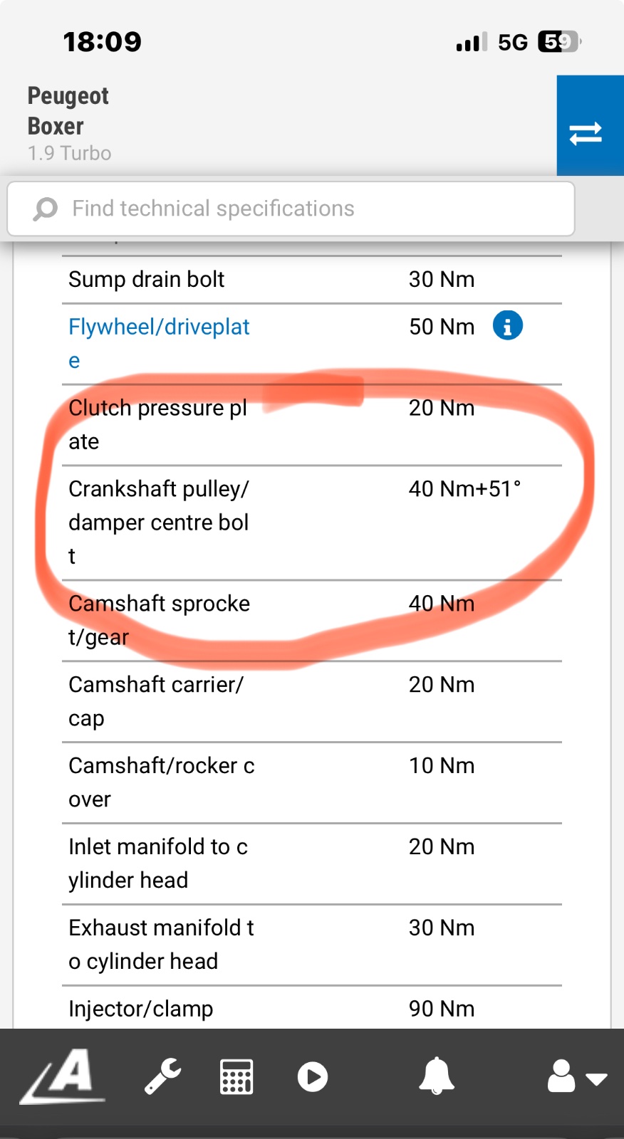

I’m new to here , but I’m hoping someone can help me who has knowledge or advice. Ok here goes, I’ve just purchased a Peugeot Boxer 1.9td 2001 camper with the XUD 9UTF engine. I’ve just changed the timing belt and finding it difficult to find torque settings. I’ve done as per a manual I’ve purchased the bottom crankshaft bolt to 30lbft followed by 60 degree and loctite on the thread. For some reason a couple of days later the bolt has worked loose, so I’m hoping someone might have the correct settings.

Could the torque figure have been 30 Nm not lbft?

According to Autodata it should be 40 Nm + 51 degrees

Haynes says 40 Nm+60 degrees
