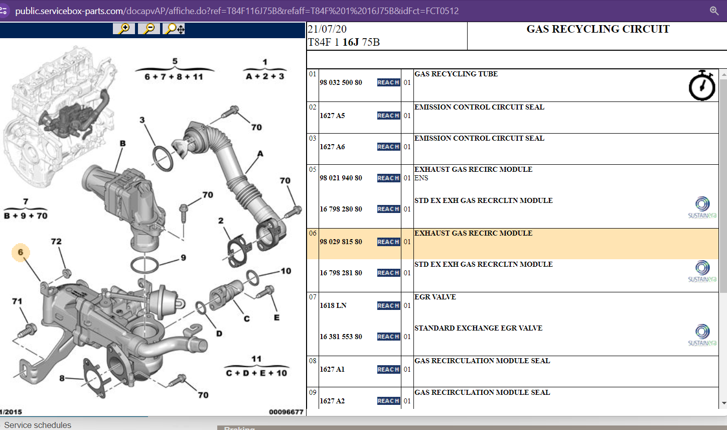

Please may I have a part number for the EGR valve? I'm pretty sure that has not been done.

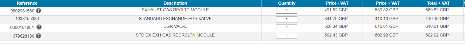

Re: Peugeot 3008 Crossover 1.6HDi Allure - Is it a worthwhile car?
Pretty complicated!
And the prices are
And the prices are

Indeed. I can't say I've ever seen anything like it. Part 7 is what I thought was the valve and it clearly is. I am trying to get my head around how you would diagnose whether it is a problem with the valve or the module.
If you need both, you'd throw the car away...
Maybe this is why she needed rid and sold it to my mate. I dunno.
