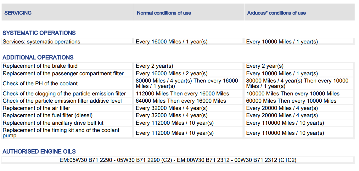

Could I please have the following?
Peugeot 3008 in profile
Sight of 60000 miles service schedule,
Part numbers:-
Oil Filter
Air Filter
any other serviceable item on the service schedule. (pollen filter/cabin filter)
Timing belt kit or whatever (ie water pump or auxiliary tensionsers) needs doing for the 60k service.
And confirmation of what engine is in it be that DV6C or DV6UC please?
x 6948
DV6C 115 (Euro 5) Engine.
On top of routine servicing for 64k miles, 15 year old vehicle:
  • Passenger compartment Filter
  • Check of the PH of the Coolant
  • Check of Particle Filter Additive Level
  • Replacement of Air Filter
  • Replacement of Diesel Fuel Filter.
Specific Operations / Mileage / Time

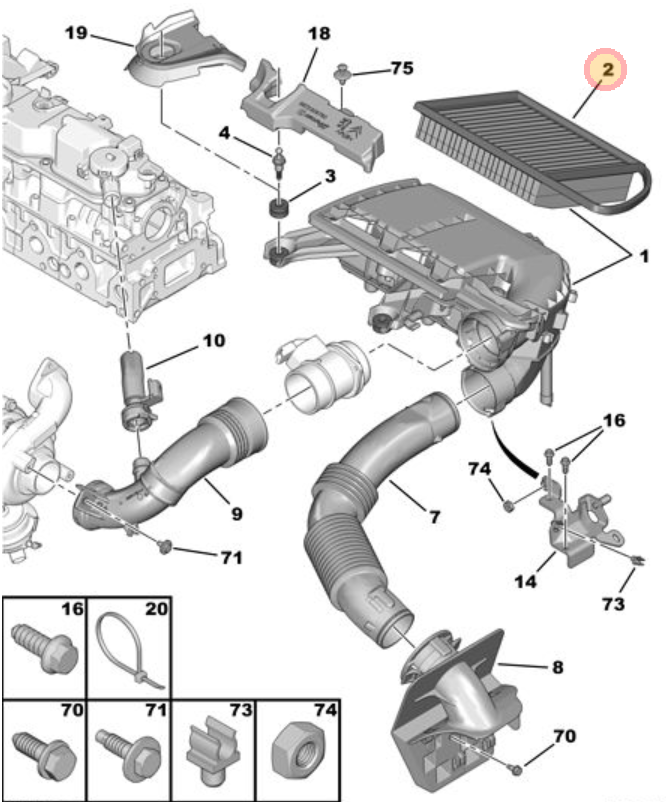

Air Filter
(2) Air Filter:
Genuine PSA, part: 1444TV, £35.74
PSA Alternative, part: 16 1891580, £14.14

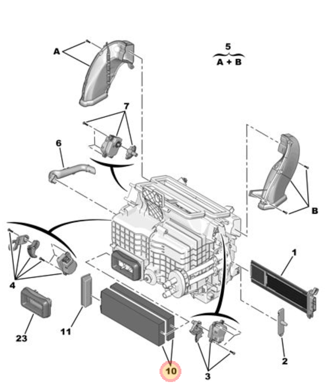

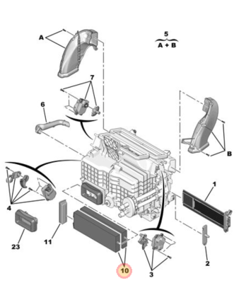

Pollen Filters:
(10) PSA Carbon (Particle & Gas), part: 6447XG, £50.96
PSA Alternative Carbon (Particle & Gas), part: 1609998880, £27.79
PSA High Performance Anti Allergenic Carbon, part: 9821501880, £63.62

Many thanks, Marc. It is on 62500 miles and is coming up to its 11th anniversary. I should have done the timing belt when she got it in Feb but times has run away with me.
Interesting how the servicing schedule mentions diesel particulate additive as, as far as I am aware, it doesn't have any such system. It's not got AdBlue but that may be different to a diesel particulate additive?
Will do cooling system drain and refill as part of the timing belt + pump. She wants to keep on top of it.
x 6948
Yes, it has a DPF and Eolys additive reservoir system. It needs little attention and will generally warn you when it needs a top up - but they tend to check in service at the appropriate intervals, which often requires the tank physically emptying to measure the quantity.
Without wanting to go off-topic and very briefly:
Adblue is the additive for the SCR (Selective Catalytic Reduction) system to treat NOx in the Cat.
Eolys Additive is for assisted regeneration for the DPF which treats particulate matter.
Different systems to do different jobs, most Diesels post 2016 have both systems. Yours only has the DPF, not the SCR system.

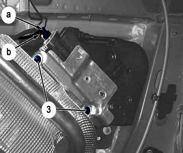

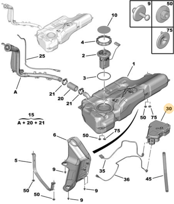

Can you post image of where the EOLYS tank is please so I know for future reference?
x 6948
Here:- shown at (30), usually hidden behind a heat shield on the left of the fuel tank.
Here:

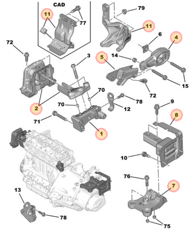

Hi Marc im needing Engine mount numbers & locations for my c3 picasso .
VF7**************[VIN obfuscated, can be read by forum staff] many thanks.
:-D
x 6948
(1) Engine Mounting Bracket (Right), part: 1807GH, £99.74
(2) Engine Mounting Bracket, part: 1807GW, £149.63
(4) Anti-Torque Link, part: 1806A6, £75.10
(5) Engine Support Yoke, part: 9800650980, £85.33
(7) Engine Mounting Bracket, part: 1813J8, £99.74
(8) Engine Mounting Bracket (left), part: 9806658980, £83.00
(11) Power Train Impact Absorber, part: 1813F6, £51.14

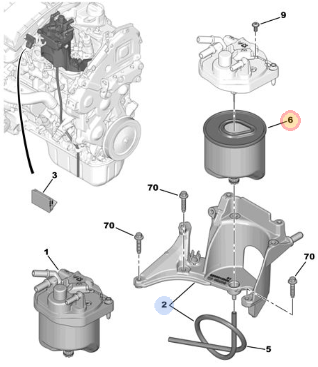

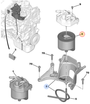

Fuel Filter

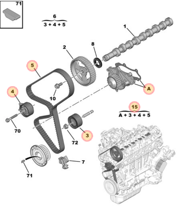

Timing Belt Kit (Belt, Tensioners and Coolant Pump)

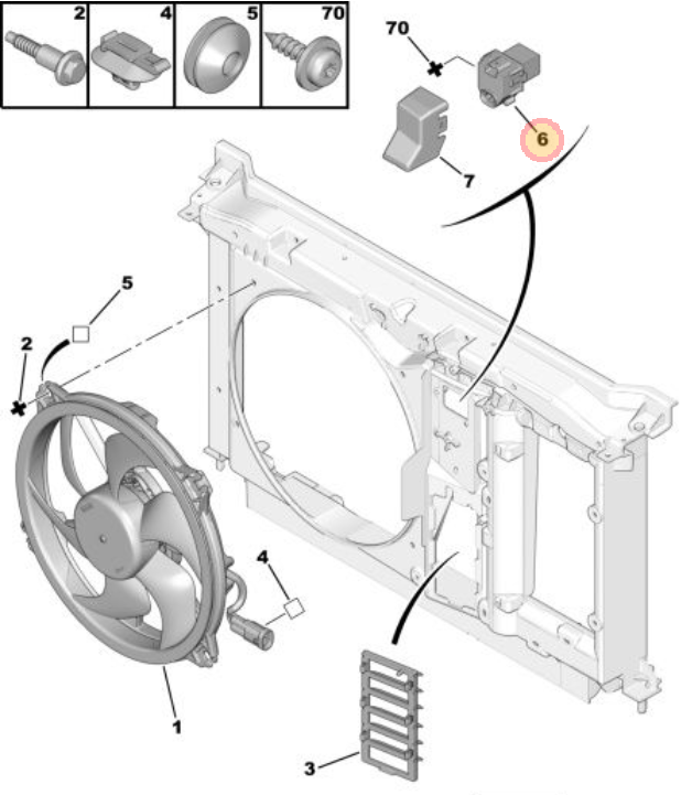

Fan resistor module (as have P0493 code - not yet checked the resistance but it's likely to be that).
(15) PSA Timing Kit & Coolant Pump, part: 1684448280, £252.07
Cheaper PSA Kit, part: 1684891780, £158.71
Contitech Kit, part: 1689586380, £173.82
(6) PSA Fuel Filter Cartridge, part: 9809721080, £60.97
Cheaper Option, part: 1611659480, £36.05
(6) Cooling Fan Electronic Control, part: 9830143880, £104.87

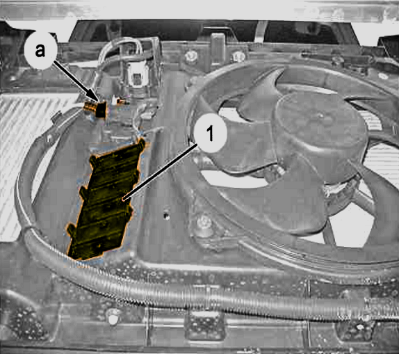

So sorry, Marc. Thought I had finished. Where do I request work sheets for changing cam belt and fan resistor module please? Is it here or just on a separate specific post? You'd think I'd know the answer to this having been on the forum for so long... SORRY!
I've stood and looked under the bonnet for the fan module for 5-10 minutes and couldn't find it. It's probably tucked behind what I think is the intercooler.

The Fan control is best accessed from below the vehicle on a hoist, by removing the under-engine protection to get to it - above 'a' below:
