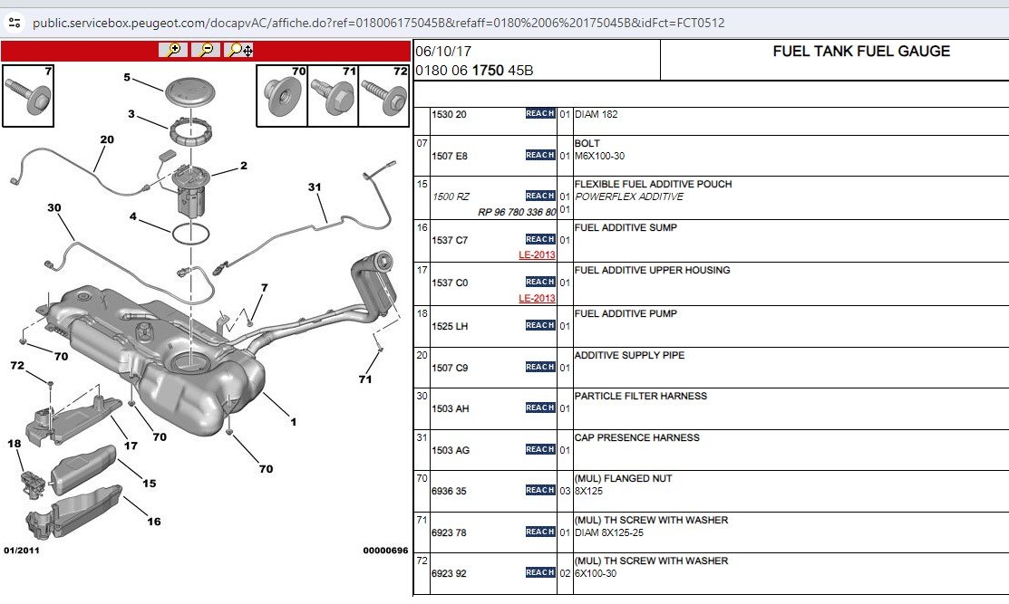

There's a mistake in the VIN, it's F7S (sierra) not F75 (five) - anyway, that's by the by!
Here's the tank detail.
I think it's part 20, Additive supply pipe - item 30 is listed as a harness, so is probably the wiring to the additive pump.
Listed at £66.67 however, and it may well be a drop the tank job to change it....
