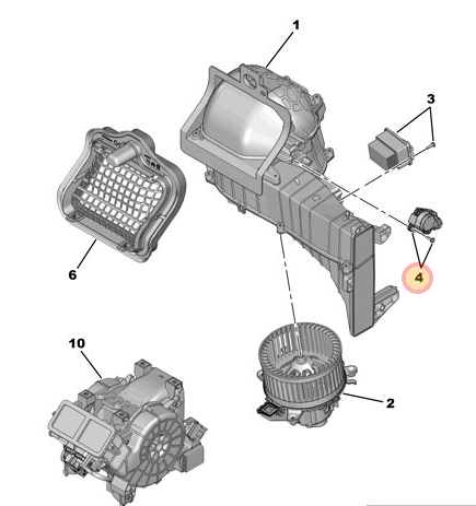

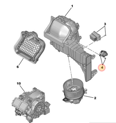

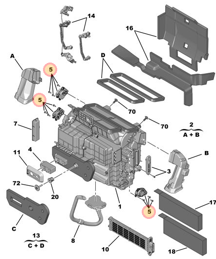

Ok, so this is the diagram of the blower motor, which also shows the flap for the air intake - and I assume that the reduction gear (4) is the one that opens or closes the flap for external or recycled air.

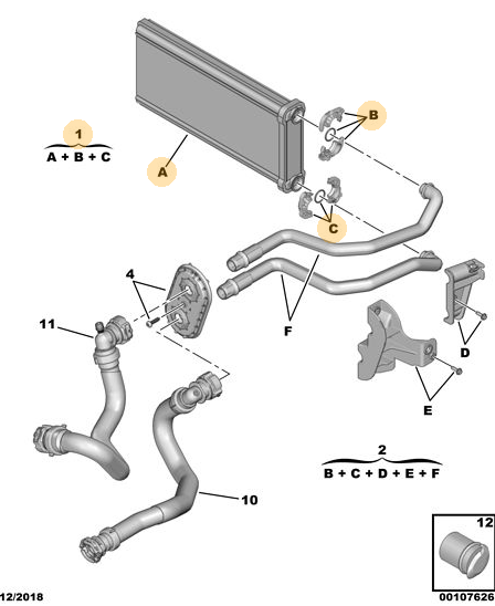

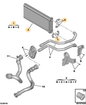

This is the heater Matrix:

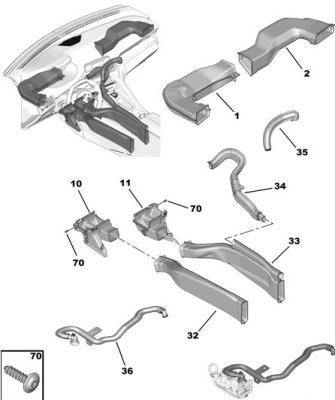

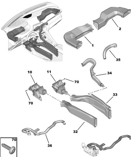

Ducting:
Heater Components
I can't advise as to access, but there should be some checks you can do to see if the external / Internal air flap is working by using Diagbox that will allow the testing of the reduction motors.
Ducting:
Heater Components

The flap motors at (5) above are for the Air Temperature distribution and the Air Flow Distribution.
It will be a matter of determining whether one of the motors is faulty - or if it is heard to be operating, it may be the gearing has worn. Of course it may be none of the motors, but simply that there is a blockage in the heater pipes that tends to cause heating on one side and not the other.
