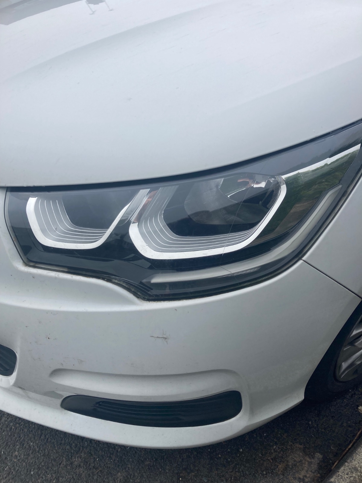

I have a 2016 Citroen C4 1.6 HDIBlue, and the front left indicator has stopped working. Citroen are quoting over £600 for a new assembly. To essentially change a bulb! Please Can anyone help?.

I imagine it's an LED unit and there are 'no user serviceable parts inside'!! Getting one from a breaker seems like the best plan.

There are 3 possibilities of headlamp fitted: Discharge Bulb Type, Halogen Bulb Type or LED + Halogen Type.
- Posts: 9346
- x 1942
Re: Citroen C4 indicator/headlight cluster issue?!
Are any of those linked with a specific type of indicator bulb?
- x 6957
Yes, from what I can see...
Discharge Bulb Headlamp Type has a PY21W Orange Indicator Bulb
Halogen Bulb Headlamp Type has a H21W Bulb for indicator function
LED + Halogen Headlamp Type has neither - so assume this is the type the OP has, but VIN would confirm. This being the case, the complete Headlamp is showing a tad under £800 at today's prices.

Yeah it’s a LED + Halogen Headlamp
