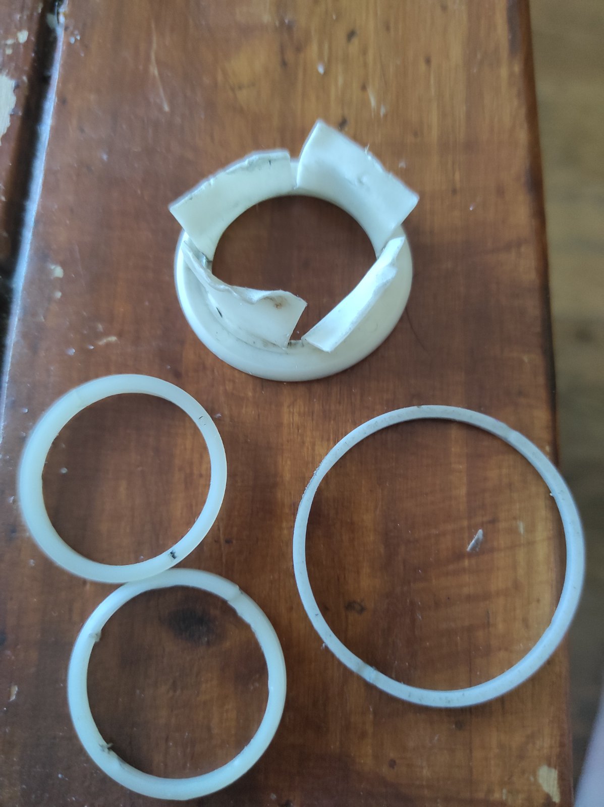

Hi all I need a hand sourcing seals. Does anyone know where I would get PTFE square profile rings.

It's for the rack Kenny piston seal and rack bar bushes

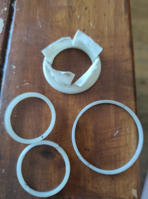

Re: Steering rack PTFE seals help needed
Its for the rack Stu, piston seal and rack bar bushes. The only thing I can find is a chap that will make them out of acetal which is a very similar coefficient of friction,Young's modulus, chemical and pressure resistance all very similar. Temperature resistance is lower but if it reaches critical temperature the hoses will probably fail first anyway. The large ring is the piston ring PTFE section.

I know they are I just use them interchangeably. I might have a manufacturer in the UK a bit steep at £100 but he is making them to order . But he is using acetal
