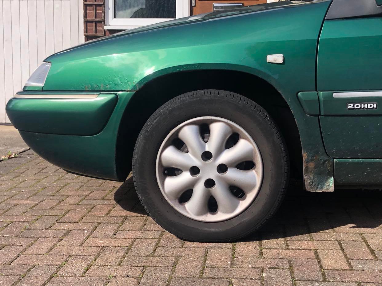

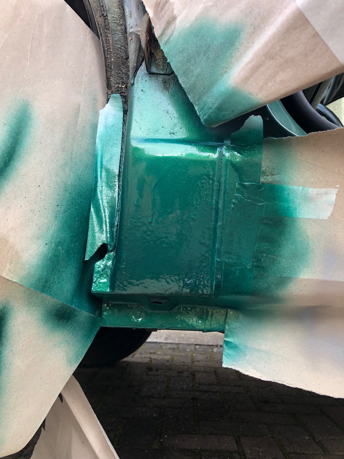

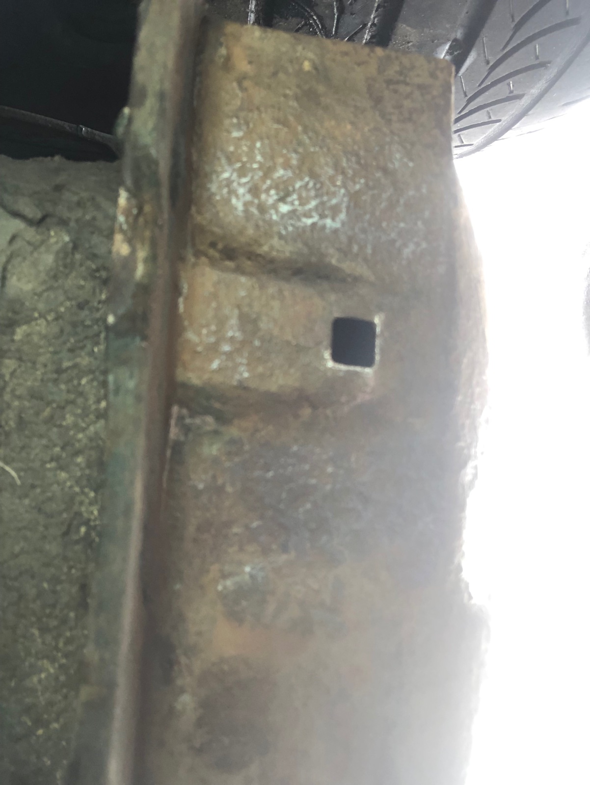

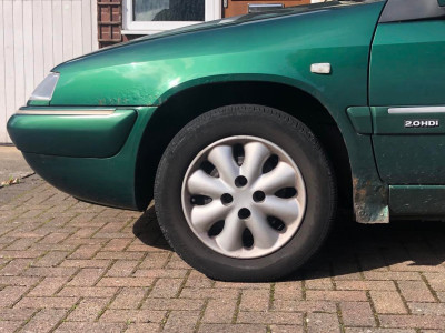

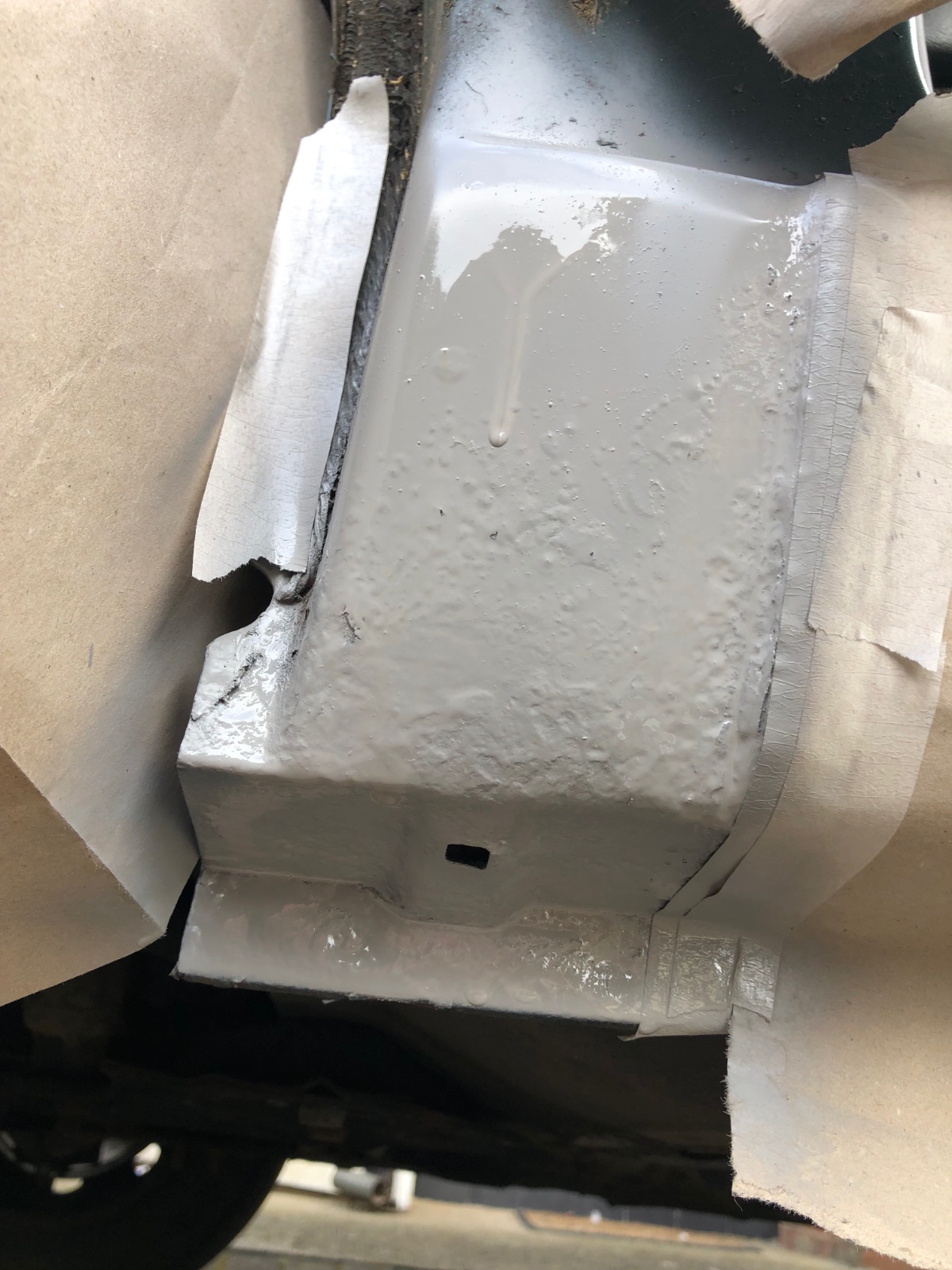

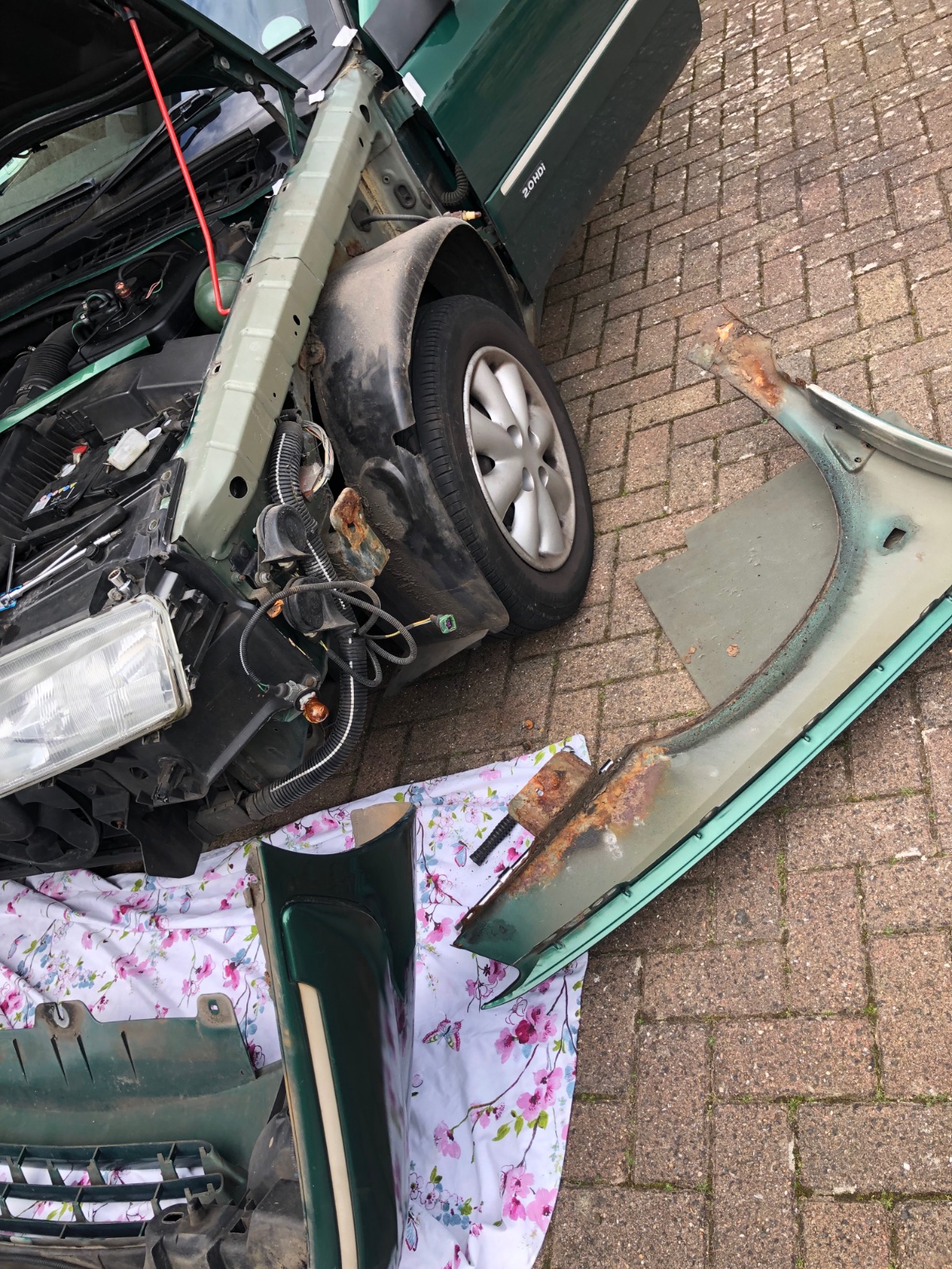

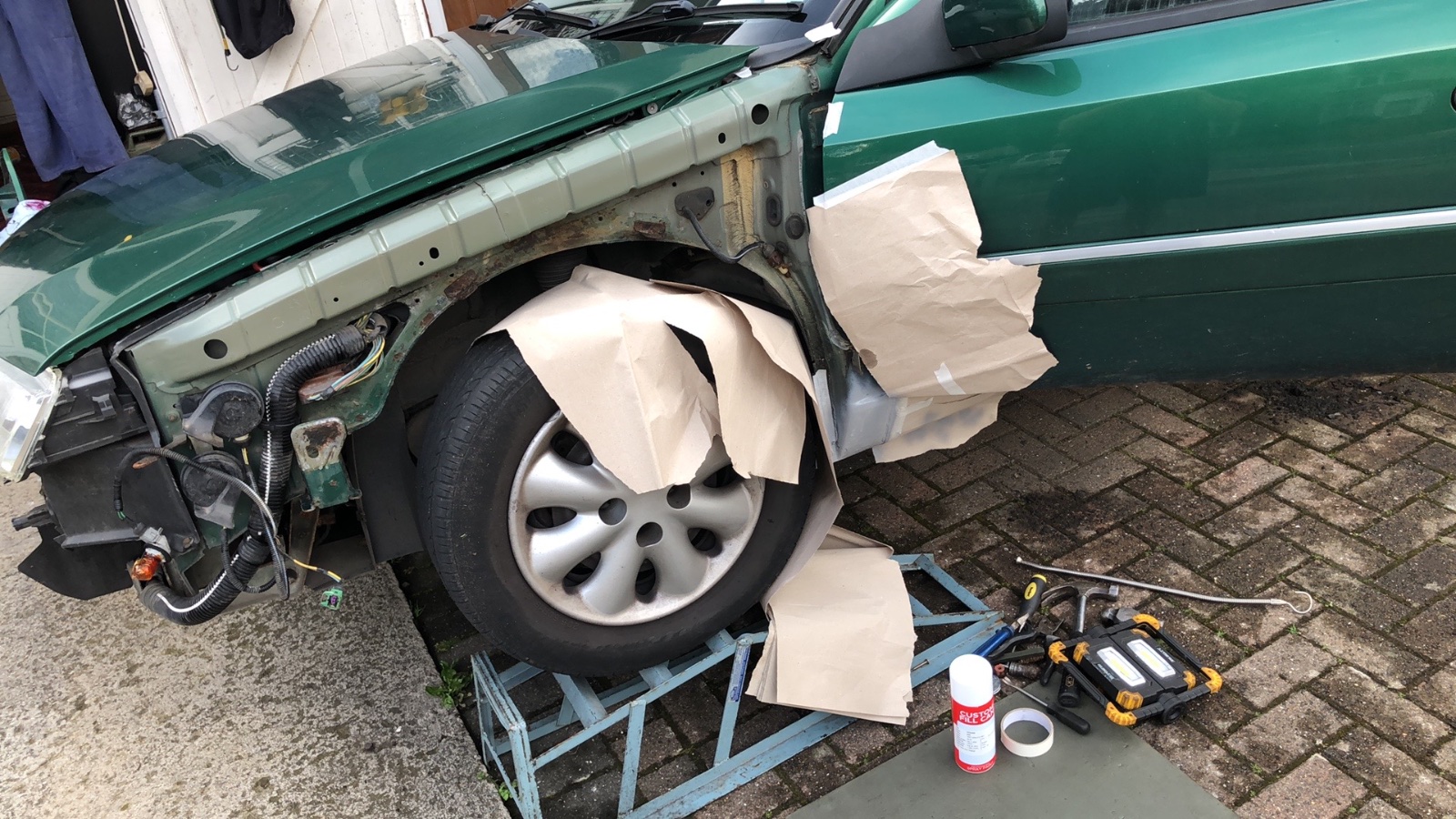

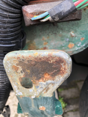

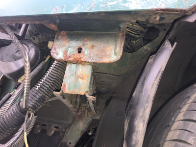

Xantia Wing replaced Before and After (During available)

Re: Xantia Wing replaced Before and After (During available) )

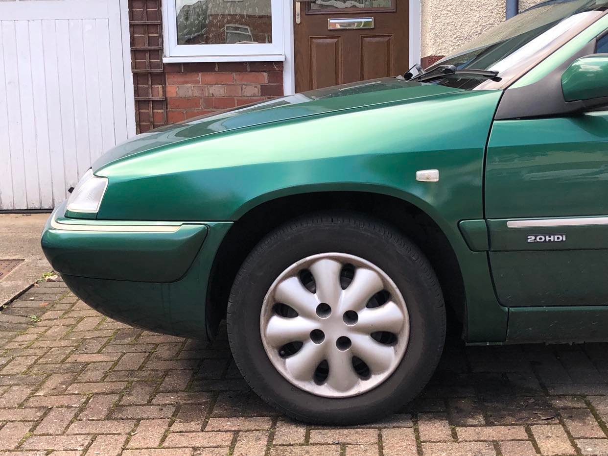

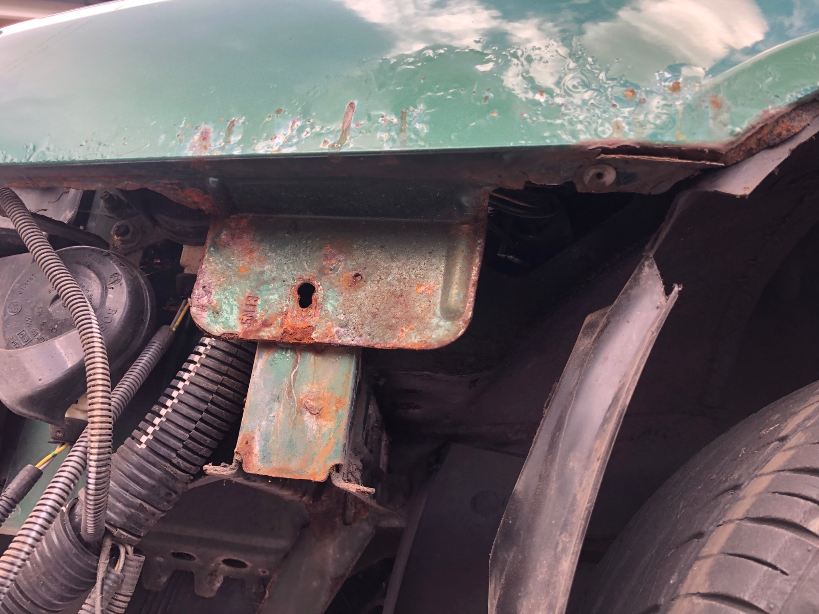

Excellent job, that looks a better match than the original!!
- Posts: 11823
- Joined: 28 Mar 2013, 21:05
- x 2000
Ohhh.....they look good. I just knew they would come in handy one day......that was about 7 years they hung in the garage roof !
- Posts: 55047
- x 8378
Superb
Delighted it's all come good! It's certainly looking good
During …..
Gary
Gary
- Posts: 55047
- x 8378
Excellent! That'll be good for another 20 years

The replacement wing was also off the car whilst I sprayed it
I would have liked a better shine and I'm hoping a mild cutting paste will help in a couple of weeks ....
