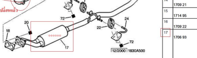

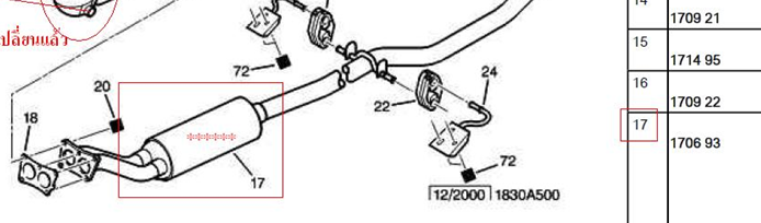

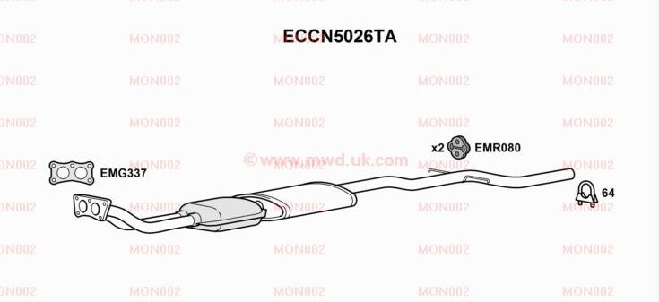

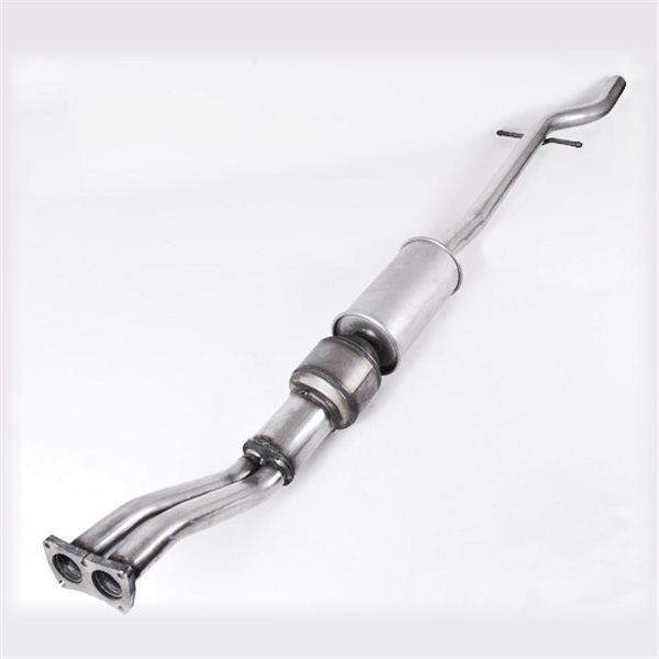

The two I have found appear to be in two parts rather than just the one that my car has on it. Attached are the relevant pics.
I was wondering if anyone knew if either would be a suitable replacement? As they are for the same engine, I would have thought so, although, I don’t know if a pre 2005 model had four catalytic convertors compared to the three on my car? Also, I don’t know if they changed the floor pan design for the cut out to accommodate it?

You already have the correct part numbers, however 1726RP has been replaced with a superseded part.
The original 170693 part is no longer available from Citroen, but there is a cheaper alternative available from the dealer.
