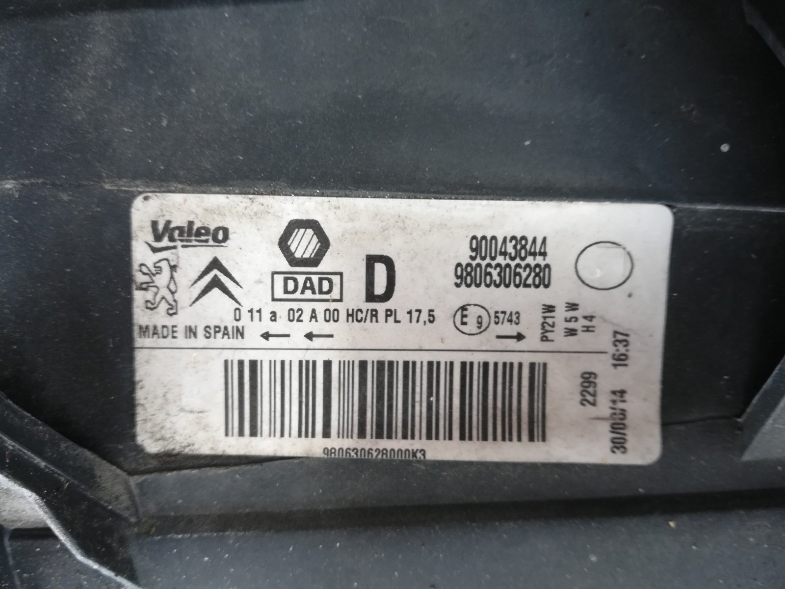

Have a look at the label, see if you can see who makes them FOR Citroen/DS.
I've just been buying headlights for the Berlingo, in that case they are made by Valeo, see the bunch of logos on the label...
From a bit of shopping around, I've now ordered one made by Valeo for £130 inc delivery instead of the £369 that Citroen would charge.
This is a 65% saving for a brand new identical original light, not a lookalike or pattern part. The only difference is that it won't have a Peugeot/Citroen logo on the box or label.
You may be able to do a similar process for yours.
There are other cheapo Taiwanese/Chinese/Whatever copy ones for around £100, but it's not worth the risk for the tiny additional saving, they could be LHD or just crap.
I'd avoid used, the Berlingo ones are crazing at 9 years old and will probably become cloudy in another few. I needed to replace one due to accident damage but decided to just replace both while I'm at it, as they're so cheap.

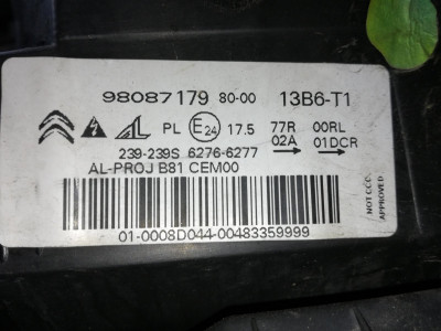

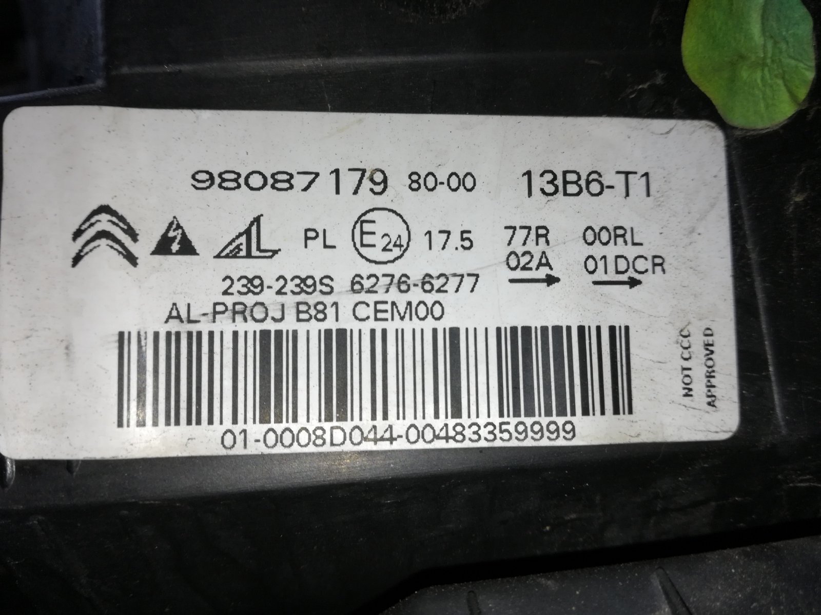

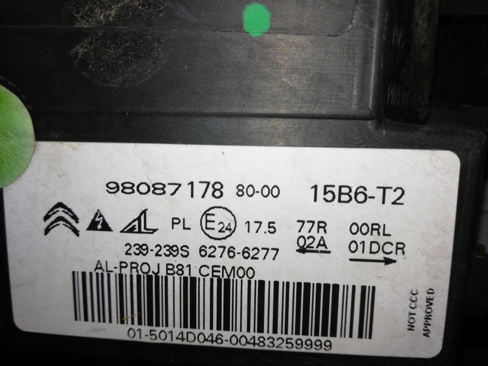

These are the lights on my 2016 DS-Brand DS5. This is the HID/LED one, the poshest version...
Left: Right: Someone will know who the manufacturer is from that logo (it's not Valeo), might be worth hunting them down and emailing them. You never know, they might be £20 without the Citroen markup!
CCC is China's safety accreditation, just googled it. They sold lots of DS5s in China, so it might be worth checking Chinese websites, e.g. AliExpress. I bought a used door handle on there.
