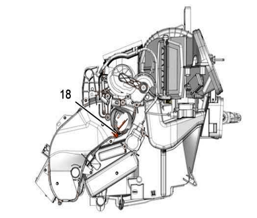

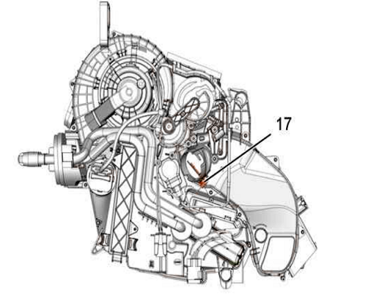

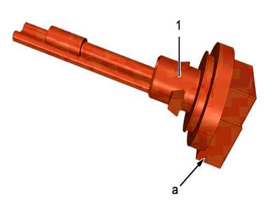

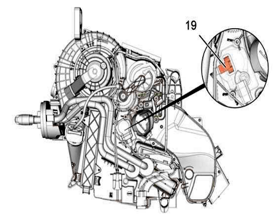

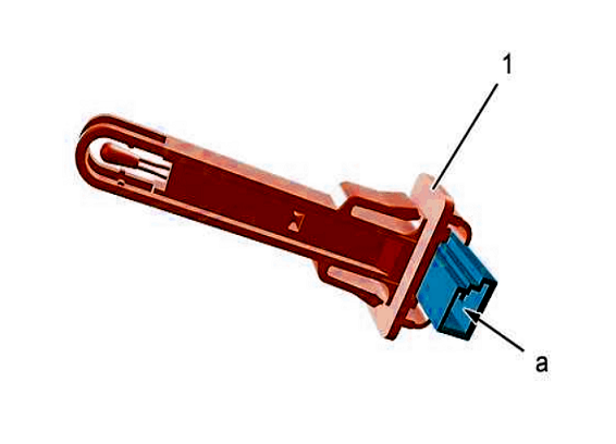

The only sensors on the system are a Blown Air Temperature Sensor on the left and right side of the unit and an Evaporator Temperature Sensor, along with an Air Quality Sensor.
So I suspect that you may have a faulty blow air sensor on one of the sides confirmed by your garage.
The blown air temperature sensor measures the temperature of the flow of air passing around the sensor from - 40 °C to + 100 °C.
The evaporator temperature sensor measures the temperature as close as possible to the evaporator.
After a stationary period, and after receiving the outside temperature, sunshine and blown air sensors information, a calculation estimates the passenger compartment temperature.
This is the Blown Air Temperature Sensor: This is the Blown Air Temperature Sensor (right): This is the Blown Air Temperature Sensor (left): Now I'm not saying this is the cause, but if your A/C specialist has diagnosed the temperature as being off the scale of one of these, then is stands to reason that this may be the cause of the system shutting off the A/C. Of course it could be the evaporator sensor, that again may be switching off the A/C if it thinks the system is too cold to prevent icing up.
Evaporator Sensor Evaporator Sensor Location

Is it just me or does that sensor look like there's a whole world of hurt involved in getting access to it?
somethingSome
- Posts: 17
- Joined: 11 Oct 2022, 21:29
- x 4
Re: Citroen C5 X7. Interior temperature hotter than the surface of the sun according to readings.
The evaporator box sits under the dash. If the whole box needs to come out it's a dash out job.Jay-Bruce wrote: 12 Jul 2023, 02:40 Is it just me or does that sensor look like there's a whole world of hurt involved in getting access to it?
Evaporator Sensor

There are 2 of these and they are the blown air temperature sensors. One on each side.

Right Side (18)
Left Side (17)
