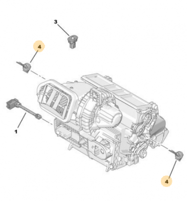

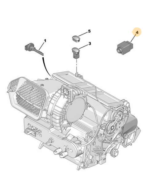

Re: C5 2, 2007 reg. interior temperature sensing fan
Ok, thanks for that Malcolm.
Here is the sensor, (4) in the diagram.
It is part number: 6445VC and is the Temperature / Hygrometry Sensor. It is currently priced at £83.82 from Citroen inc. VAT.
There is no specific guide on replacing this Malcolm, but I believe if you remove the glovebox, you should be able to get your hand in there for access.

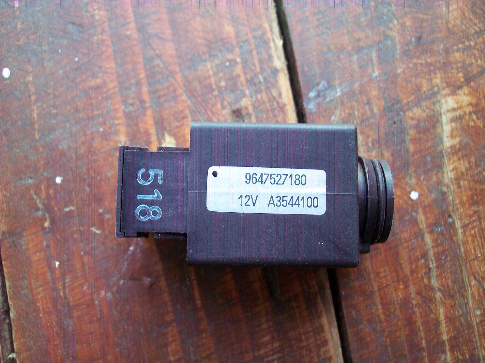

I have previously replaced this sensor on my 2007 C5. I noted on Lexia that the temperature sensor was reading correctly, but the humidity sensor had failed showing a reading in the 1000's of % humidity - clearly incorrect.
There is a fan in there (see youtube link below), I remember the fan failing on my Xantia VSX which meant that it never knew a correct temperature in the car. As the journey got longer the car thought it was hotter (as no 'fresh' air was blowing over the thermistor) which meant that after half an hour or so the car would blow cold air on all temperature settings apart from full hot - I presume full hot and full cold ignore the sensor reading.
Anyway back to the C5, I replaced the sensor with a new OE part, I do recall it being around £60-80, which fixed the humidity reading. I don't actually remember there being any notable difference with the way the auto climate control worked with a fully functional sensor, and within a year the humidity part of the sensor failed again back to that huge humidty percentage being output from it. To access it you do ahve to remove the glovebox which is basically a series of torx screws around the door opening, and one underneath the dash towards the centre of the car, pointing forwards, weirdly. If I recall the sensor twists out, but it has been a while since I touched that sensor.
So in conclusion - if the temperature part of the sensor works correctly on lexia, and it is dust free, I would recommend against replacing it.

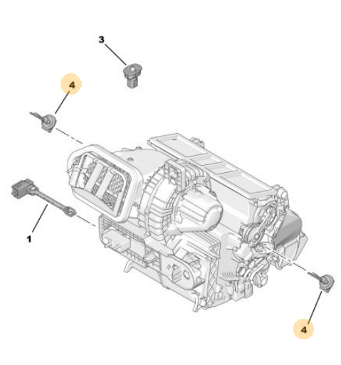

Up to build dates of 2nd March 2008 on a 407, this was the same sensor as fitted to the C5 MK II 2007. From 3rd March 2008 the heater system was replaced on the 407 and this sensor was no longer fitted. On the new 407 system, they had 2 completely different internal temp probes, so that's probably where you are getting the 2 from - but again only on the later systems.
Here are the sensors on the later heating system (item 4):
