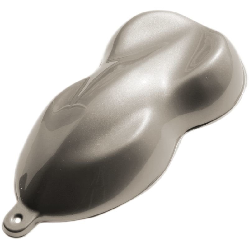

Cheers Marc, Yes, it's the door handles that are looking tatty, exactly as you described, a thin rubberized coating. Colour coding the door handles wouldn't work on our car as Noir Perla Nera (black) would look godawful against the Claudia cream. Earlier this year I redid the handles in a generic, pale champaigne gold, which looks like lamborghini yellow next to the other "gold" pieces. After reading your reply here, I googled HZW to see if I could get any pictures of it, and it turns out you and I have discussed this before:
I've got to say KCH Mantivore Beige is a good shout, I've been looking at that and a similar colour, KCY Golden white metallic:
I'm likely to push the button on a pair of custom mix rattle cans, one mantivore beige, one golden white...

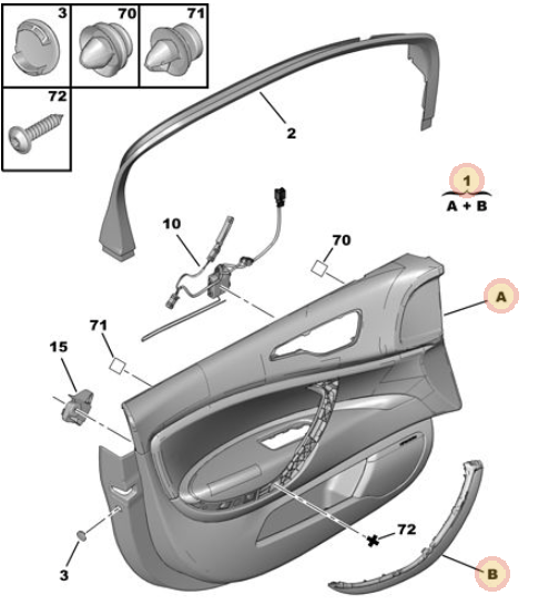

Which was when I asked you to see if the grab handle trim pieces were available.GiveMeABreak wrote: 03 Jan 2023, 17:36 If it's this one:
Part (1) which is the complete door trim pad....
Right: 9345E5 (CLAUDIA SPLIT LEATHER - L033- HZW- - MORNING GREY), £1064.05
Left: 9345 E6 (CLAUDIA SPLIT LEATHER - L033- HZW- - MORNING GREY), £652.88
Neither of the above are now available from Citroen![]()

My 2009 X7 has the black part leather, door grab handles - part 8 on Marc's diagram - are black plastic but with a slightly rubbery coating (rather than painted as described). It's just starting to chip away at the edges. Black shiny plastic underneath.DHallworth wrote: 24 May 2023, 14:19. The coating on the beige interiors is strange being that rubbery stuff whereas the black ones are painted with gloss black.
