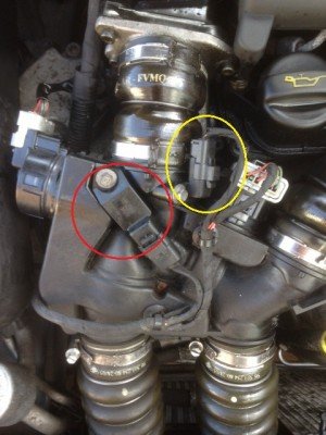

So should I check the vacuum storms, and which sensors should I check? I thought the Turbocharging pressure sensor was the MAP sensor. Can you help me with a picture of what these sensors look like

I knew that the MAP sensor is the one surrounded in red. Which as far as I know is supposed to be the Turbocharging pressure sensor

From what I can make out, the sensor circled red is the Inlet Air Pressure Sensor & the one circled in yellow is the Air Intake Temperature Sensor.

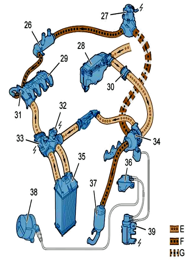

Here's a diagram of the system so you can check the circuit and see where the turbo control solenoid is etc.
Key:
"E": Air circuit
"F": Exhaust gas
"G": Duct crossing the engine block
ReferenceDesignation
(26)Exhaust gas recycling (EGR) heat exchanger
(27)Exhaust gas recycling (EGR) regulation electrovalve
(28)Air cleaner
(29)Air inlet manifold
(30)Air flow meter
(31)Inlet air pressure sensor (oversupply)
(32)Inlet air heater throttle (RAA)
(33)EGR butterfly
(34)Variable geometry turbocharger
(35)TURBOCHARGING AIR COOLER (RAS)
(36)Vacuum reservoir
(37)Catalytic converter / Particulate emission filter (pef)
(38)Vacuum pump
(39)Turbocharger control solenoid valve

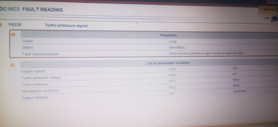

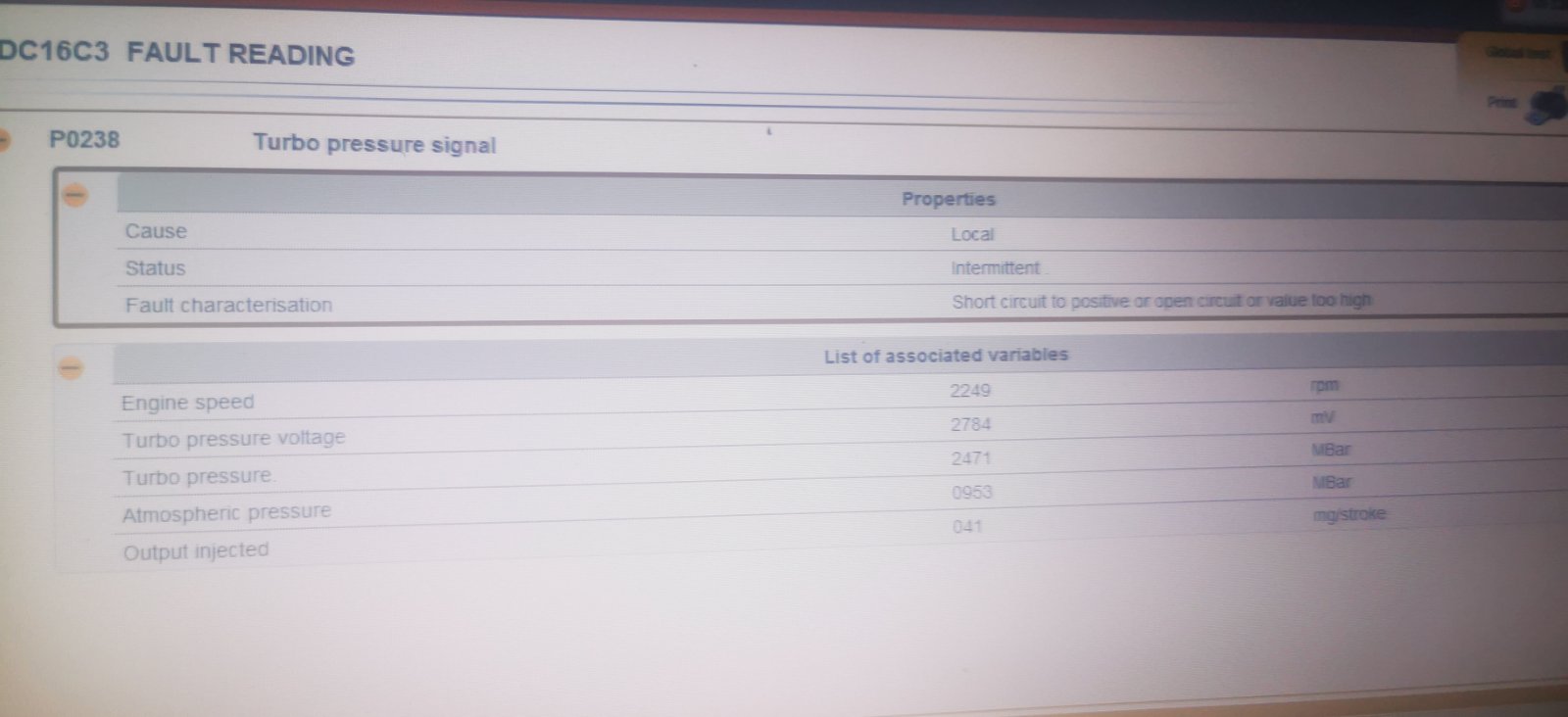

I replaced the map sensor without any changes. The same code P0238 turbo pressure signal

It's very strange, because it's an intermittent code that only appears during strong acceleration. The car does not go into limp mode. The code is cleared with the diagbox, but it appears again when I accelerate strongly.
