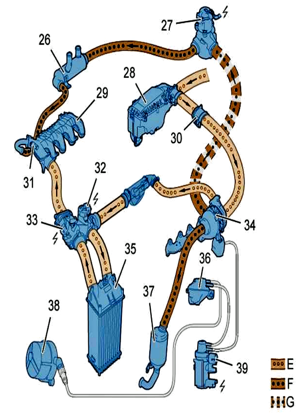

From what I can make out, the sensor circled red is the Inlet Air Pressure Sensor & the one circled in yellow is the Air Intake Temperature Sensor.
Here's a diagram of the system so you can check the circuit and see where the turbo control solenoid is etc.
Key:
"E": Air circuit
"F": Exhaust gas
"G": Duct crossing the engine block
ReferenceDesignation
(26)Exhaust gas recycling (EGR) heat exchanger
(27)Exhaust gas recycling (EGR) regulation electrovalve
(28)Air cleaner
(29)Air inlet manifold
(30)Air flow meter
(31)Inlet air pressure sensor (oversupply)
(32)Inlet air heater throttle (RAA)
(33)EGR butterfly
(34)Variable geometry turbocharger
(35)TURBOCHARGING AIR COOLER (RAS)
(36)Vacuum reservoir
(37)Catalytic converter / Particulate emission filter (pef)
(38)Vacuum pump
(39)Turbocharger control solenoid valve

1. I checked the wiring from the MAP sensor/Inlet Air Pressure Sensor and I saw a value of 5v, so the wiring is ok.
2. I checked the vacuum hoses from the Turbocharger control solenoid valve and they are ok.
3. I checked the Turbocharger control solenoid valve which, according to the live data from the diagbox, works, and raises the turbocharger actuator during acceleration.
In the end, I found that the problem is the MAP/Inlet Air Pressure Sensor, I will buy one from Denso.
