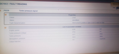

I have a problem with this error code P0238, read with my diagbox.
Car: Peugeot 307 1.6hdi 90hp year 2006
I think the problem is the MAP sensor.
How can I check the MAP sensor? What should I follow on the live data in the diagbox to realize that the problem is the MAP sensor.
I tried to look for the diagnostic procedure in the service box but to no avail.It's the only code I get on the diagbox. When accelerating hard, a check engine appears with the anti-pollution message on board.

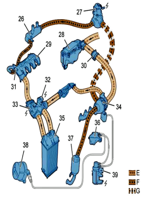

From what I can make out, the sensor circled red is the Inlet Air Pressure Sensor & the one circled in yellow is the Air Intake Temperature Sensor.
Here's a diagram of the system so you can check the circuit and see where the turbo control solenoid is etc.
Key:
"E": Air circuit
"F": Exhaust gas
"G": Duct crossing the engine block
Key:
"E": Air circuit
"F": Exhaust gas

1. I checked the wiring from the MAP sensor/Inlet Air Pressure Sensor and I saw a value of 5v, so the wiring is ok.
2. I checked the vacuum hoses from the Turbocharger control solenoid valve and they are ok.
3. I checked the Turbocharger control solenoid valve which, according to the live data from the diagbox, works, and raises the turbocharger actuator during acceleration.
In the end, I found that the problem is the MAP/Inlet Air Pressure Sensor, I will buy one from Denso.
1920CZ is the OE code.

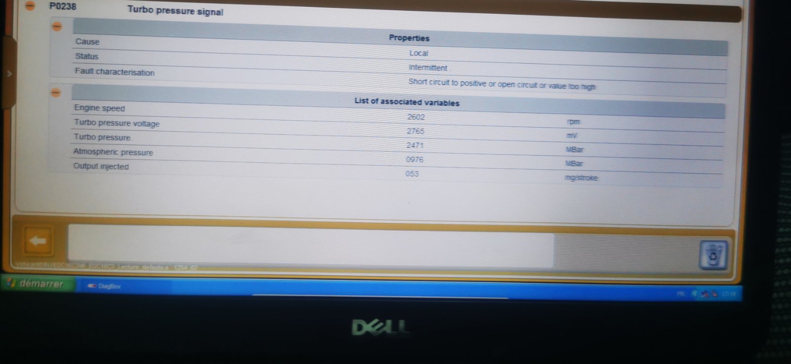

I replaced the map sensor without any changes. The same code P0238 turbo pressure signal

Re: P0238 turbo pressure signal 1.6hdi Peugeot 307
It's very strange, because it's an intermittent code that only appears during strong acceleration. The car does not go into limp mode. The code is cleared with the diagbox, but it appears again when I accelerate strongly.
