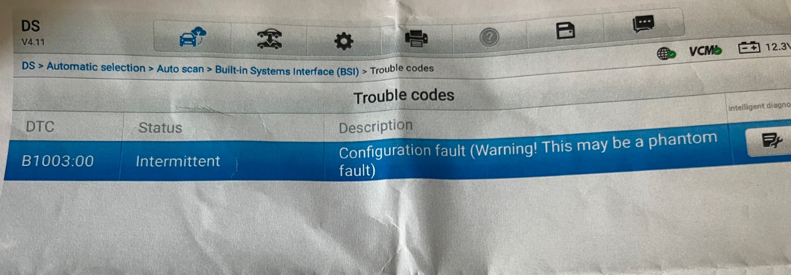

The garage read the code but the diagnostic report came back as
status: intermittent
description: configuration fault (warning! This may be a phantom fault).
They said the car ‘computer’ had to be reset. They did this and it is working fine now.

Not sure if this is a fault code: B1003:00

Ok, so your mechanic is not using Diagbox which is recommended for proper fault finding as these vehicles have lots of tech that a lot of aftermarket diagnostic tools can't read, just so you know.
This fault is basically stating that the BSI has not completed a configuration properly - this can be caused if the BSI software has been updated at the dealership previously and it has not been fully completed. Sometimes it can take a few attempts for the update to save correctly.
| Fault Code: | B1003 00 |
| Description of Fault: | Configuration fault. Configuration procedure interrupted or incomplete. Conditions of activation of the diagnostics Possibility 1 The following conditions have to be met - Vehicle stationary - Ignition on - Vehicle not in economy mode Possibility 2 The following conditions have to be met - Vehicle stationary - Engine running |
| Conditions for Fault to clear: | The configuration has been carried out successfully. |
| Downgrade Modes whilst Fault is active: | - |
| Symptoms: |
| Suspect Areas: | Configuration of the built-in systems interface |

Thanks so much for this info.
I did actually get an update back in January and haven’t had any problems since with the loss of power- until today
The only problems I’ve had is the sat nav screen not always coming on and the windscreen and back window heaters and heating system buttons not working. Very odd things.
I’ll have to get on to the DS dealer with this info and get it booked in again. Just a shame it’s 100 miles away. There aren’t many DS dealerships in England , all spread out.

Re: Loss of power - phantom fault
Well all those issues you are experiencing are pointing to the BSI and until this is corrected you will continue to have failures and odd behaviour most likely.
If you reported this to them before when it was under warranty and they looked at it - then I would argue the case that it has never been resolved and has now led to things getting worse if the same fault was coming up. They would have a record of it I suspect. Once thing is certain you can't go on with it like this as you may have a more severe impact of the system failing.
