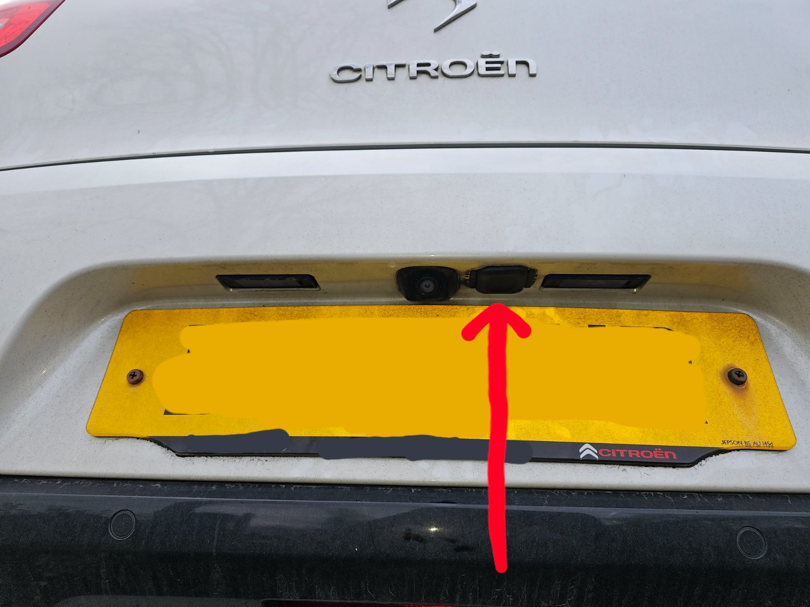

Anyone know how to remove the boot release button that's above the rear number plate in the bumper? Mine seems to be stuck in causing the boot to open when you open the car with the remote.
I don't use the button in the bumper so just want to remove it to solve the issue. I've tried to pull the rubber button down and out but it feels solid. Hoping it's not a bumber off job.

Yes, that's the switch (next to your reversing camera) that is a squarish module that sits inside with an electrical connector. You need to replace it otherwise you'll neve get the boot open from the outside - and you'll have water / moisture getting in and rotting the wiring loom leading to other issues.

Just a bit confused as to how I access the button. Are you saying it's not a bumper off job? The external boot release button is solid in the bumper. Can I take the trim off inside the boot and access it from there? Or is the bumper not accessible from there? I saw a bumper removal guide on a other forum and that showed a hole/cut out behind the number plate but I don't think mine has that.

Ok, so apologies, the diagram shows it on the tailgate, but it's a 'sectional' image, intended stupidly to show the electronic lock - which is as your picture shows on the bumper part unlike a lot of other PSA vehicles. I've clarified my previous post to specify the location of the electronic switch.
So yes, in this case, it is a bumper off job to access it, which is quite involved on this model.
