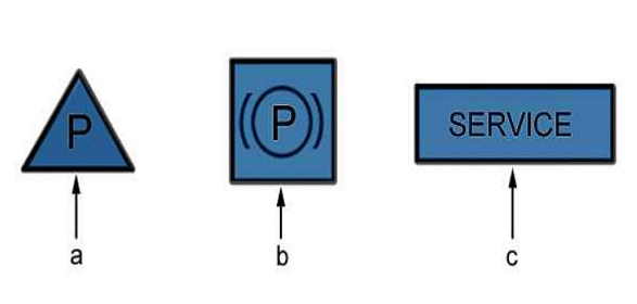

Re: engine FAULT replacement needed on citroen ds4 2012[engine checklight
Here you are:
* Switching on of the warning lamp and/or warning message
"a": Electric parking brake fault warning lamp
"b": Electric parking brake warning lamp
"c": Service warning lamp
| Fault Code: | U1208 |
| Description of Fault: | No communication with the engine management ECU fault: Value received incorrect. The engine ECU gives invalid data or information that is too short. Switching on of the warning lamp and/or warning message Warning lamp - "a" : Not on - "b" : Not on - "c" : Not on |
| Conditions for Fault to clear: | - |
| Downgrade Modes whilst Fault is active: | No back-up mode |
| Symptoms: |
| Suspect Areas: |

There is no standard 'fix' The code is there to assist with onward troubleshooting. But if you have checked all your electrical connections to the Engine ECU and the indicated warning lamps are NOT on as shown in the fault code analysis above, then you may have an issue with the engine ECU itself.
