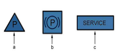

Here you are:
* Switching on of the warning lamp and/or warning message
"a": Electric parking brake fault warning lamp
"b": Electric parking brake warning lamp
"c": Service warning lamp
| Fault Code: | U1208 |
| Description of Fault: | No communication with the engine management ECU fault: Value received incorrect. The engine ECU gives invalid data or information that is too short. Switching on of the warning lamp and/or warning message Warning lamp - "a" : Not on - "b" : Not on - "c" : Not on |
| Conditions for Fault to clear: | - |
| Downgrade Modes whilst Fault is active: | No back-up mode |
| Symptoms: |
| Suspect Areas: |
