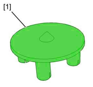

By the way... Does anyone has an Hub Centre tool that we could get measurements in order to be easier replicate the original on a 3D printer? That would be awesome , as the finding of radius is a bit more complex than it appears...
x 6945
Re: Check and Regulate C5 Mk1 Suspention
These aren't available that I can see as they are special tools. Best bet is to improvise and use the centre of a wheel cap to mark the centre with a marker or similar.
