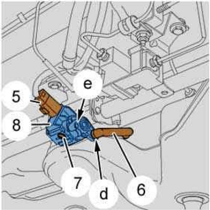

Fitting Guide for Rear:
Removing:
Disconnect the connector (5).
Disconnect the rod (6), as "d".
Peg the height sensor at " e" using a 4 mm diameter rod.
Remove:
The (7) bolt
The height sensor (8)
Refitting:
Refit the height sensor ( 8).
Refit bolt (7), Tighten to 0,4 ± 0,1 daN.m.
Remove the setting rod from the height sensor.
Connect the connecting rod ( 6), as "d".
Reconnect the connector (5).
Check the heights of the vehicle (see the relevant operation).

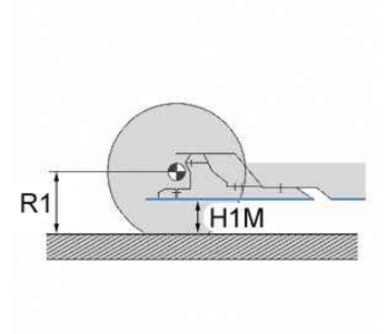

Height Check C5 MK II (Facelift 2004 to 2007):
Official Tools - but you can improvise:
Measuring the heights
Wheel Radius Measurement
The front height H1M is measured between the ground and the subframe, at the rear of the suspension arm front fixing yokes.
Calculating the front height H1C
H1C = R1 - 140 mm .
R1 = Front wheel radius ( mm).
Compare:
The value measured H1M
The value calculated H1C
Adjust the front height if necessary.

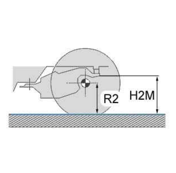

Measuring the Rear Height H2M
The rear height H2M is measured between the ground and the zone "a" on the crossmember.
Calculating the rear height H2C
H2C = R2 + 68 mm .
R2 = Rear wheel radius ( mm).
Compare:
The value measured H2M
The value calculated H2C
Adjust the rear height if necessary.
Removing:
Remove:
The (7) bolt
Refitting:

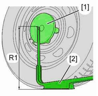

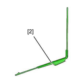

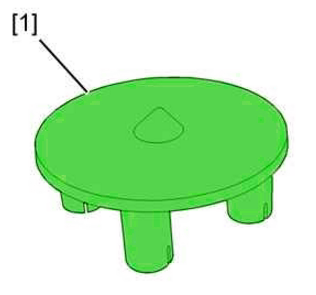

- Place tool [ 1] over the wheel screw heads to determine the wheel centre.
- Measure radius R1 with tool [2] (between the wheel centre and the ground).
H1C = R1 - 140 mm .
Compare:

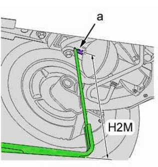

H2C = R2 + 68 mm .
Compare:

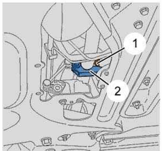

Front height

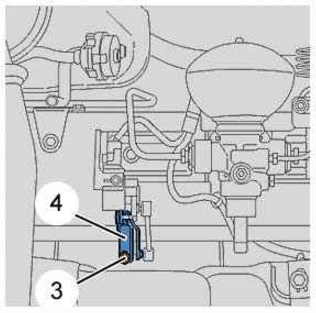

- Loosen by one turn the screw ( 1) on the collar (2).
- Re tighten the screw by hand.
- To decrease the height, turn the collar ( 2) towards the front of the vehicle.
- To increase the height, turn the collar ( 2) towards the rear of the vehicle.
- Repeat the operation until the calculated dimension H1C is obtained (± 10 mm).
- Tighten the bolt (1) to 0,6 daN.m.
- Perform the adjustment with tool [ 3] or with tool [4].
- Loosen by one turn the screw ( 3) on the collar (4).
- Retighten the screw by hand.
- To decrease the height, turn the collar ( 4) towards the rear of the vehicle.
- To increase the height, turn the collar ( 4) towards the front of the vehicle.
- Repeat the operation until the calculated dimension H2C is obtained (± 10 mm).
- Tighten the bolt (3) to 0,6 daN.m.

- Calculate 280 - (R1-H1M) for the front.
- Re-enter this value in the diagnostic tool.
- Calculate (H2M-R2) for the rear.
- Wait for the correction of the vehicle’s height.
- Measure the front height H1M.
- Check that: H1M = H1C ± 2 mm.
- Measure the rear height H2M.
- Check that: H2M = H2C ± 2 mm.

- x 6946
Re: C5 exclusive estate. Ride height.
Yes, that is a perfectly logical reason for this to happen and will of course affect the heights. The whole unit is clamped onto the ARB at the position shown and the sensor is then calibrated using Lexia / Diagbox to ensure the heights are within the tolerance of the reference values. Once the heights are calculated and the values set - ANY movement of the clamp that rotates the sensor about the Anti Roll Bar will change the data the sensor sends to the suspension ECU, which will then begin making height corrections on the relevant axle to compensate.
That is why before removing the sensor, a setting rod (see warning note to remove when refitting in red in my notes) is used to peg the position of the internal sensor. If you are replacing the same sensor, then the position on the ARB should be marked with some white paint or a marker so that it is secured back in as near the exact location as it was originally, and then when it is connected and the setting rod removed, it should be in exactly the same position before it was removed.
The slightest movement of the clamp out of original position can make a significant difference to the ride height - unless it is calibrated again using the procedure above.
So any movement in the rotation of the sensor will change the potentiometer position and hence the data and height setting.
That is why the suspension ECU has the reference heights programmed in, so that when measuring and performing the height calculations, you can check if they are within the allowed range - if not then a slight adjustment can be made using Diagbox, but if they are significantly out, then a mechanical adjustment has to be made as described.
Now assuming your values are not way out of kilter as checked with diagbox, the other reason that the rear may not rise is the suspension ECU has gone into one of several backup modes. Several of these modes will inhibit the height correction (across the entire front, rear or both axles ) function entirely - as in the case of a faulty height sensor - so until the issue is tracked down it may not even raise the car at all, as an example. Again, the fault code from Lexia / Diagbox will help us determine the culprit - Sensor / data signal / earth / short etc. Small variations are tolerated and may be noticed as the car riding a little high or low - and could be as a result of a seized dog & Bone or corroded contacted internally.
