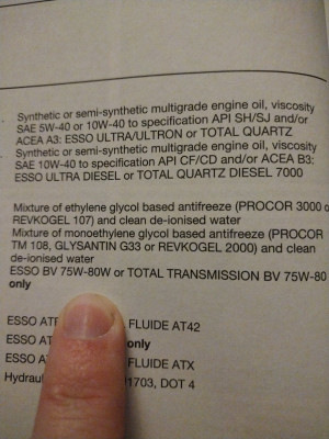

I may be be completely misremembering this but isn't the GL5 spec disallowed and you should use GL4?

Oh! Don't know!Paul-R wrote: 23 Feb 2023, 20:08 I may be be completely misremembering this but isn't the GL5 spec disallowed and you should use GL4?
Just double checked, Haynes 307 manual: Whilst I am having a look,
306 manual says:
406 Haynes says:
But googling Total Transmission BV, gives Total Traxium and that seems to be GL4
https://www.ebay.co.uk/itm/403460989313 ... media=COPY
Confusing!

You DO remember the nickname for Haynes, don't you?

And to round it off, but sadly not to bring it to a conclusion,
Haynes Citroen C4 manual (5576) 2004-2010
Oh I know the Book Of Lies isn't a great reference, but they are cheap (2nd hand) and help dry oily fingers a treat
