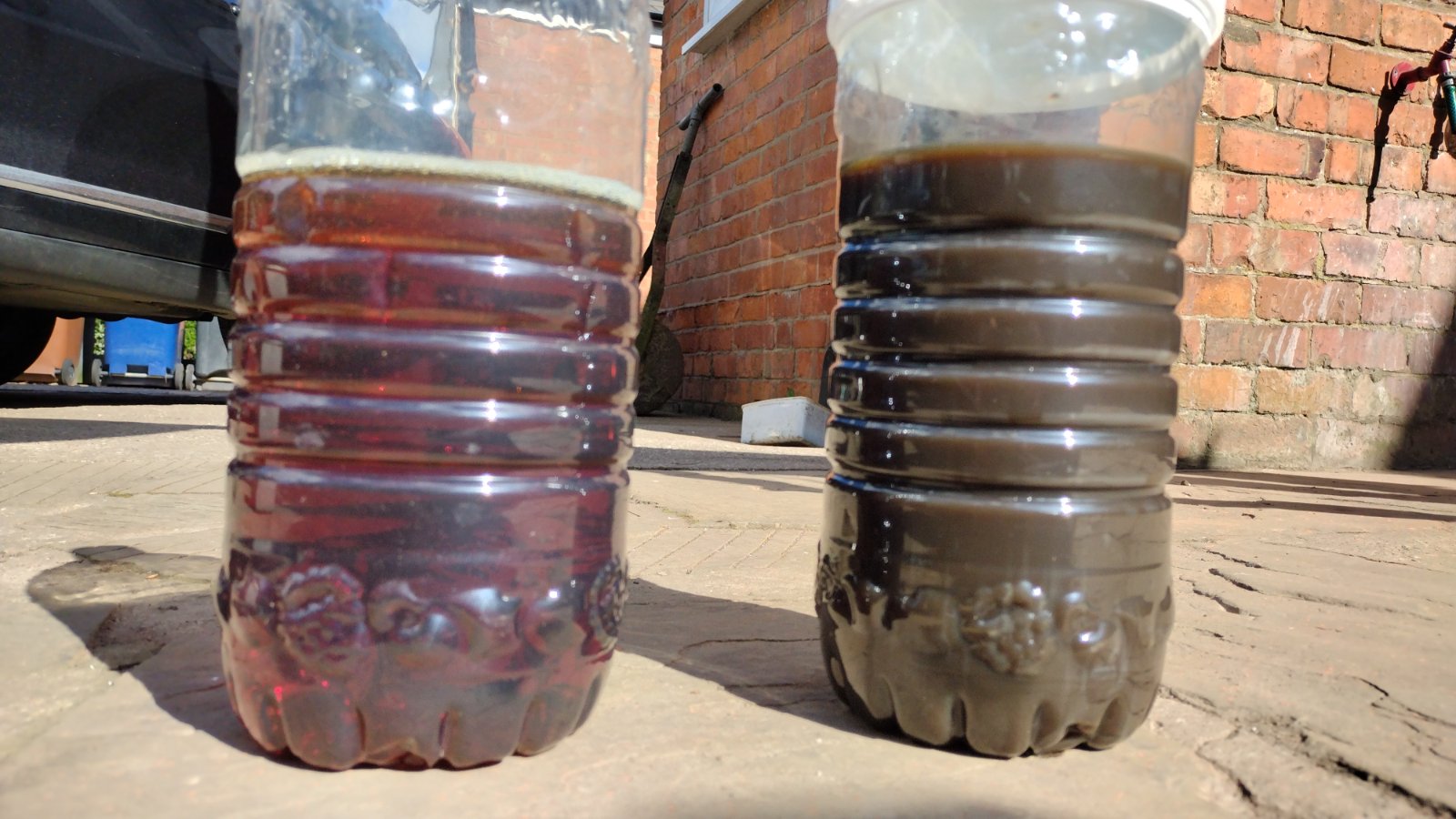

I've lost stuff I've typed too Jim - usually distracted then come back to submit it and get the log on screen instead. Sometimes I can hit Back and then copy all I've written, sometimes that doesn't work.
I'm not sure if time or mileage is best for defining when to change but "all change is good"
I have reused gearbox oil often, I know it's hypothetically possible to interact with the front left hub without the driveshaft popping out on a BE gearbox, but don't think I have ever actually achieved it!
I've tried "be careful" numerous times and still find a "little smelly puddle" appears part way through. So instead now routinely drain box oil via drain plug and no longer need think about driveshaft position!
If if looks like the above grim muck: it'll get changed, otherwise topped off and poured back in (normally via the vent top of the box rather than the level plug which is a faff to access, keep car level etc when working axle stands on driveway) funnel and short length of hose pipe coupled together just for that job.

Ditto, however carefully I've triedMattBLancs wrote: 14 Feb 2023, 10:00I know it's hypothetically possible to interact with the front left hub without the driveshaft popping out on a BE gearbox, but don't think I have ever actually achieved it!

Yes, clean drain pan (or 3 litre Vimto bottle as above - washed out, dried out of course!
) And around where the drain plug sits. Take the drained stuff well away from the rest of the job and covered till ready to feed back in. (To remove chance of the oil gaining lumps of rust, road muck, grinder dust etc!)
