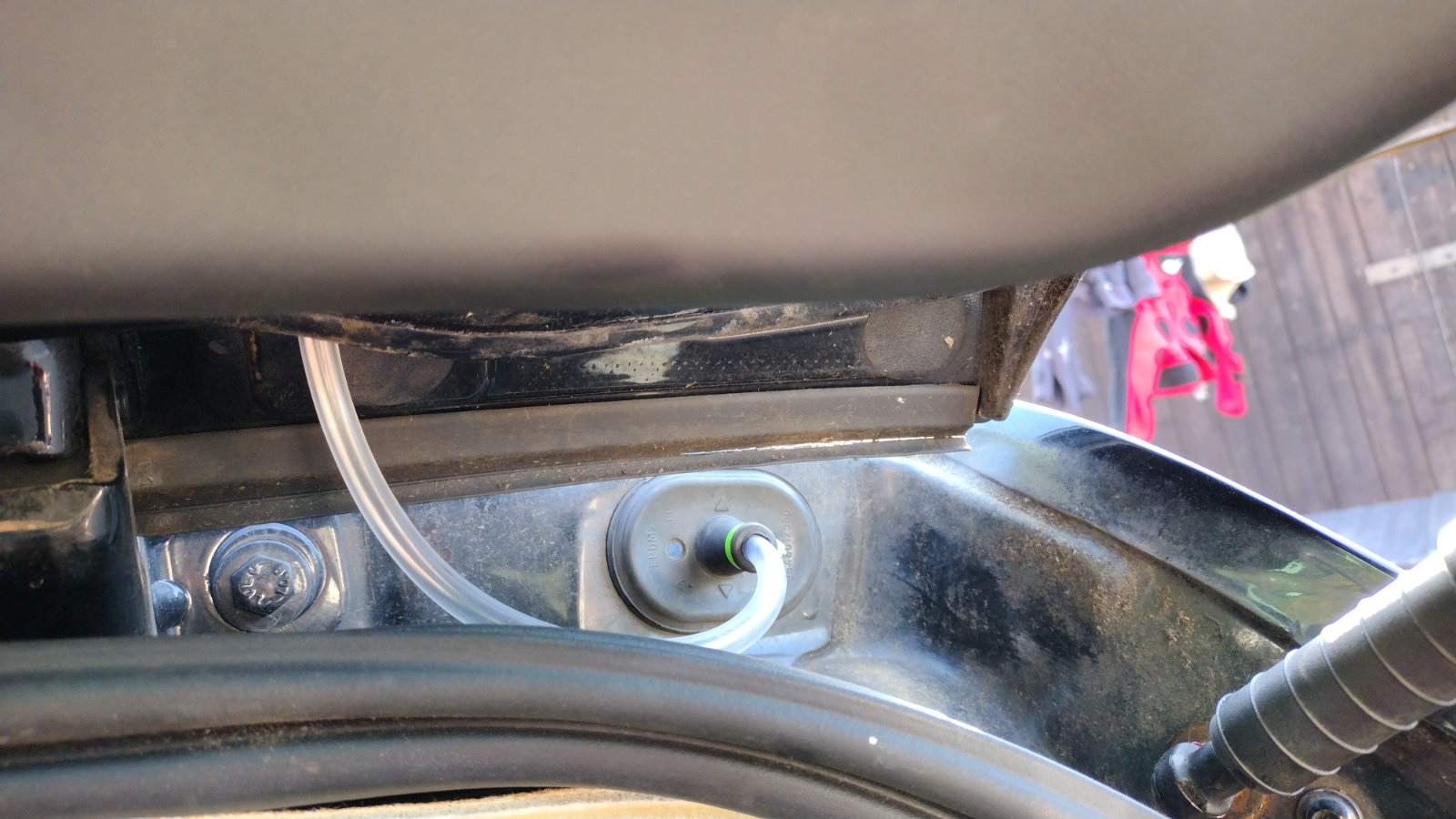

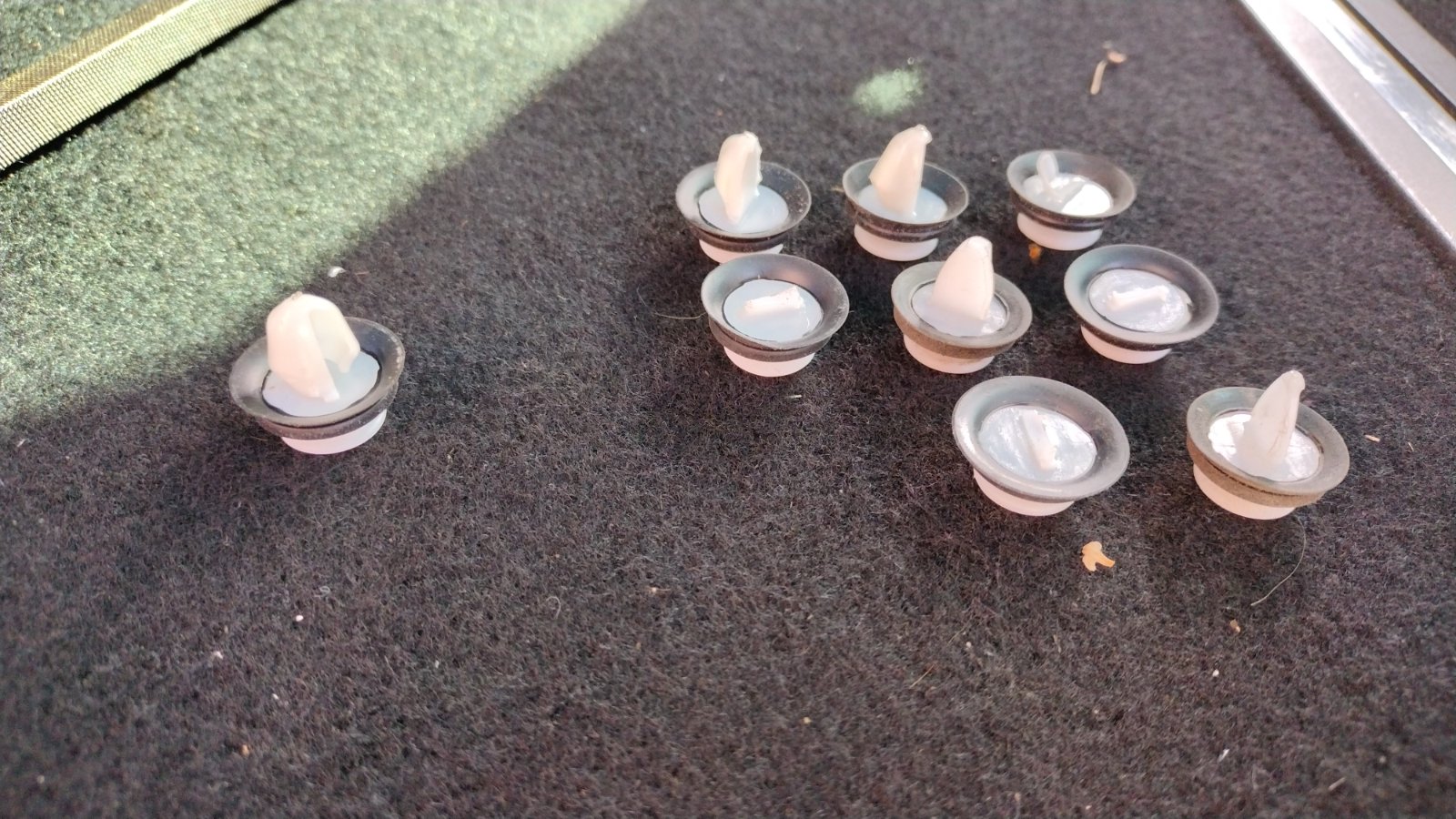

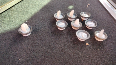

Pictures tell a thousand words, eh!
The rear spoiler removed to access this (window trim inside removed to access screwed fixings that hold this on. Then just a case of break every brittle clip and spoiler removed)
There's a joint just inside the bodywork, behind the big oval rubber boot.
Silly ridged pipe cut carefully off the joint connector and new clear washer tube pushed on. Cable tie around joint to increase purchase on the hose tail of the connector.

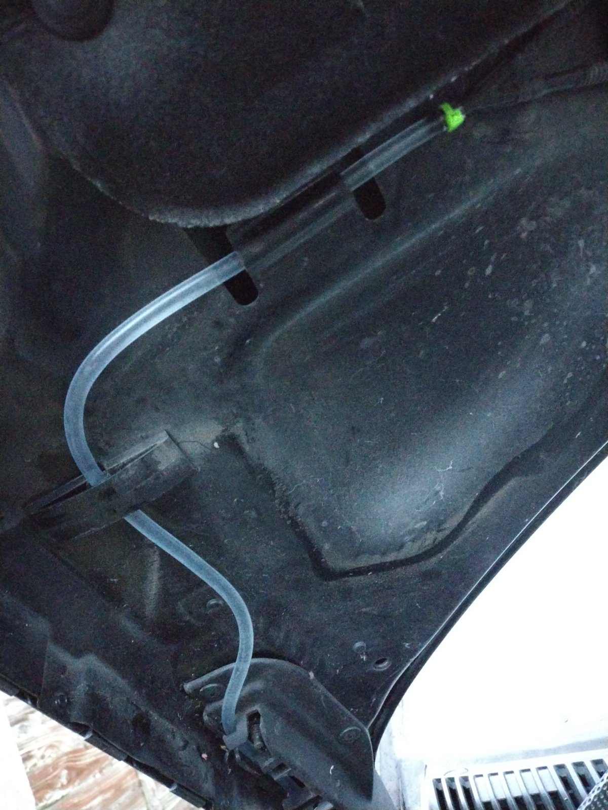

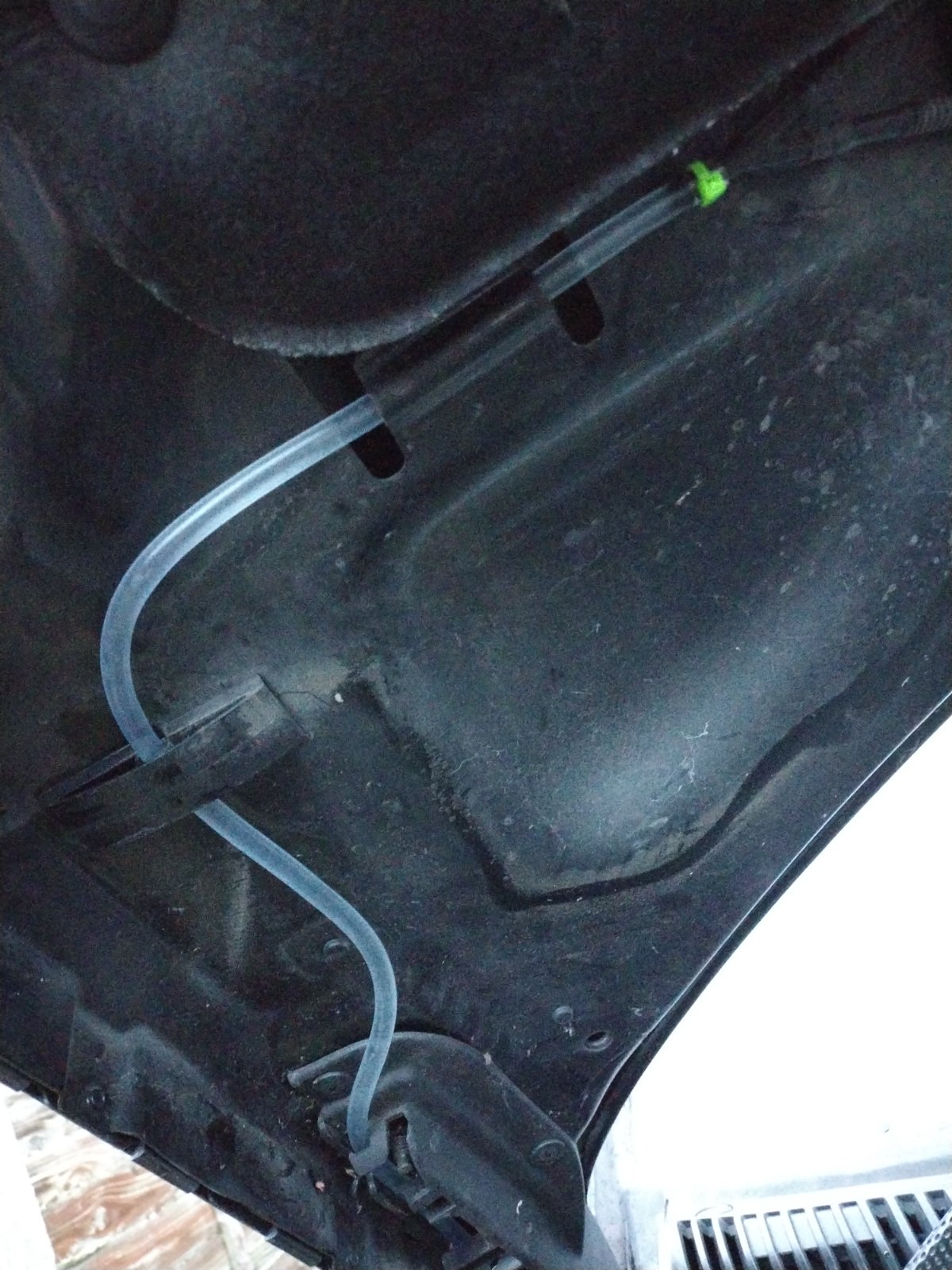

Re: Windscreen washers Pipes
Front washer pipe, body to bonnet section replacement
Matt,
Front washer pipe:
I found the original pipe eventually splits again and again then you have another repair. This pipe does not like to be bent. HENCE if I was to do it again I would run the new pipe from the 'y ' joint to the pipe connection under the wheel arch.
Rear pipe I did exactly as you have done
Kenny
Front washer pipe:
Kenny
Agree I've done half a job! but fingers firmly crossed it'll wait until next time I have car up in the air again for something else, then can get wheel arch liner off and the other section of original pipe ripped out and replaced.
Or it'll stick two fingers up at me and burst/split again next week, it's the luck of the draw!

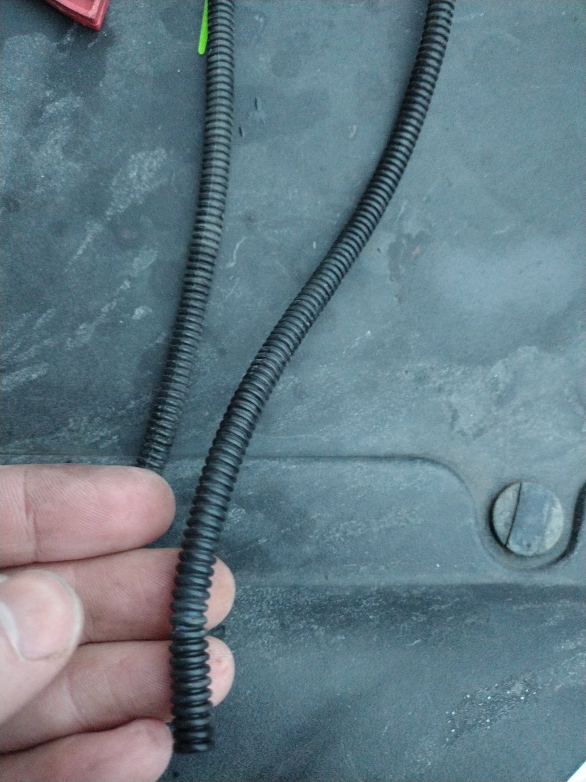

Remember this silly pipe is ridged and so may not be possible to draw a new smooth pipe along behind the old one. Certainly on the bonnet piece I changed Citroen seems to have added a ridge inside the pipe clip in one position, and the interlocked ridges put up a fight when I tried to pull the old pipe out.
