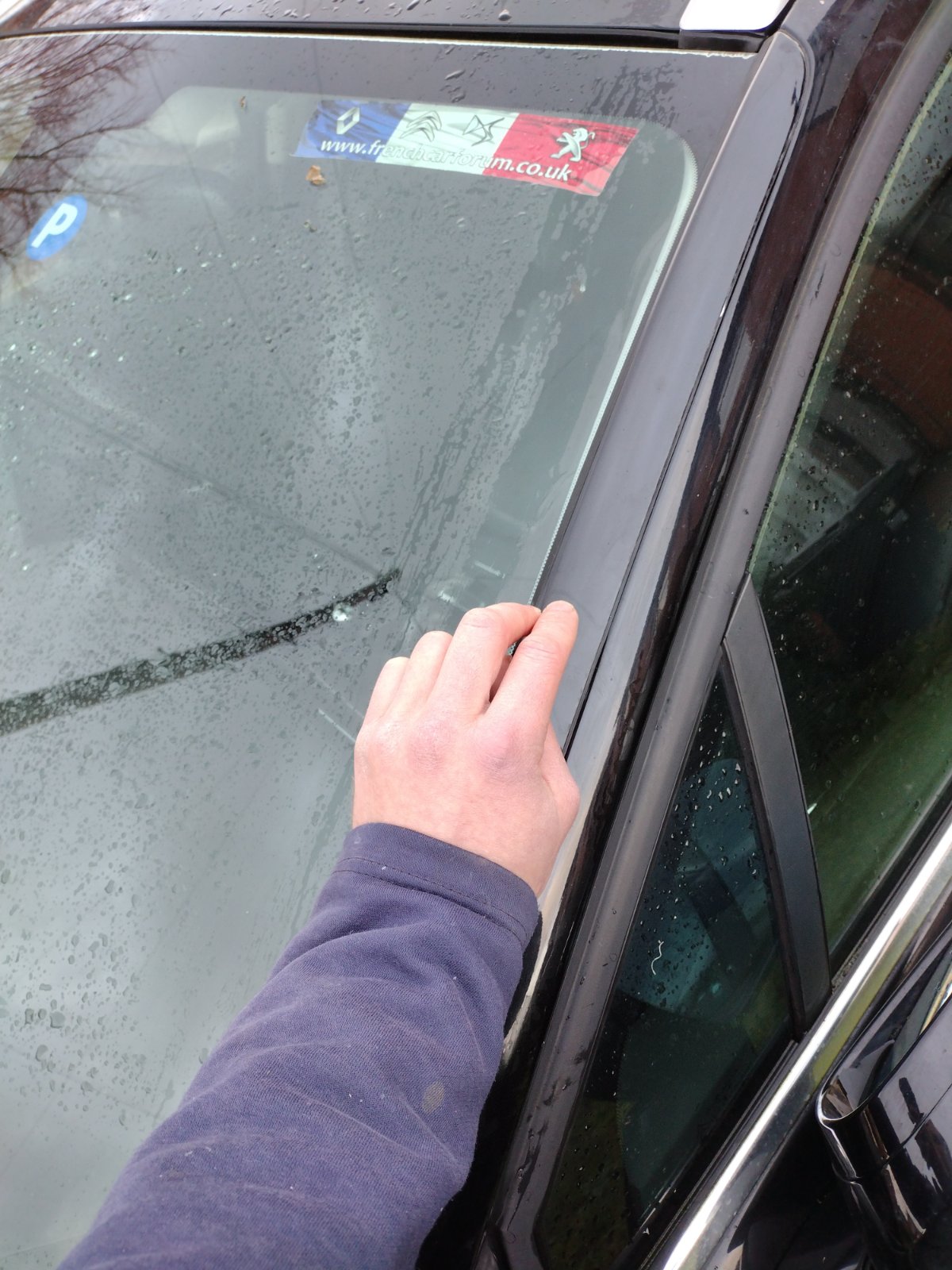

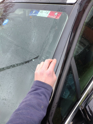

Today I shall be playing a game of "how long do I need to hold this to be sure the silicone has a good hold of it? And is it going to rain on me whilst I am stood here like a human statue...MattBLancs wrote: 14 Dec 2022, 20:45 Got on the motorway and passenger side windscreen trim decided to announce failure of its adhesive by dancing on and off the screen!
A gentle removal in the services took this off and into the car.

Yes, nicely in shot too
Had a few goes as to where to put it, but "posh" dark tinted windows hid it everywhere else I tried! (Rear quarter, back screen = hardly make it out at all!)
Looks like the silicone has failed miserably. May pull it off rather than risk loose it on my way to work tomorrow morning.

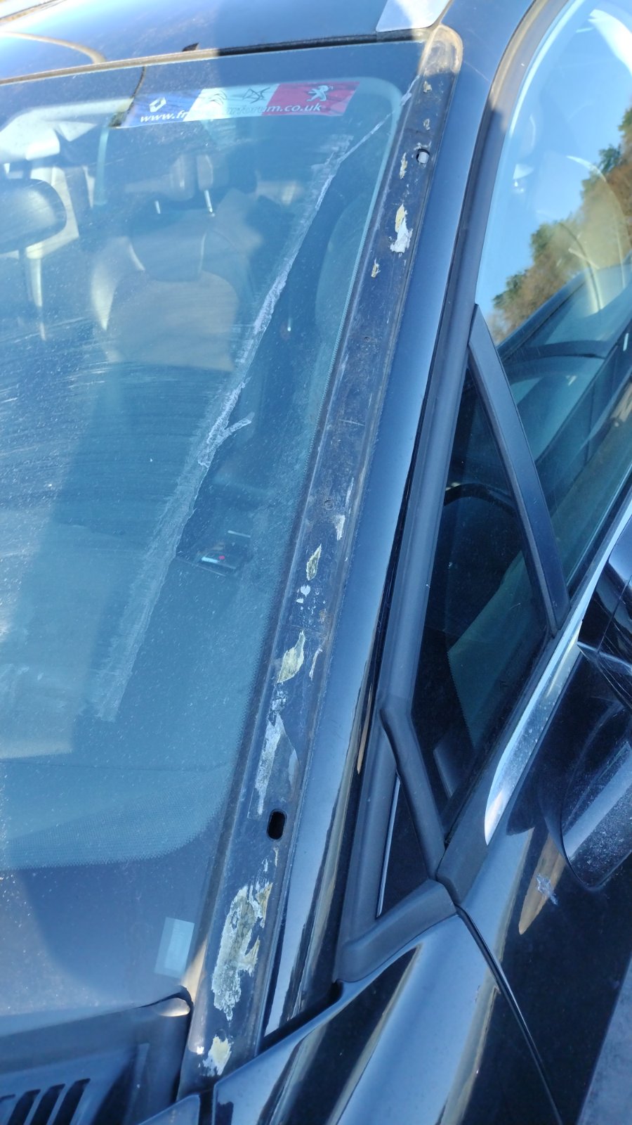

Thanks for digging that out for me -KennyW wrote: 15 Jan 2023, 17:34 Matt,
Did you not get the original yellow coloured clips to fit the trim. They are once use only but hold it well to frame. My came off driving home because I reused the old clips.
Lesson learnt. I'll try and find the citroen number
Kenny
PS https://www.ebay.co.uk/itm/173856239436
Link to clips Citroen No 8123 98. 10 clips in a pack for £3-95
Wow, those are funny looking things! No, didn't get any of those. Was two holes in the (actually surprisingly - rubber?) underneath trim. One empty, the other with some sort of flat topped clip visible. Didn't try and dig it out.
Trim is metal (aluminium?) And smooth and flat, featureless underneath. Stuck on its underside was sort of black sealant - not silicone, a stiffer substance. Peeled off in one complete piece. Also random fragments of what looked like masking tape, suspect actually some long since degraded double sided tape.
One area had some clear double sided adhesive plastic tape, that was only bit with any meaningful attachment to the metal top trim!
A couple of "witness marks" from whatever had stuck whatever the clips in the two holes were. (But only a mark, no actual adhesive? Previously removed?)
Anyway, a very long description! but wanted to describe what seemed to be an attempt upon attempt approach previously deployed to try and keep this simple piece in place!

May be too cold for it to cure properly.
Perhaps if you warm up the trim indoors and warm the car frame with a hairdryer before applying the (warm) silicone, then covering the repair with some insulating material it might work better.

Yes that's likely a big factor in my failure. I've left a couple of pieces of duct tape pulling it down slightly, didn't fly off in a ride to Southport this afternoon thankfully, will see if overnight does it aby good.myglaren wrote: 15 Jan 2023, 19:25 May be too cold for it to cure properly.
If seems at all loose in the morning I'll pull it free and have the next approach already lined up:
- Balls to it, till a warm spring day!

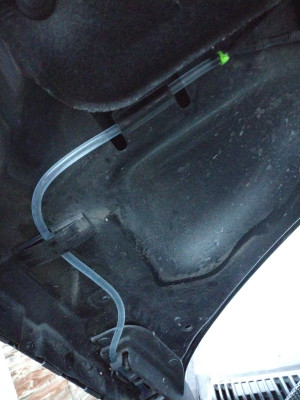

Bought a washer pump I don't need it seems, but nevermind a fix is a fix!

Yes, I thought I might be chasing this problem again and again! I've already done a short length on the rear washer, where it exists the body to the boot lid. Not looking forward to chasing the next leak on that run! (Half the interior out!)KennyW wrote: 22 Jan 2023, 21:36 Matt,
Got the same problem have cut and insert clear plastic tubing but It just keeps breaking further down the line. Going to replace with plastic tubing to the joint in front wheel arch.
Kenny
Will have a look in the wheel arch, and may yet change the pump anyway (as was only about £4) the bit I replaced was split but also the very end of the section before (which is the from the wheel arch section) so fit away with a quick fix for the moment.

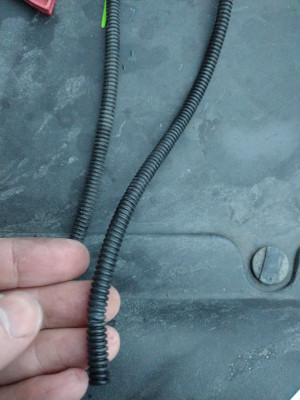

Not sure what the point of this ridged hose is really, doesn't seem a step up in any way to the normal smooth tube! Will make a decent (small) cable protector though would have to thread through or cut a slot end to end. Bits I took off straight in the bin though!

Thought mine were just frozen (and MOT man did too as didn't pull me up on it with the test thankfully)CitroJim wrote: 23 Jan 2023, 06:43 Mine on the Saxo froze up yesterday and I had to stop and squirt some water from a bottle on the screen to clean it... They thawed out later...
Then was warm enough for that not to be an issue.
No noise, checked the fuse, blown, ah that'll be it!
Ordered a pump then as unusual to blow fuse even if blocked frozen pipework
New (mini) fuse gave me noise but no squirting.
So found 2 leaks yesterday and for the moment it's functional again!
