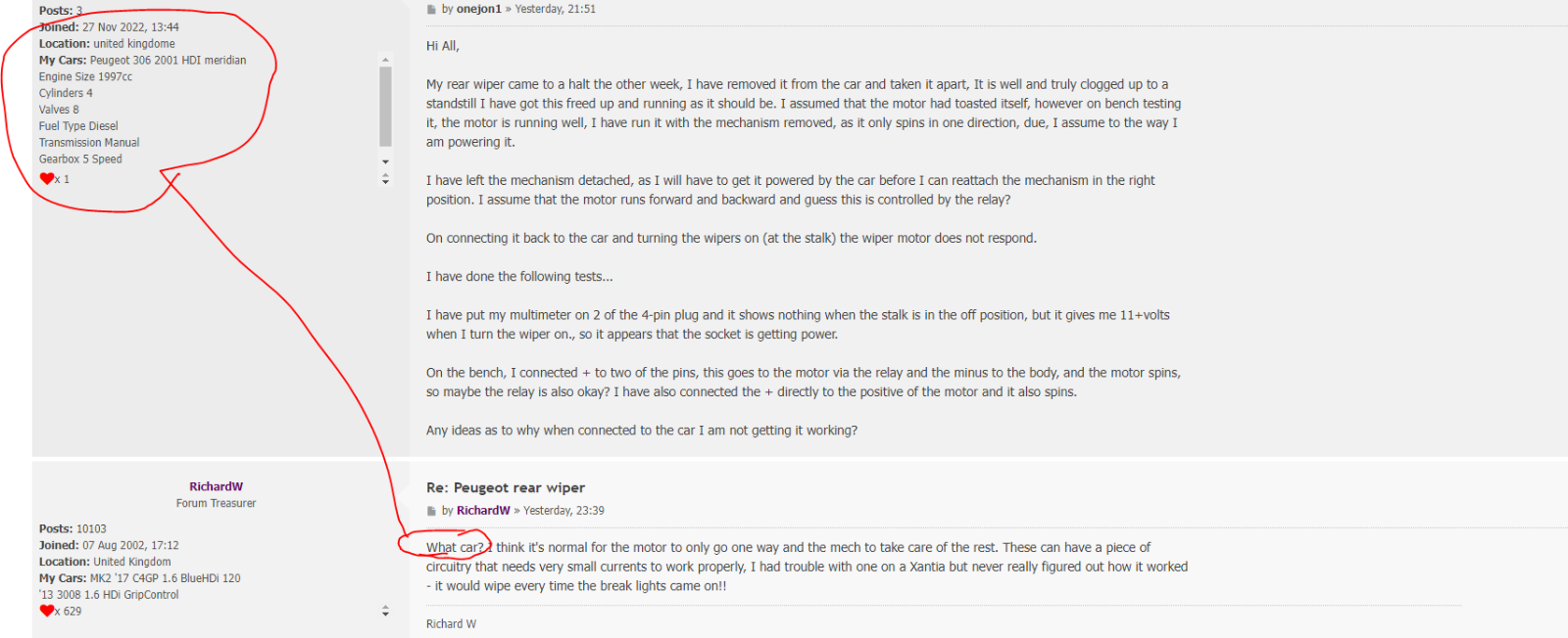

Hi All,
My rear wiper came to a halt the other week, I have removed it from the car and taken it apart, It is well and truly clogged up to a standstill I have got this freed up and running as it should be. I assumed that the motor had toasted itself, however on bench testing it, the motor is running well, I have run it with the mechanism removed, as it only spins in one direction, due, I assume to the way I am powering it.
I have left the mechanism detached, as I will have to get it powered by the car before I can reattach the mechanism in the right position. I assume that the motor runs forward and backward and guess this is controlled by the relay?
On connecting it back to the car and turning the wipers on (at the stalk) the wiper motor does not respond.
I have done the following tests...
I have put my multimeter on 2 of the 4-pin plug and it shows nothing when the stalk is in the off position, but it gives me 11+volts when I turn the wiper on., so it appears that the socket is getting power.
On the bench, I connected + to two of the pins, this goes to the motor via the relay and the minus to the body, and the motor spins, so maybe the relay is also okay? I have also connected the + directly to the positive of the motor and it also spins.
Any ideas as to why when connected to the car I am not getting it working?

What car? I think it's normal for the motor to only go one way and the mech to take care of the rest. These can have a piece of circuitry that needs very small currents to work properly, I had trouble with one on a Xantia but never really figured out how it worked - it would wipe every time the break lights came on!!
