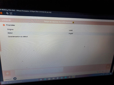

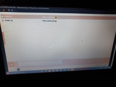

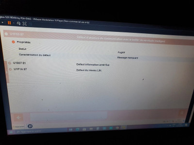

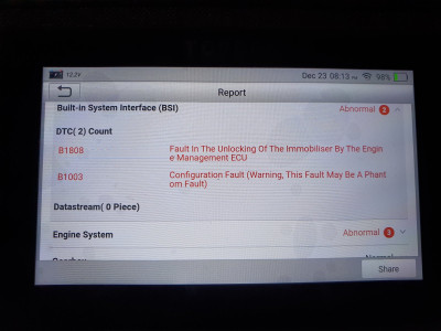

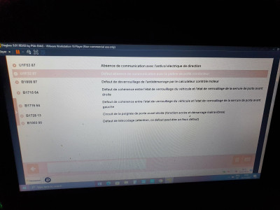

I had the engine fault come up again the day before yesterday whilst driving back home on my C4 picasso 17 plate, car still drove as normal except the cruise control and loss of power, drove it few times from home to shops etc. et drove fine with engine management on and engine fault message showing at the start. however yesterday afternoon i went to start it and it wouldn't start, tried phoning Citroen and I was told earliest appointment after 28th of December, got someone to help with Diagbox on their laptops and it read quite few faults, U1F0387, U180781, U1F1A87, U1F5387, U1F3287, B180887, B171564, B171664, B172813, B100300, U1FA000, P246300, P246C00, after resetting them the car started but I did not risk driving it again fearing it might just stop breakdown somewhere.
The description of the fault on Diagbox doesn't give much information and it was in french, can anyone help? anyone had similar issues? I know some of the code are related to some issues known to me, like the drivers side mirror not folding and keyless driver's side door handle bit temperamental what confuses me is the rest of them.
Just a bit of history, I started having issues when a battery was changed by halfords technician who struggled with it and couldn't get it out and when he managed it, did not reset anything, in fact at that was the first time I had the service message appearing on the dash.

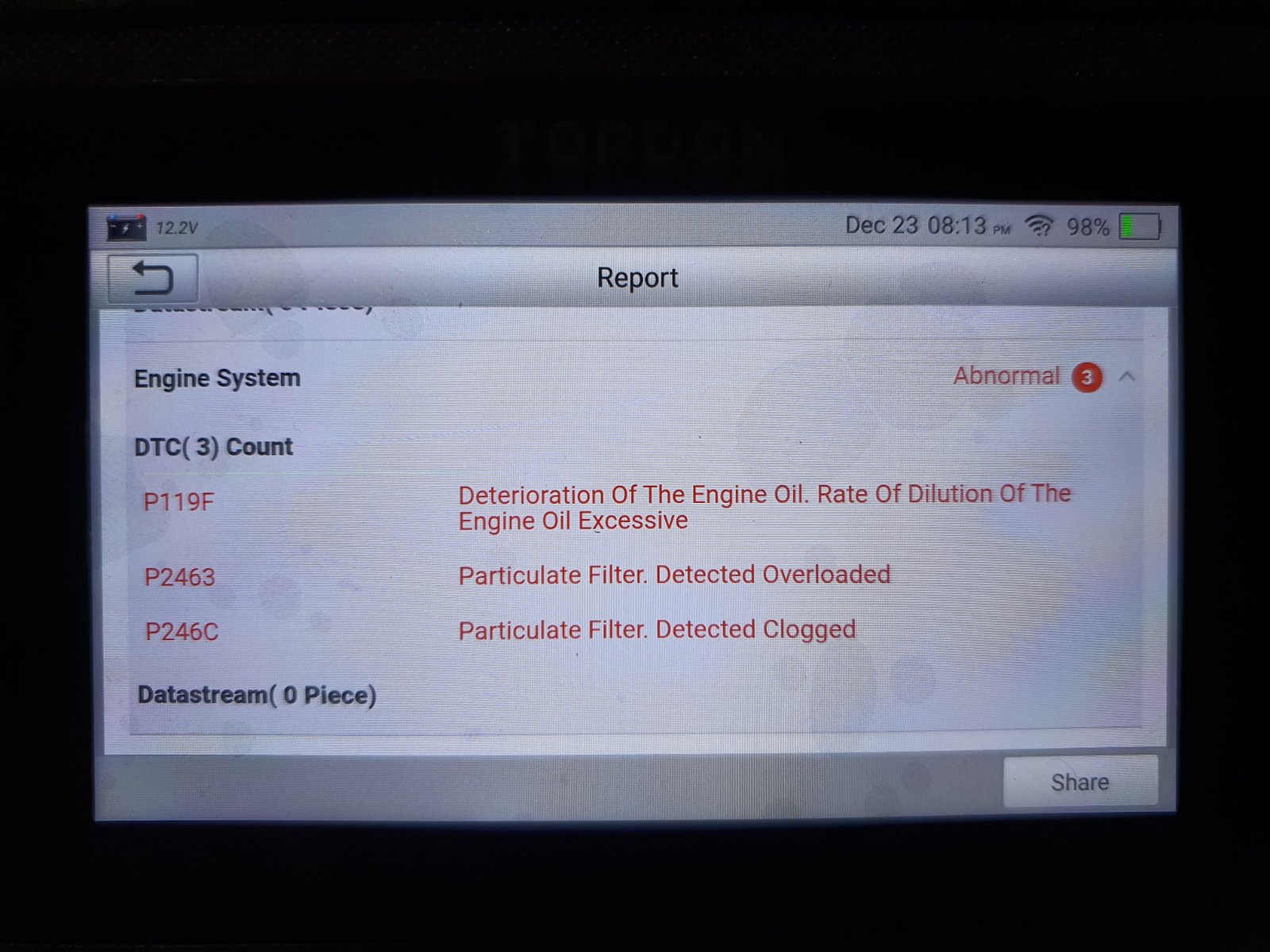

I have attempted forced regeneration using diagbox and now I got another fault which tells me engine oil has deteriorated, I tried clearing the codes and drove it for longer in the hope that it fixes the problem thinking the issue arrised ftom short journeys but it didn’t help.
Now with the festive period is bit difficult to get it into a garage, cittoen gave me 2 months lead in their appointment.
Can the oil quality be the issue? I serviced it 10 months ago at main dealer.
Is it safe to drive with this fault?

sofnet2000 wrote: 24 Dec 2022, 14:39 Image
These faults all suggest to me that the car has tried multiple times, unsuccessfully, to regenerate the DPF. Given you have given it a long run, and even tried to force a regen, I would suspect the DPF pressure sensors are faulty tricking the car into thinking it always needs to regen. Every time it does this, it adds a little unburnt fuel into the oil - designed to cope with this in normal conditions - which is why you now have the oil dilution error.
I would suggest monitoring the live data values for pre and post DPF pressure, plus DPF fill level, and see if the readings make sense. It is also possible that the DPF is actually so blocked that it cannot regen, but I doubt that on a 17-plate car unless you have hundreds of thousands of miles on it or have only ever done journeys less than 10 miles in it.
An oil change soon, hopefully after solving the original problem, would be very sensible too.
