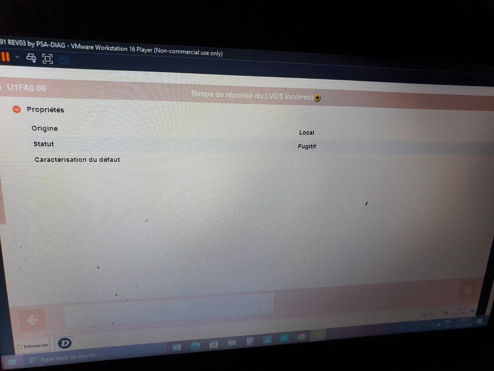

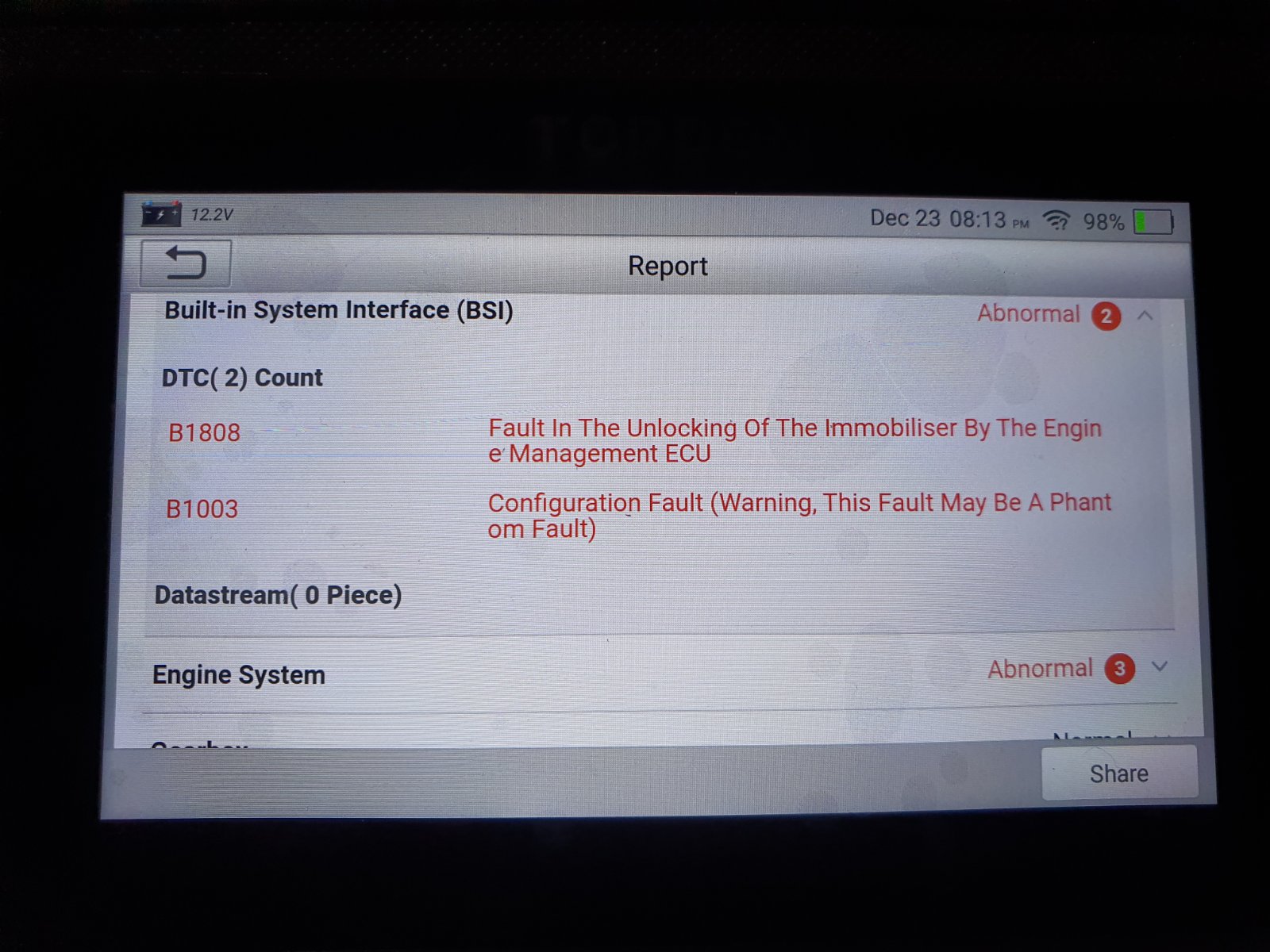

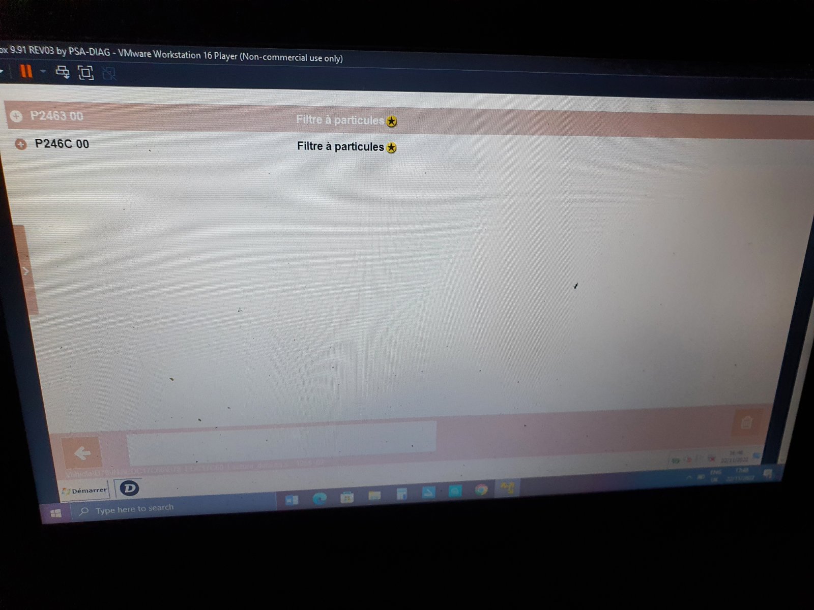

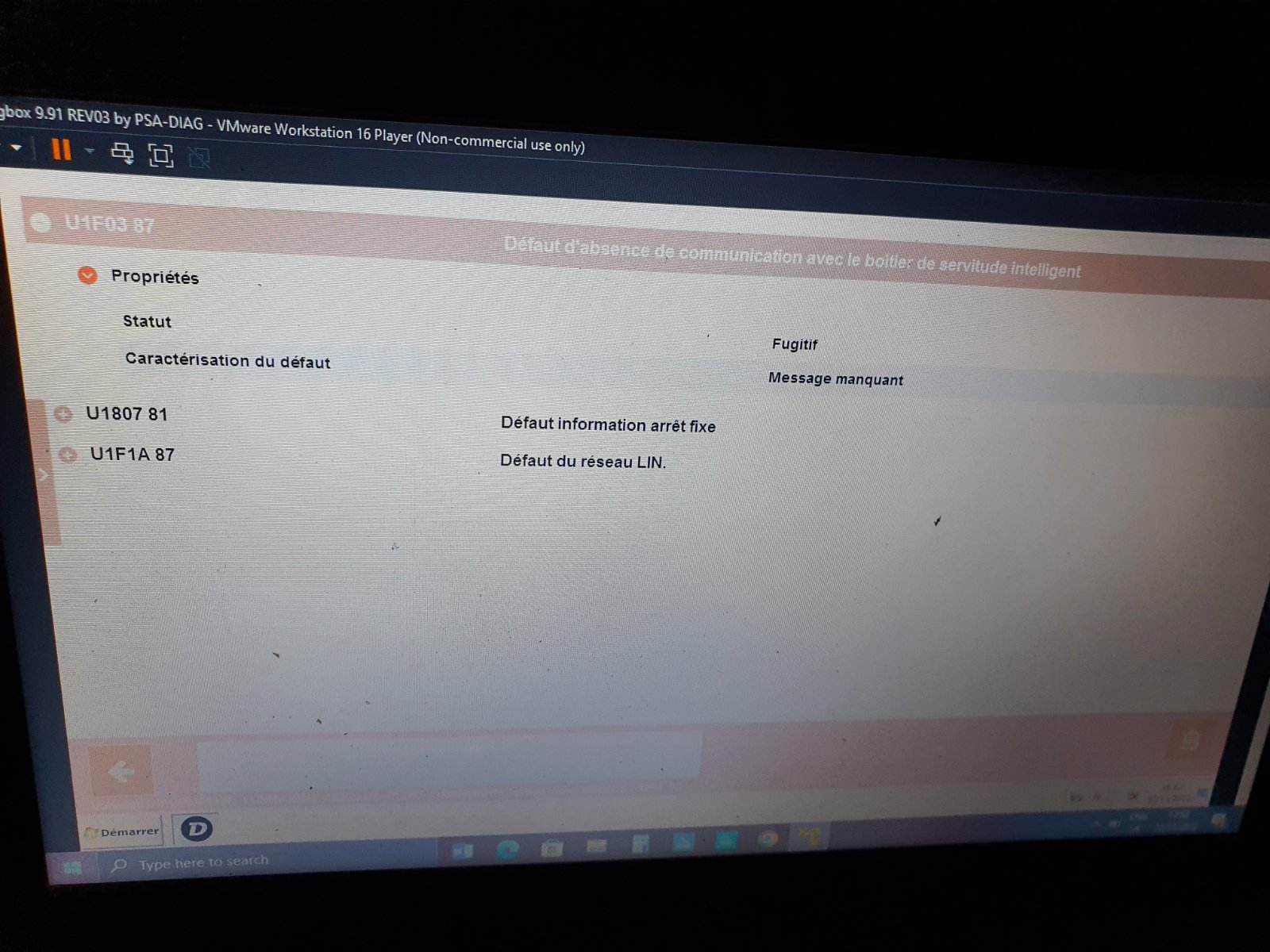

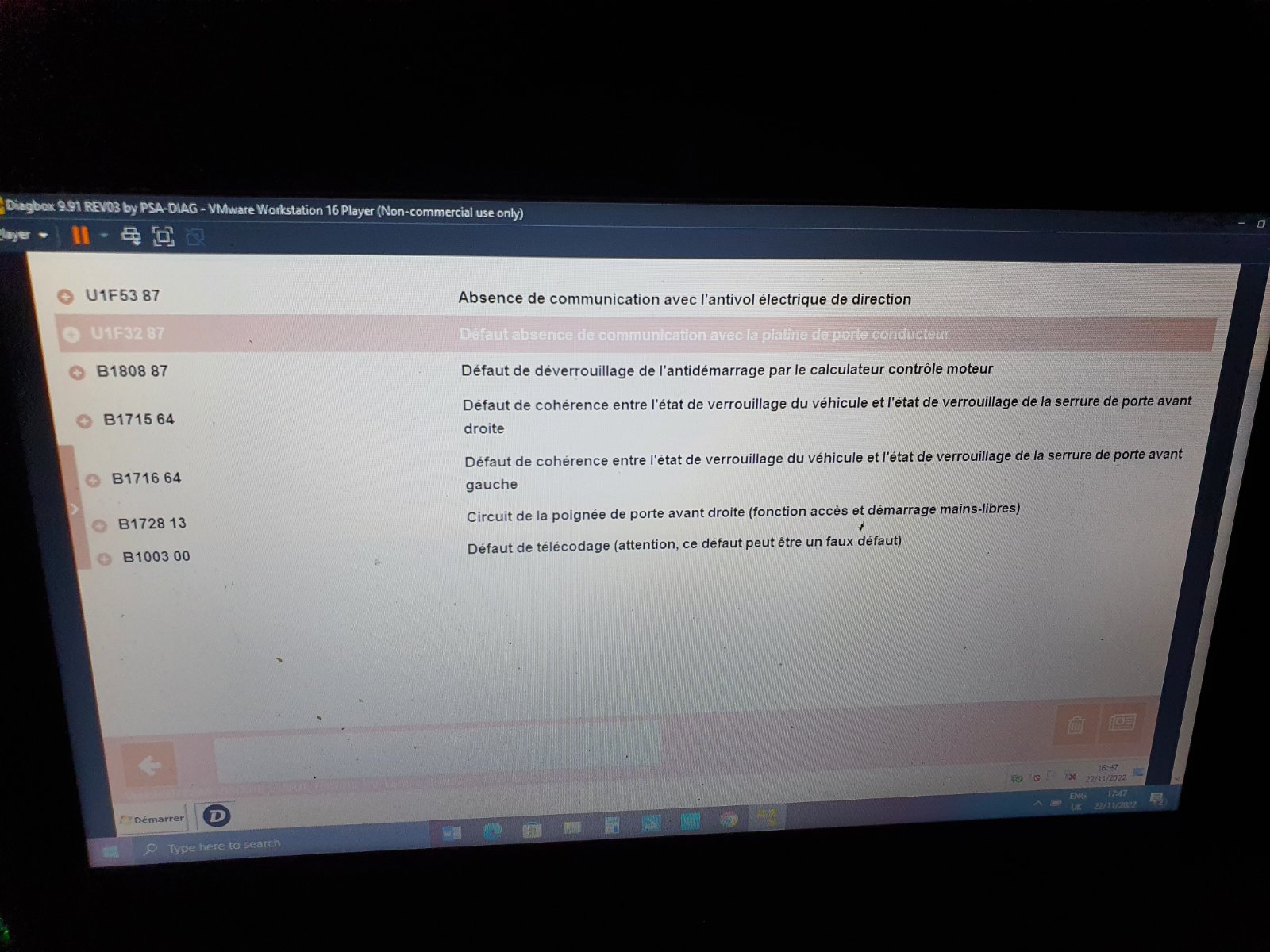

I had the engine fault come up again the day before yesterday whilst driving back home on my C4 picasso 17 plate, car still drove as normal except the cruise control and loss of power, drove it few times from home to shops etc. et drove fine with engine management on and engine fault message showing at the start. however yesterday afternoon i went to start it and it wouldn't start, tried phoning Citroen and I was told earliest appointment after 28th of December, got someone to help with Diagbox on their laptops and it read quite few faults, U1F0387, U180781, U1F1A87, U1F5387, U1F3287, B180887, B171564, B171664, B172813, B100300, U1FA000, P246300, P246C00, after resetting them the car started but I did not risk driving it again fearing it might just stop breakdown somewhere.
The description of the fault on Diagbox doesn't give much information and it was in french, can anyone help? anyone had similar issues? I know some of the code are related to some issues known to me, like the drivers side mirror not folding and keyless driver's side door handle bit temperamental what confuses me is the rest of them.

These faults all suggest to me that the car has tried multiple times, unsuccessfully, to regenerate the DPF. Given you have given it a long run, and even tried to force a regen, I would suspect the DPF pressure sensors are faulty tricking the car into thinking it always needs to regen. Every time it does this, it adds a little unburnt fuel into the oil - designed to cope with this in normal conditions - which is why you now have the oil dilution error.
I would suggest monitoring the live data values for pre and post DPF pressure, plus DPF fill level, and see if the readings make sense. It is also possible that the DPF is actually so blocked that it cannot regen, but I doubt that on a 17-plate car unless you have hundreds of thousands of miles on it or have only ever done journeys less than 10 miles in it.

Thanks Martin the trouble is that DPF error came on about a couple of months ago and after cleared it did not come back until end of novembre, someone suggested to me to do forced regeneration although percentage shown was only 13% in dpf, I did attempt the regeneration but unfortunately it did not go through in fact it stopped after 2 min and red message appeared on dash and engine cut off, after 5 mins I managed to restart the car and then this oil message started appearing.MJJ_ZX6RR wrote: 24 Dec 2022, 17:21These faults all suggest to me that the car has tried multiple times, unsuccessfully, to regenerate the DPF. Given you have given it a long run, and even tried to force a regen, I would suspect the DPF pressure sensors are faulty tricking the car into thinking it always needs to regen. Every time it does this, it adds a little unburnt fuel into the oil - designed to cope with this in normal conditions - which is why you now have the oil dilution error.
An oil change soon, hopefully after solving the original problem, would be very sensible too.
Martin.
Concerning the dpf pressure I was told it should be about 30mb and mine is well above that I think is over 150 mbr at 3000rpm.
Car only done 37k I am really puzzled, if I carry on driving it until I get serviced which won't be before new year, will it cause damage?
