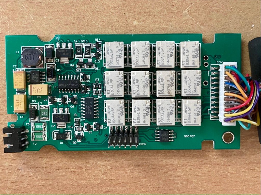

darbuck wrote: 22 Nov 2022, 16:12 Hi Mark,
I don't know if it's full chip set or is there anyway of checking an old unit?
This is what my one looks like inside. You might be able to see in the last pic that it's missing some chips - there are some contacts on the board with nothing attached.
Ross_K wrote: 14 Aug 2022, 16:42 After trying unsuccessfully to talk to my X7 for several days with the Actia cable I bought 10 years ago, it seems to be a no-go as I don't have the "full chip" version.
Full post:
viewtopic.php?t=72156

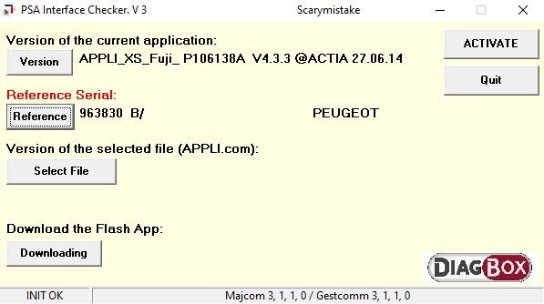

HI Lads, I've never opened it I will have a look in a while and get back to you my interface is at 4.3.2
