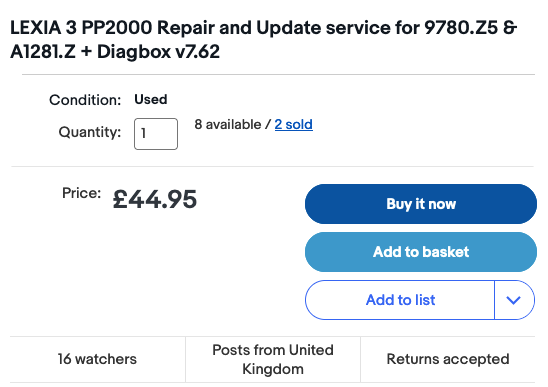

A seller on eBay (autodiagnosticsuk995) claims to update them to rev c (presumably by adding the missing components) for £45.

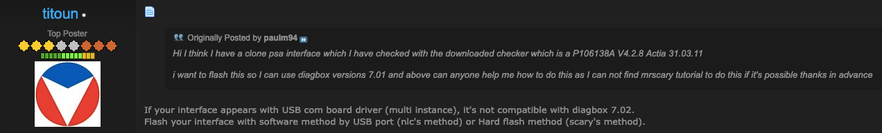

P.S. Saw this on another forum...anybody know if the claim about the "USB com board driver (multi instance)" board not being compatible with 7.02 is true? This is what mine is detected as in Windows Device Manager...

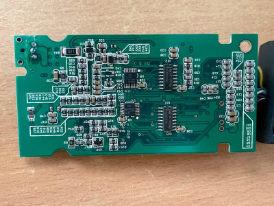

Yes I can see half the hardware is missing on your board.
