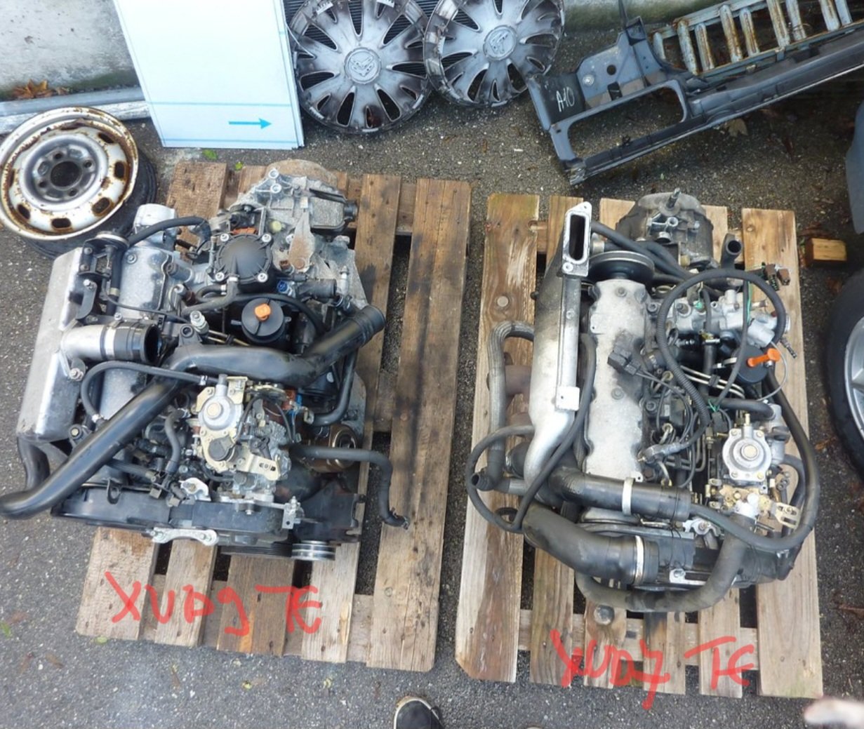

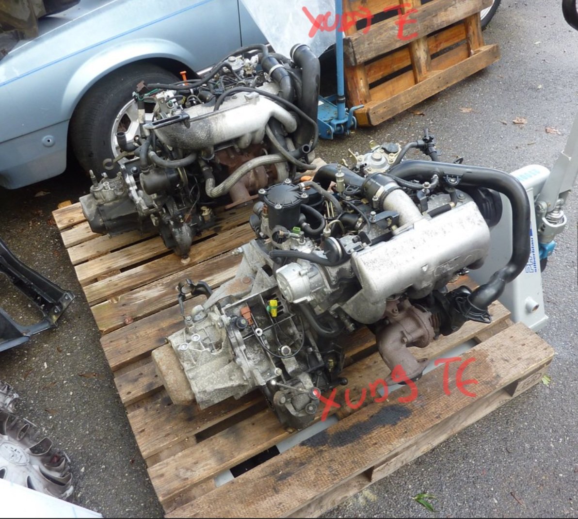

Hi all,
I have tzd bx with xud7te engine, cambelt skipped camshaft and cam caps broke off so i need new head, i have a cheap engine oportunity but its a xud9 te, i has a different intake on it and injection pump has some wires on it i think its for timing advance and there is vacuum pump on camshaft end instead of hydraulic pump pulley. Engine doesnt come with injection pump!
What i was thinking is heads look the same so i can swap my intake manifold, i can remove vacuum pump and install hydraulic pulley? And last most importat is can i swap my bosch injection pump and injectors from xud7te to xud9te??

Sorry to hear the cambelt went and damaged the head... You will be aware that bearing caps are not interchangeable between heads as they're line-bored as a set at the time of manufacture... never even try swapping them... It'll end in tears... Trust me, I've seen what can happen...
The XUD9 will transplant and with the heads being very similar the inlet manifold will transfer, as will a lot of the other ancillaries...
The XUD9 injection pump you have is the semi-electronic AS3 and must have a matching ECU and immobiliser to make it work... Not insurmountable problems but it'll take a bit of effort...
The pump from your XUD7 will physically fit but will be incorrectly calibrated to run an XUD9 and will cause underfuelling and result in poor performance... It's timing curve will likely be different too...
It may be possible to adjust it for reasonable performance by playing with its maximum fuelling and boost settings but I doubt it'll ever be 100% satisfactory...
You are best off trying to find a good fully mechanical VP20 pump intended for use on an XUD9TE. Sadly, these are now rare...
If you do find one, in all likelihood it'll need rebuilding...
The XUD7 and XUD9 heads are similar enough that they'll swap over and in that way you could retain your XUD7. Be aware though that conrods and pistons could be damaged as a result of the cambelt breakage, depending on how violent it was...

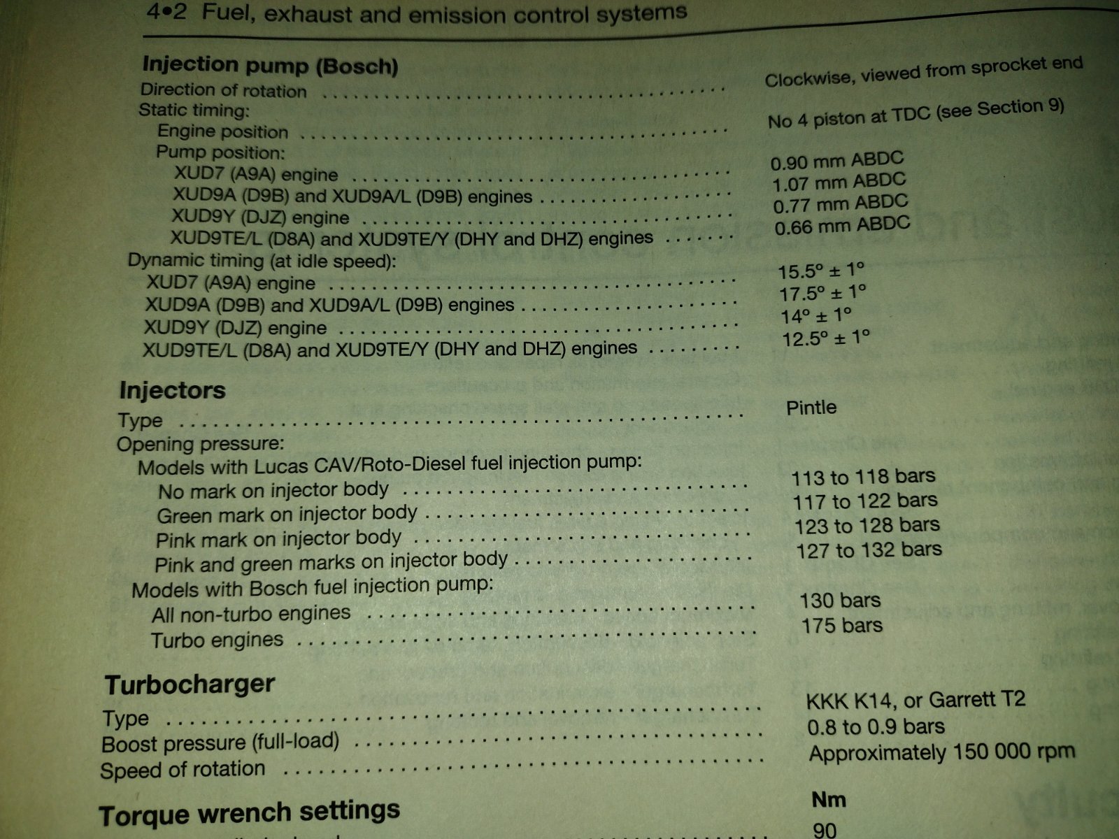

Thinking on, I'm wondering if the original XUD7 injectors should be used if the pump is swapped to the XUD9 or if the XUD9 injectors should be used... I can't currently think of any argument for or against so would appreciate your views...
Another thing that will be needed will be to swing the static timing around a little to see where it runs best... I've done this 'by ear' in the past with very adequate results...

I'm sure I have read Lucas and Bosch injectors are different opening pressures so don't mix but otherwise should be able to transfer across between XUD7 and XUD9 I think.CitroJim wrote: 11 Nov 2022, 06:25 I'm a naturally careful person in these matters and was keen not to offer any false promises or guarantees... Hence my caution...

Indeed, Lucas and Bosch injectors won't swap, and nor will their delivery pipes due to the two makes of pump having different distributor head arrangements. The cylinder delivery port are in different places and if you mix pipes the firing order will be all wrong!... In this case, both pumps are Bosch. I'm not sure if Bosch 1.7 and 1.9 injectors are calibrated for different opening pressures, hence the question...

Haynes 1922 (Citroen ZX diesel) says: Actually, scrub that - XUD7 covered here is non turbo only. 306 manual also non turbo XUD7 only. Have a 309 manual but is petrol only so am out of references to check againstCitroJim wrote: 11 Nov 2022, 08:28I'm not sure if Bosch 1.7 and 1.9 injectors are calibrated for different opening pressures, hence the question...

The Xantia XUD9 turbo also uses 175 bar injectors.
