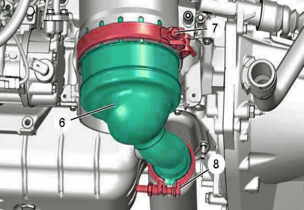

I'm assuming you have the 1.6 HDi 110.
On this engine the DPF is a lot easier to access as once you remove the pressure pipes and heat shield it should be easy to remove. I've not really heard of cleaning the Cat to be honest. If it was me, I'd just replace it, but you will need to tell the engine ECU that you have replaced the filter, otherwise it will keep flagging warnings. It notes the amount of incombustible Cerine deposits from the additive fluid and ash that has accumulated in the filter.
Prices, like most components vary greatly depending on the quality of the replacement and the brand, but don't forget to factor in the diagnostic element....

I'm sorry, my bad, I should have posted which one it was. It's actually the 109. I'll post the Vin here for easier reference
Does that diagram still apply for the 109?
