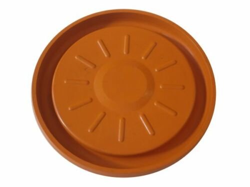

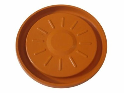

re p16a7 - I also changed the "diaphragm" (part in pic, part of the cylinder head cover), nothing changed.

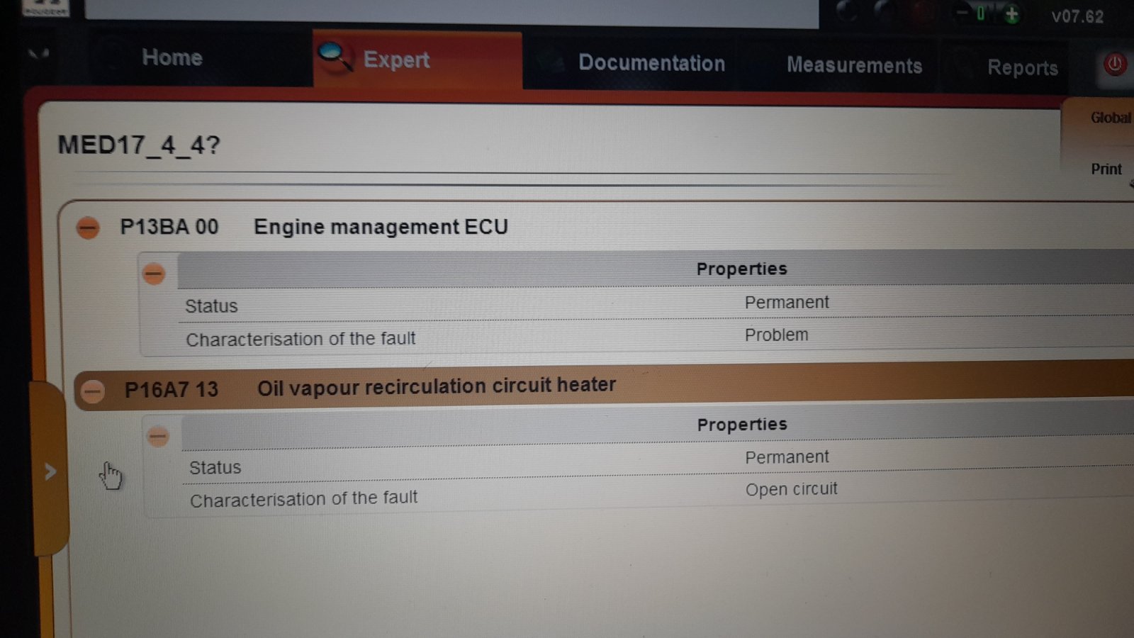

THIS IS THE READ FROM DIAGBOX

RE oil vapour recirculation circuit HEATER - the turbo hose isn't an original one - maybe this is the cause ?
Posts: 10922
Joined: 09 Nov 2005, 22:03
x 1441
Re: P13BA ENGINE MANAGEMENT ECU PROBLEM
Unread post by xantia_v6 »
508c5 wrote: 05 Sep 2022, 16:38 RE oil vapour recirculation circuit HEATER - the turbo hose isn't an original one - maybe this is the cause ?
That is highly likely. You can probably mask the error by fitting a resistor across the connector, I would start with 50?, but make sure the power rating is sufficient (5W) for 12V applied.

Exchanged between the pipes and after a test drive P16A7 didn't come back
P13BA - still a conundrum
