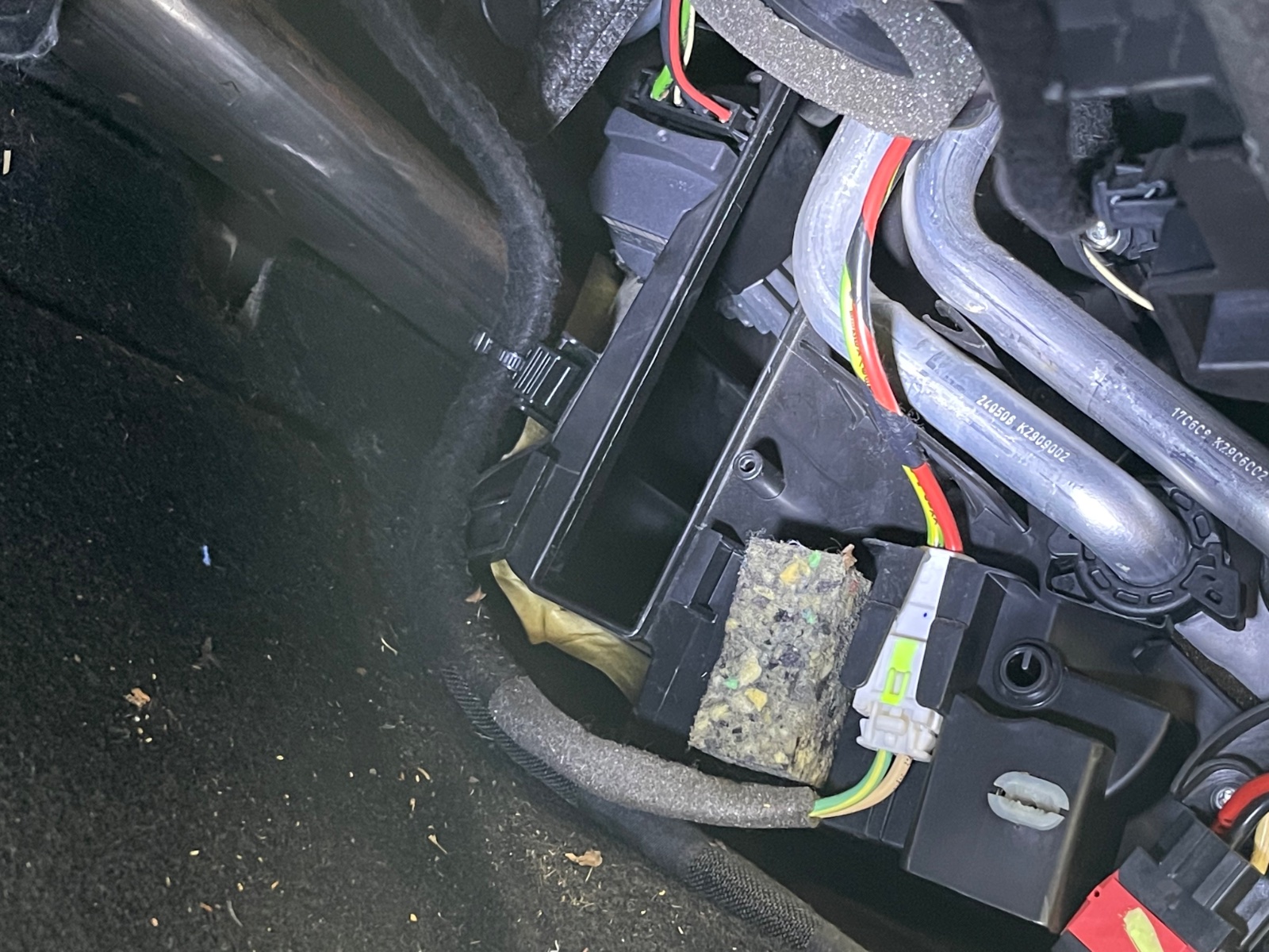

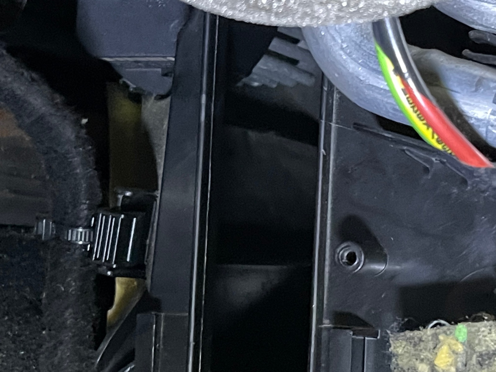

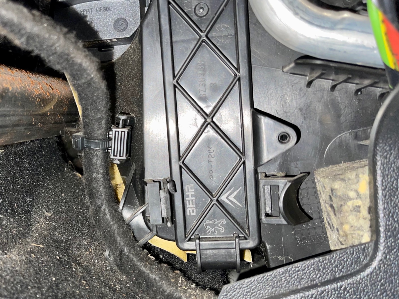

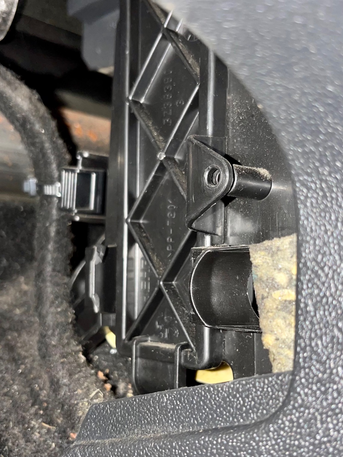

I took some photos when I changed mine a few weeks ago…hope these help:
When you're putting the new filter in, you might find you can make more space by twisting off the pipe that directs air into the footwell (it's up behind the glovebox, to the right of the footwell light). EDIT: You can actually see the grey foam on the end of the pipe in the third and fourth photos above
Also, get a pound shop feather duster to sweep the crap out of the filter box before fitting the new filter
