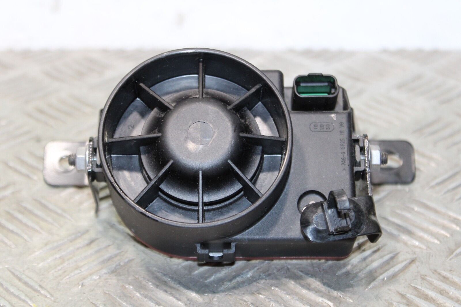

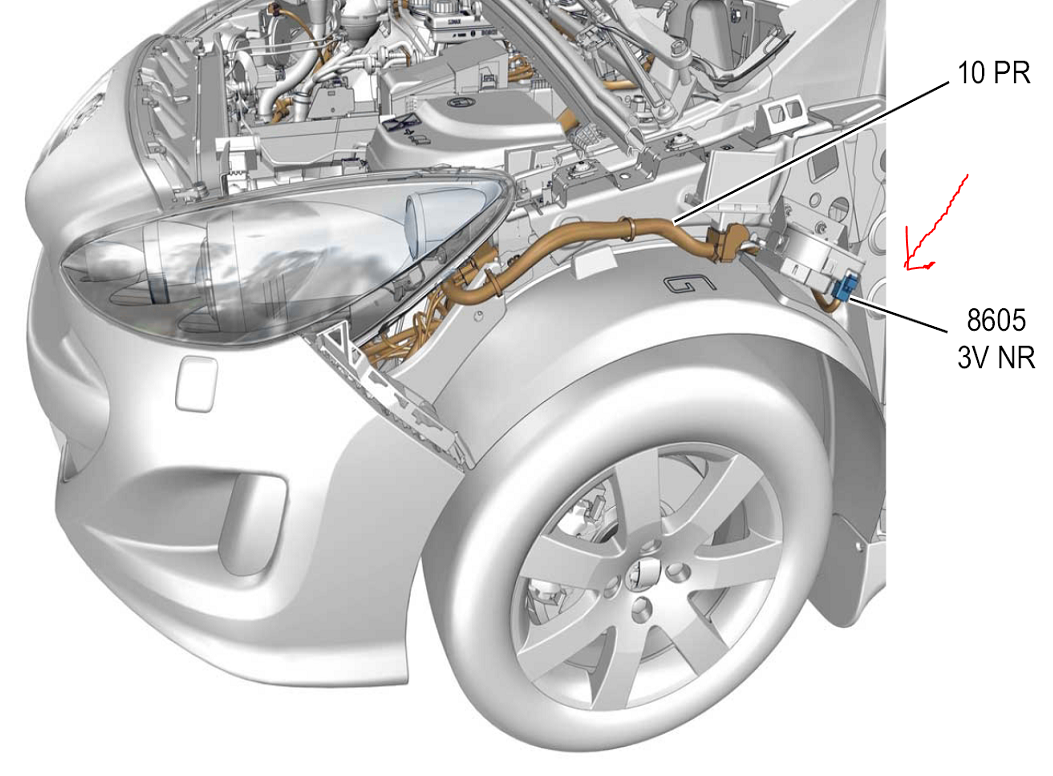

2. No faults with the alarm, but on looking at the Siren on Diagbox, it shows siren internal battery charge status as "battery discharged". So this maybe the problem.
So some guidance if possible:
- If it is nearly discharged, could it partially work (and sound) and not show up as a fault. Is this likely?
- Is the battery in the siren assembly itself?. I have the part number 9677756080 from Diagbox. There are plenty second hand on Ebay. I guess one from a newer car (fresher battery) should not give any compatibility issues?
- Do you know the siren location on a 308? From the noise, it is towards the rear on the drivers side. I will look further after the rain has stopped.

That will do it if the battery is discharged as it will be akin to disconnection of the supply (in the event of tampering with the supply from the main battery). The battery is internal - so it's a new module unless you have a fault in the supply wiring to the module preventing charging.
There is some confusion on the official docs regarding the location, as 8605, the 'anti theft alarm siren' is shown here under the wheel arch lining, but the siren is also shown in the second diagram at the rear at (5) ....

It's no5 in the second diagram for my SW. The sound was definitley, definitely rear, passenger side when I put my head in the wheel arch!! Also, I can just see the bottom of it above the wheel arch. I have ordered a 2nd hand siren and will fit when it arrives, but I was intrigued by your reply "The battery is internal - so it's a new module unless you have a fault in the supply wiring to the module preventing charging". Does this mean that it does gets recharged by the car's electrical supply or is it that it discharges faster if there is no supply. I'm mainly asking as for my ownership there has been no issues for alarm (up to now) and so should I be looking for a wiring / fusing fault as well?

Hi Tom, yes that's correct.
The siren carries out diagnostics on its connection with the alarm unit and on its permanent supply. If the siren detects a malfunction, the siren is triggered.
Item (2) Siren, Part: 9677756080, £141.13 inc. VAT
- The siren has its own power source consisting of accumulators.
- Charging of the siren battery is only permitted when the status of the vehicle’s electrical system is other than "Off".
- If the siren supply is lost, the siren uses its power reserves and is triggered.
- The siren is able to carry out 10 triggering cycles of 30 seconds when it is disconnected from its electrical supply.

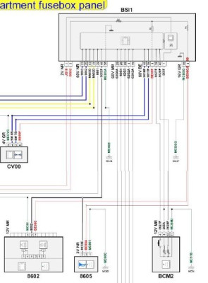

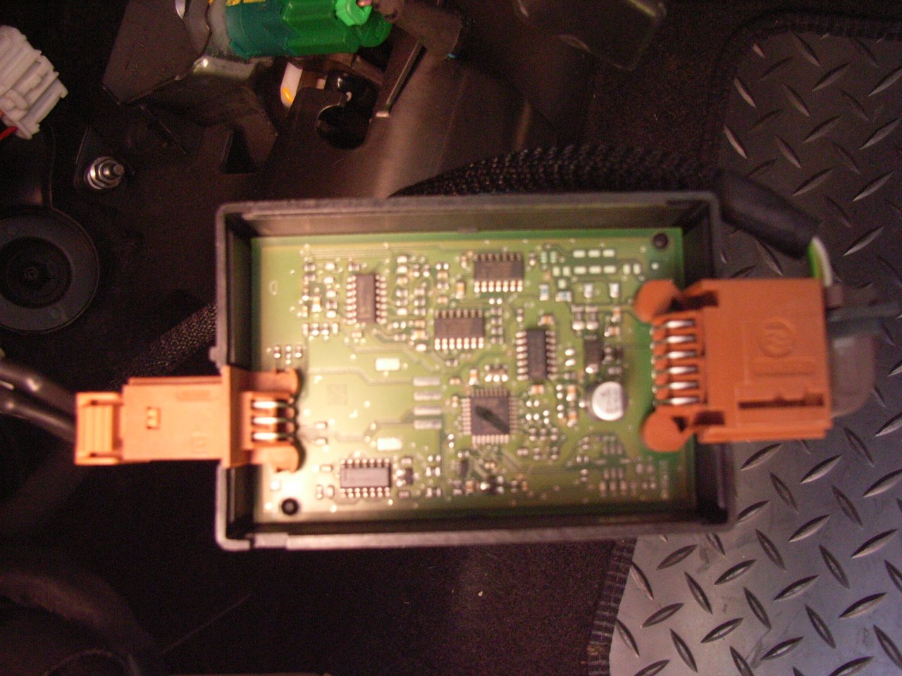

I've now started the wiring fault finding and have located the alarm module (9673523380) behind the glove box and above the fuses.
Having removed its plastic lid (it is just clipped on), I measure +8.6V dc between pins 2 to 3 with the ignition on. I believe that this is the siren supply, but seems to be a strange voltage. Pin 3 is green/yellow, 2 is white and 7 (signal) is grey.
By Googling, I found this wiring diagram: So it does seem to be the supply. Does anybody know if this is the correct voltage and if not, which component is likely to be at fault?
I can't replace the alarm module as I don't have a spare yet, so will move on to the siren as I do have a replacement unit now.

Quick update: There is 12V between pins 2 to 3 when the ignition is off, with the car unlocked???

That doesn't look at all like the wiring diagram for the vehicle Tom. I'll see if I have something more accurate shortly.

8602 : interior protection unit (anti-theft alarm)
8605 : anti-theft alarm siren /

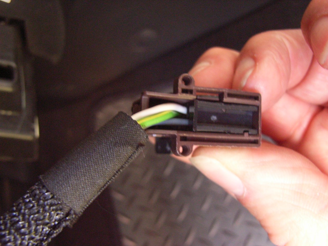

Thanks for the diagram, but on my car I only have 3 wires connected to the main plug on 8602 (plus the two pairs for the sensors on the second plug). So the diagram above is not right for my car.
- x 6957
Re: 2015 C4 Picasso alarm/BSI problem
My Bad, Tom, I was looking at the earlier 308 and not the 308 (T9) that was in a different location, apologies. I have re-posted the diagrams replacing with the correct ones for your T9.

I've now managed to get access to the siren - rusty bolts again. So what is the correct replacement sequence - I would prefer not to set off the siren as it still works!
Should it be done with the car battery disconnected / Do I just unplug the old siren and plug-in the new one (it appears to still have 12V) / does it need any programming or resets in Diagbox.
Also when I have reconnected the battery after isolating for accessing the area around the fuse box, I now have two additional faults - "Lack of coherence between the vehicle locking status and the locking status of the front right door lock" and also for the front right door.
