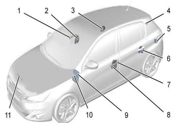

That will do it if the battery is discharged as it will be akin to disconnection of the supply (in the event of tampering with the supply from the main battery). The battery is internal - so it's a new module unless you have a fault in the supply wiring to the module preventing charging.
There is some confusion on the official docs regarding the location, as 8605, the 'anti theft alarm siren' is shown here under the wheel arch lining, but the siren is also shown in the second diagram at the rear at (5) ....
(1) Front right-hand door exterior opening control.
(2) Right front door lock.
(3) Right rear door lock.
(4) Tailgate lock.
(5) Alarm siren.
(6) Left rear door lock.
(7) Front left-hand door exterior opening control.
(8) Front left hand door lock.
(9) Built-in systems interface.
(10) Antitheft alarm volumetric unit.
(11) Anti-theft alarm bonnet switch.
I've PM's you about parts.

It's no5 in the second diagram for my SW. The sound was definitley, definitely rear, passenger side when I put my head in the wheel arch!! Also, I can just see the bottom of it above the wheel arch. I have ordered a 2nd hand siren and will fit when it arrives, but I was intrigued by your reply "The battery is internal - so it's a new module unless you have a fault in the supply wiring to the module preventing charging". Does this mean that it does gets recharged by the car's electrical supply or is it that it discharges faster if there is no supply. I'm mainly asking as for my ownership there has been no issues for alarm (up to now) and so should I be looking for a wiring / fusing fault as well?
