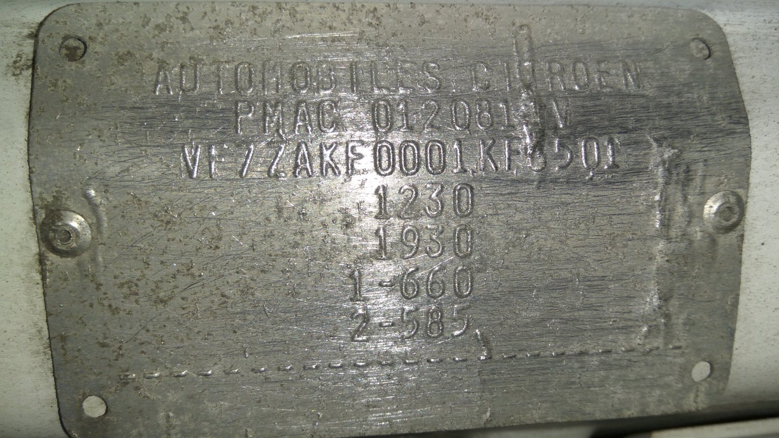

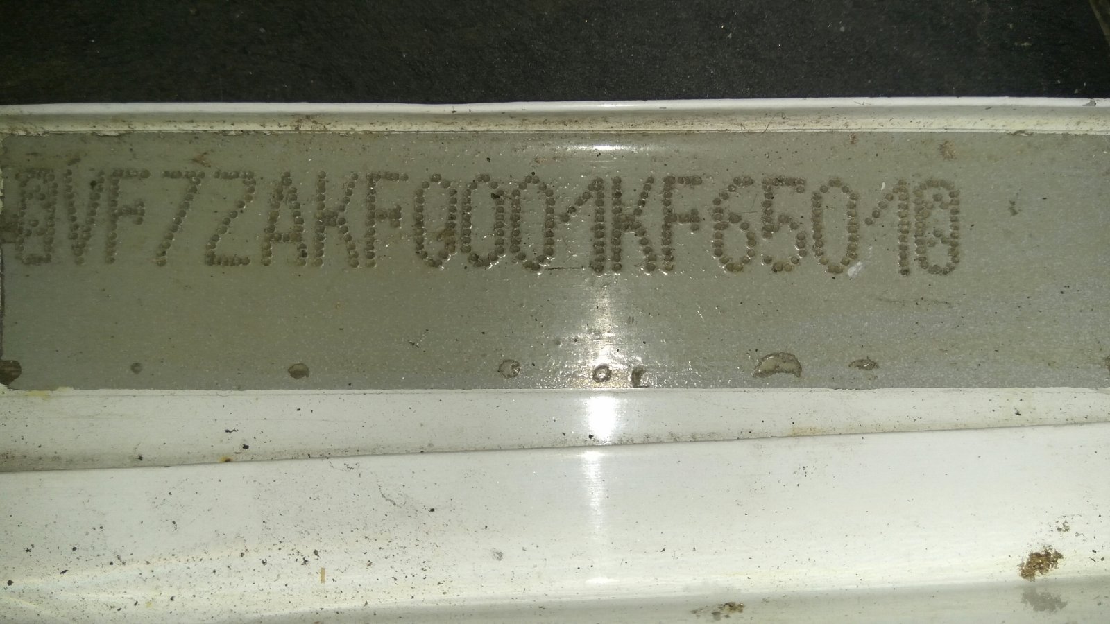

I am not sure which to look for? See my pictures.
x 6945
Re: Paint code?? I can't find it
Your paint code is:
EWP - BANQUISE WHITE PAINT

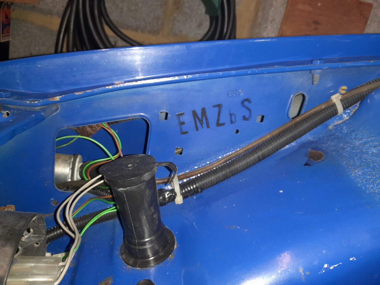

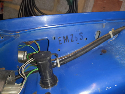

On an S1 AX you'll find it stencilled on the RH inner wing between the strut tower and the washer reservoir filler neck..
Here's mine:
On later cars, it can be partially obscured by the engine ECU...
