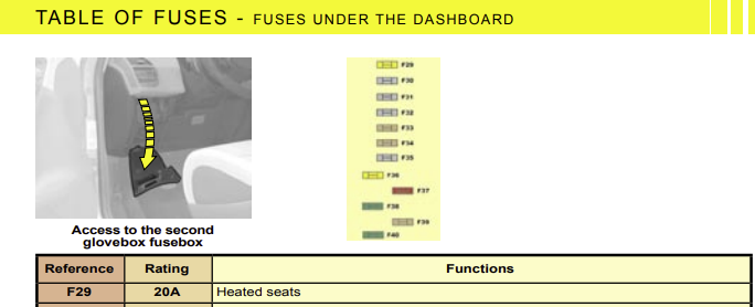

The fuse for the heated seats is fuse F29. It is in the passenger compartment in a block of fuses from F29 to F40. It's a 20A fuse. That's the one to remove until you can get it looked at.nicolla wrote: 01 Aug 2022, 19:49 Ok, so I'm having a weird feeling that my seat heating is working all the time, even though the 'button' is set on 0.

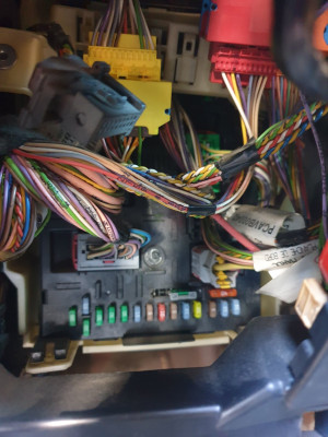

Honestly I'm not sure how to find the fuse you are talking about. There are some but I'm just not sure
This is the pic of the box

It's here to the left:
I've circled it in Blue.

You are THE BEAST Marc, I really appreciate your comment. And sorry for the link, will make surento use the feature in the future.
