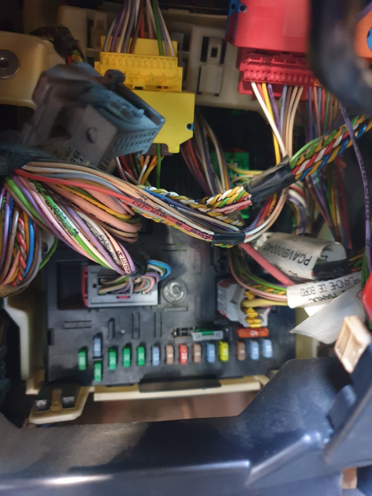

Honestly I'm not sure how to find the fuse you are talking about. There are some but I'm just not sure
This is the pic of the box

It's here to the left:
I've circled it in Blue.

You are THE BEAST Marc, I really appreciate your comment. And sorry for the link, will make surento use the feature in the future.
